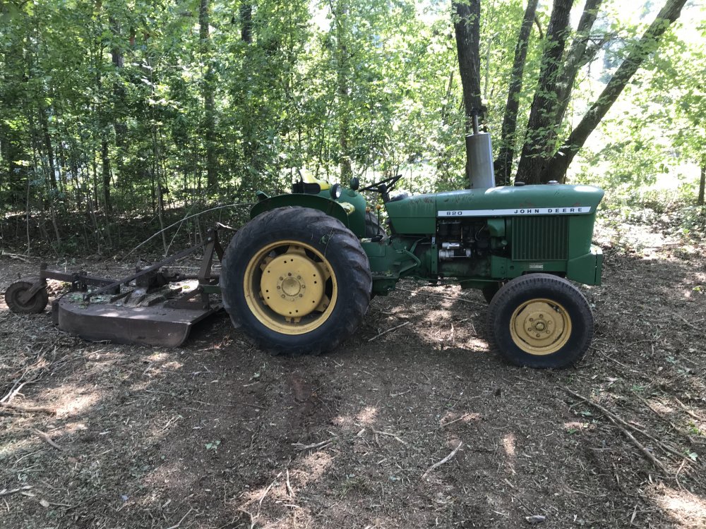

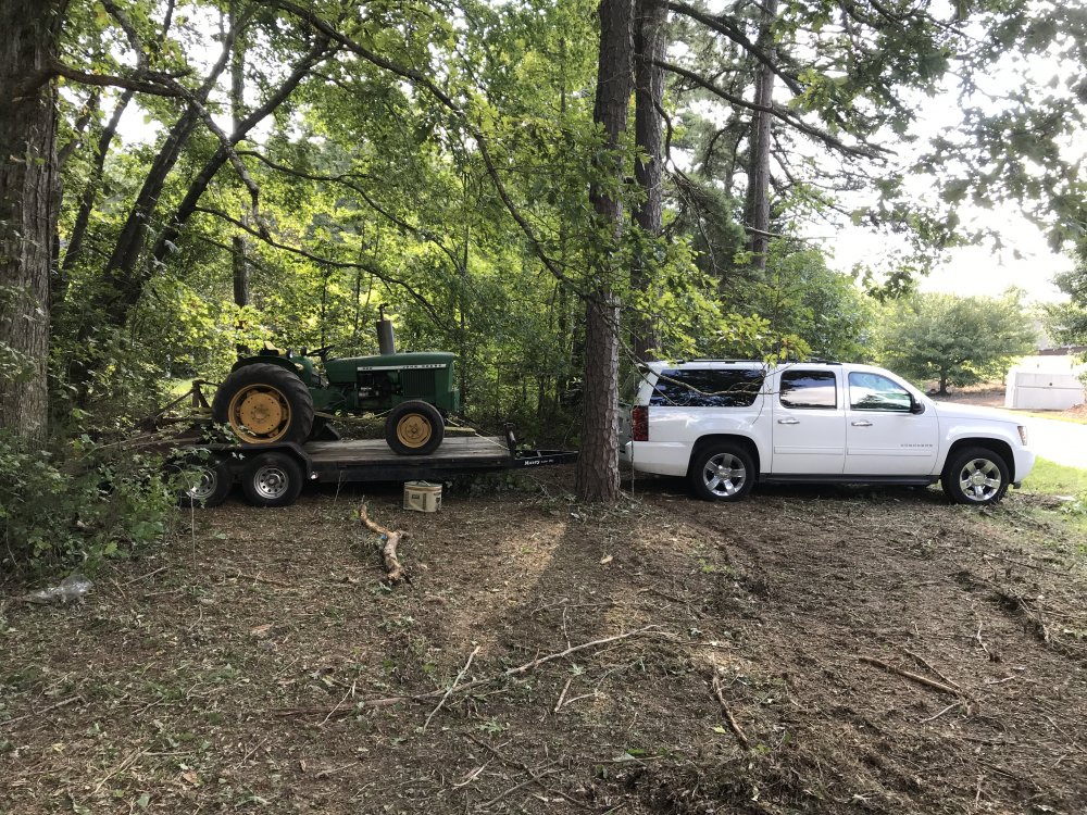

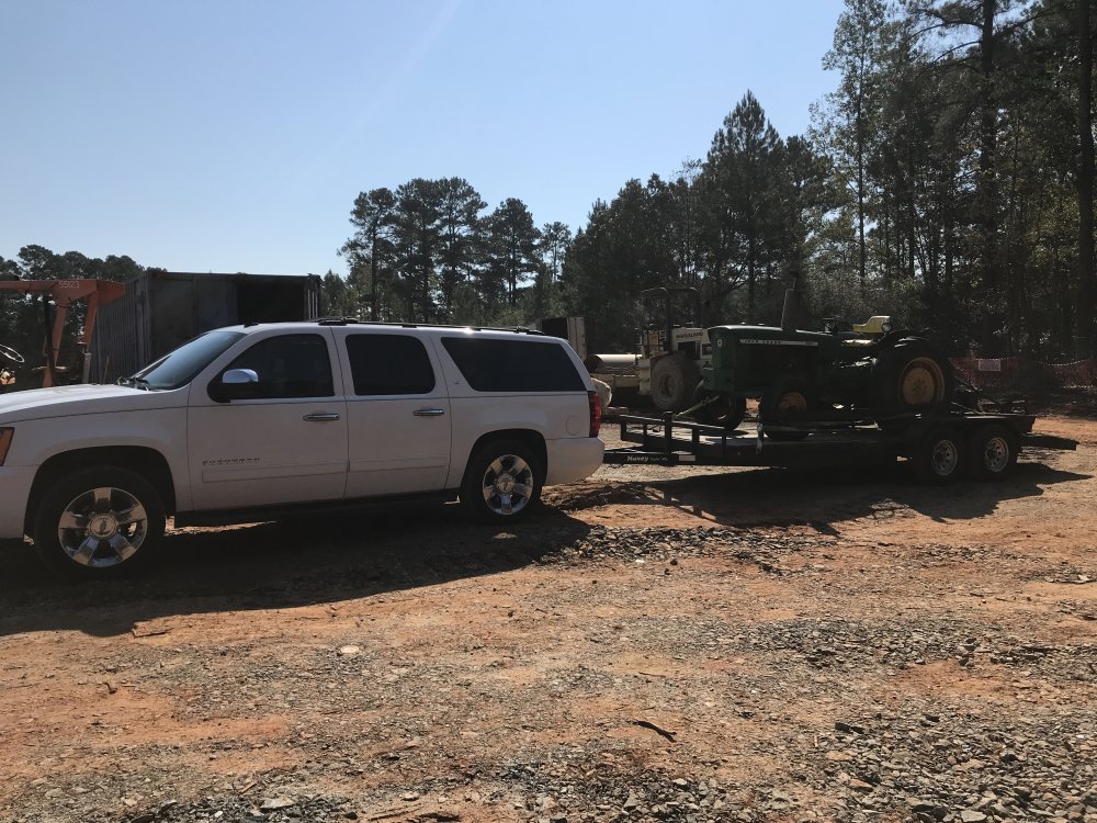

Look at that Burb towing a tractor right above this post. That's probably more than you'll be pulling, and that one does fine, especially for "once or twice a year".

I agree with you in premise, but...A deere 820 is a 2 ton tractor OP wants to pull 7k. Almost double.
But Id pull it with a half ton with a WD hitch, (might add air bags) and good trailer brakes.
