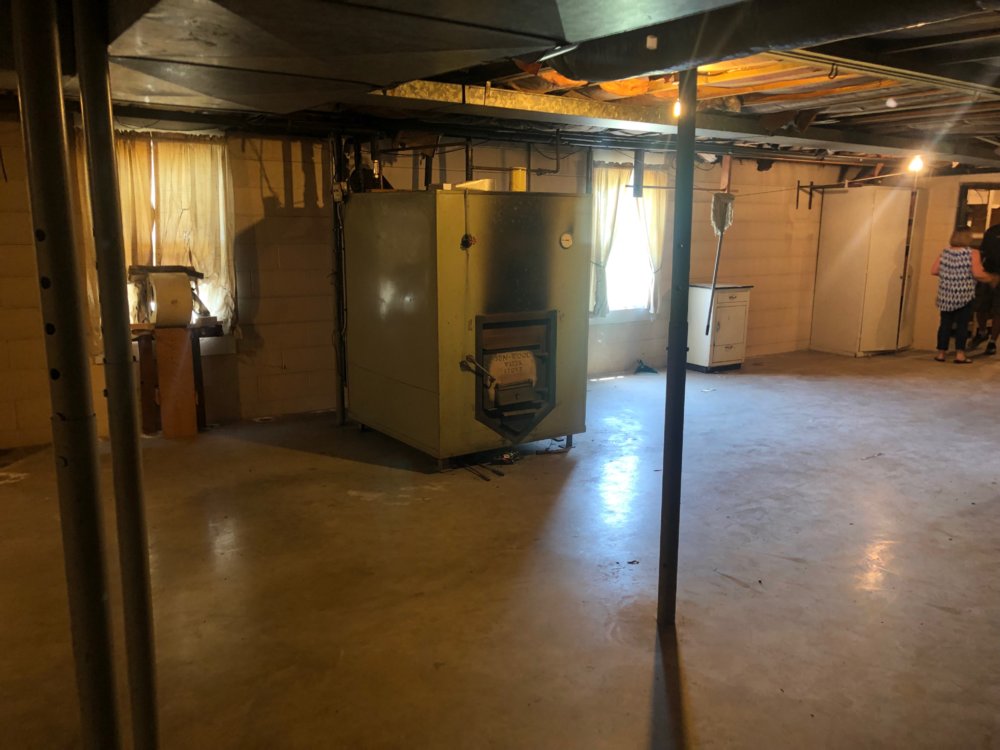

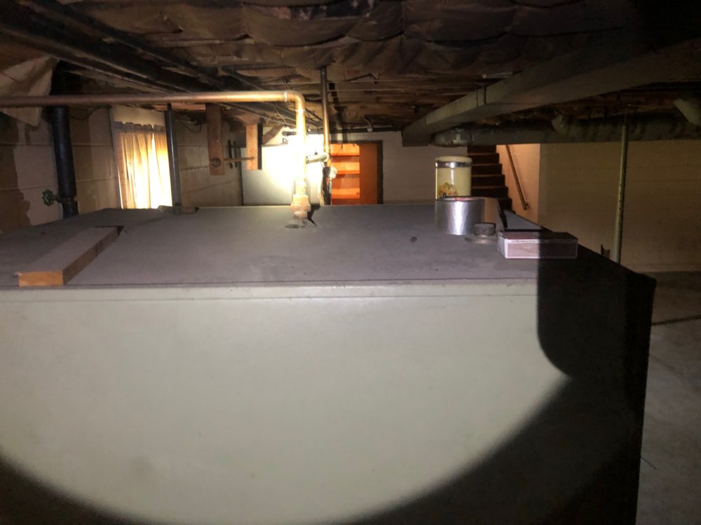

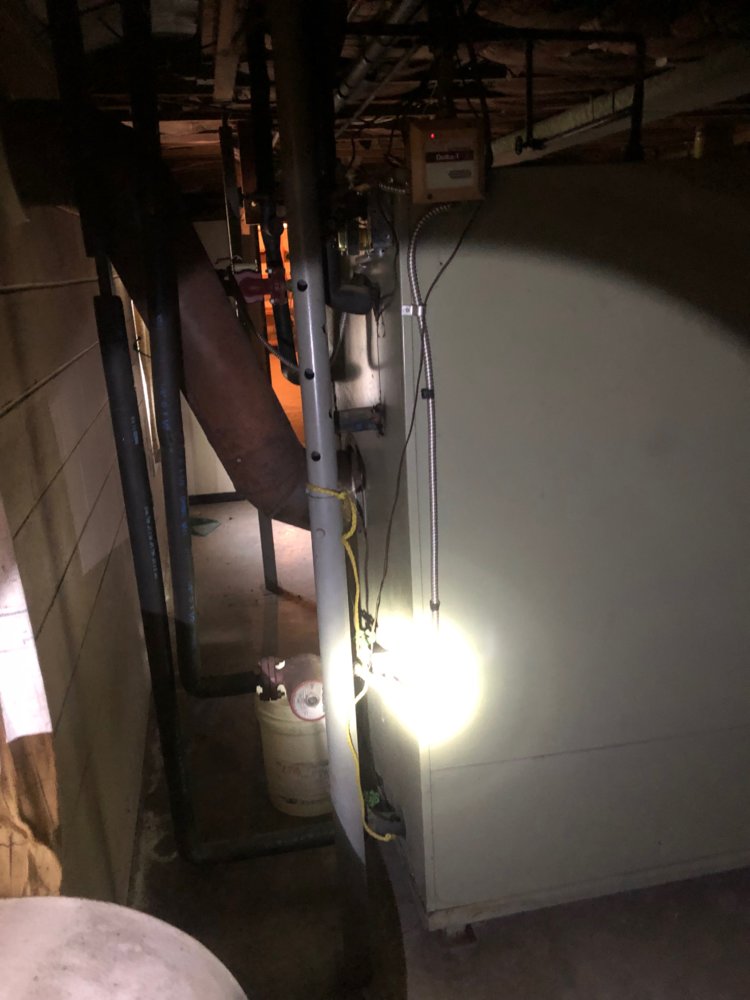

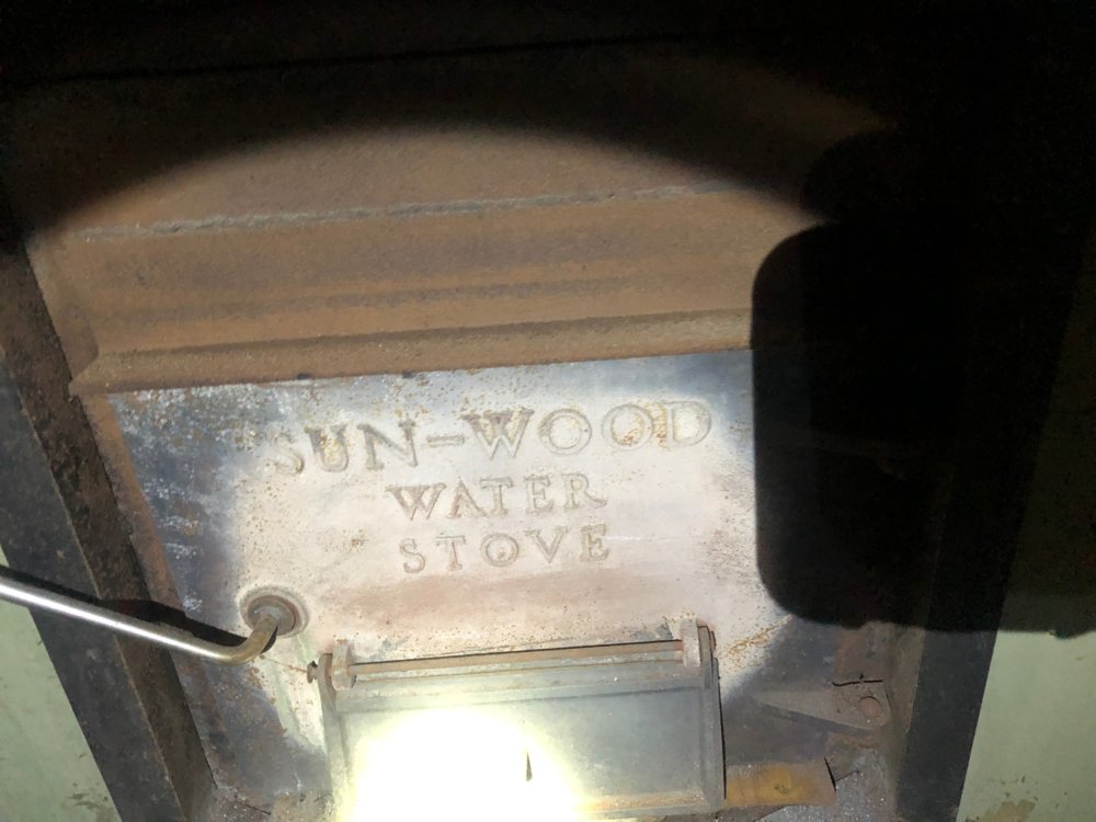

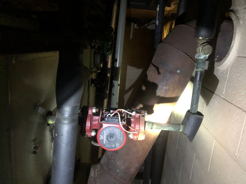

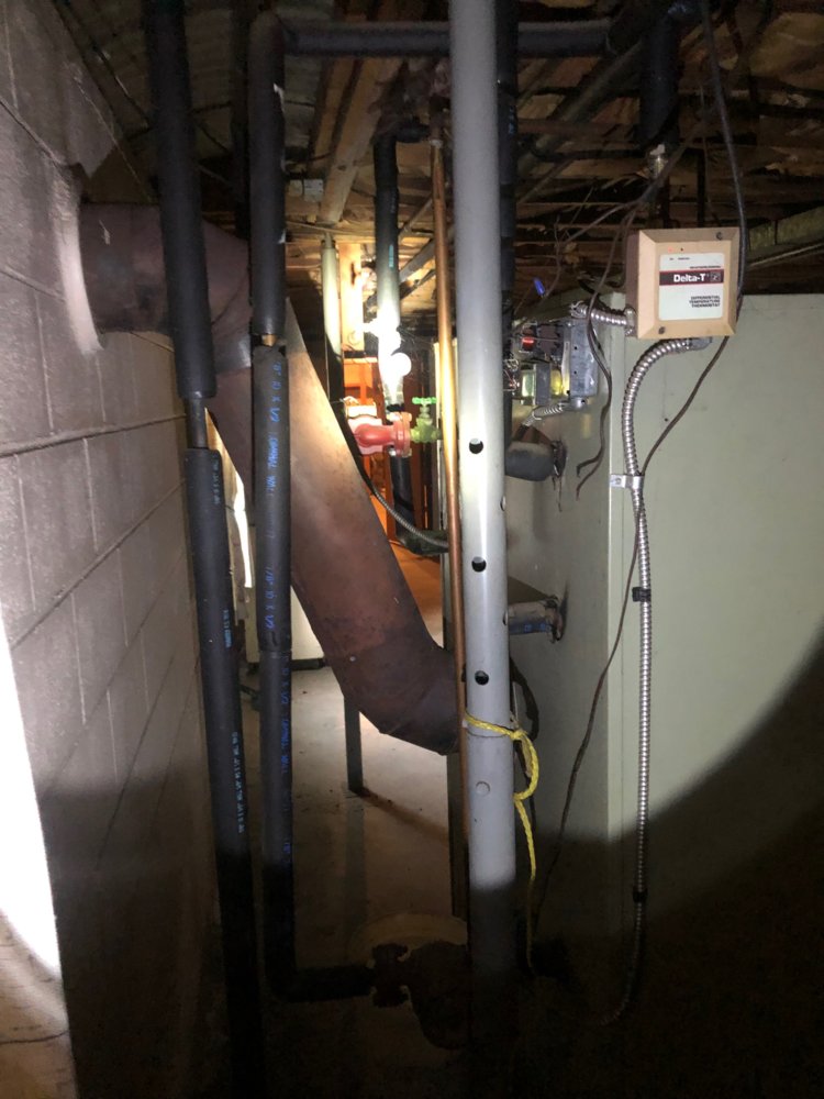

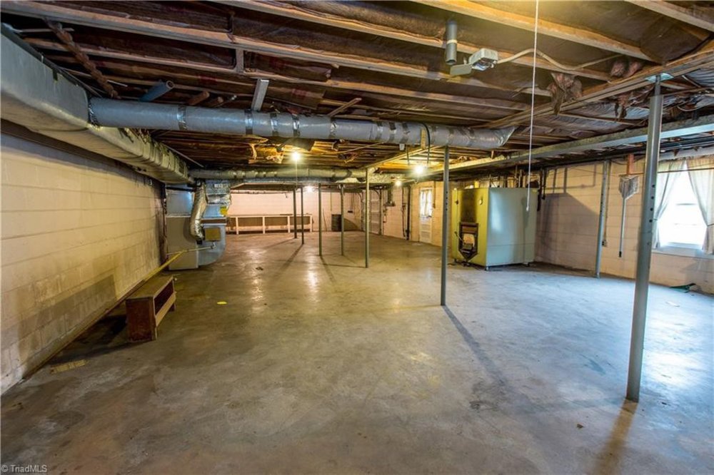

Ok, some more pictures and interesting things to get your thoughts on!! So this house had solar panels on the roof that were for heating water! Pipes going up there, and then coming down into this HUGE Solar / WOOD water heater thingamabob in the basement! Solar panels are long gone, but giant wood heater remains. I will post up a few pictures here, would love to know just a bit more about it, but 99% sure this is going to go away!!
The house also has an electric water heater...AND oddly enough, there is water pipes going from the solar/wood burning stove device TO/from the gas heating system?! (Lennox Elite something or other) So we are still figuring this all out but in theory you can (could) heat water via solar, via burning wood in this stove, possibly via "gas" heat system AND via electric water heater!?
Long term...we have gas in the house already, will either replace electric water heater with gas (and 'huge' in size for capacity) OR... install one of those endless hot water dealios. I remember reading a few threads about them a while back, lots of back and forth on which is the best but hopefully not in my immediate future anyway?
Enjoy the pics, looking forward to the comments AND...if YOU are interested in acquiring a massive solar/wood burning stove heater thingamabob this COULD be your lucky day! Send me a message, let's work a deal, and part of that will be helping eliminate / reduce and simplify/fix the water heating all over as this stuff gets yanked!!
if you google "sun-wood water stove" there is ONE other person here in NC asking about theirs in 2014! Apparently this was more of a local solution / alternative to the more popular Taylor Water stoves! As you said when I look them up, they mostly appear to be installed OUTSIDE!? Based on their post / dimensions, 6 foot tall, 4 foot wide and 6 foot long, holds approx 500 GALLONs of water to be heated!
Just in talking with the neighbors, he was very pleased with his setup and would "burn anything" given to him, keeping his costs low. But I really don't like the look of the soot on the front of that and on the insulation above this area, just cannot imagine this is a really 'clean' solution.
Might be worth a fortune in scrap metal (copper?) alone, saw a similar sized unit showing shipping weight of 2600 pounds!!?

Nice looking place! Some of my family use a wood water heater for whole house heat. I would love to convert our house to it, but dont have the money.
Yeah the HVAC guy said the pipes that run from water / stove over to gas furnace essentially allows you to heat home with wood as alternative. Gas was then 'backup' if heat from stove was not enough, but we have pulled that out, not planning on using at this point. Just too 'dirty' based on the soot you can see down there, I might be a bit insane to remove this option but also don't trust it much.
Ok a few updates, Water/Sun stove thingamabob is GONE! Friend of a friend has one like it, got this for a different friend and more importantly disconnected it all nicely and moved away on rollback! Ended up replacing ALL the windows in the house as several the panes were failing/slipping inside the frame so nearly useless. New roof, new fasica (all pvc now), gutters and something I wanted to get a bit of info on!

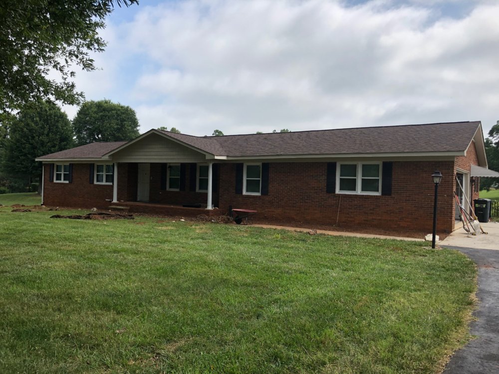

Couple pictures of porch area, replacing those white / round columns with oak beams (local cut / timber guy I am planning to ask) going for a CRAFTSMAN look on the house.

I'm far from an expert of installing stone, but we have it on our house, and on the chimney of my shed that I built (I didn't do the stone work). If you are installing stone veneer on wood, then you have to install two layers of the thick black felt paper, then metal lathe stuff with a nail every 6 inches. A coat of mortar is then put down and let dry. Then you come back and actually put the stones on. For columns, it probably makes more sense to just build up a block column, then put the stones on the column instead of starting with wood.

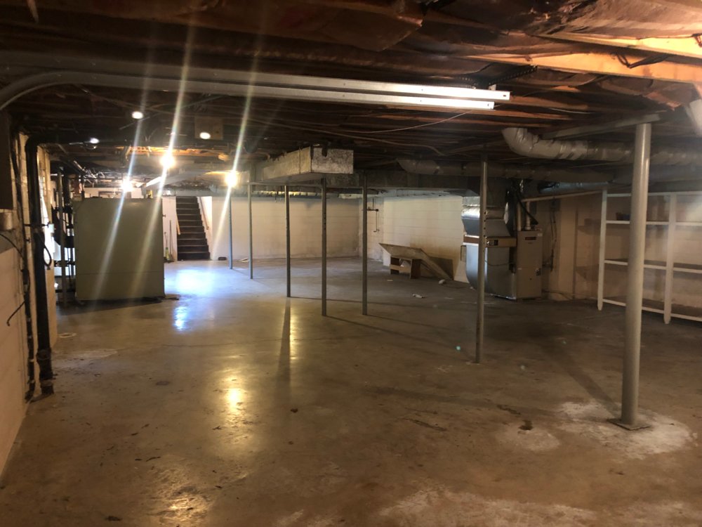

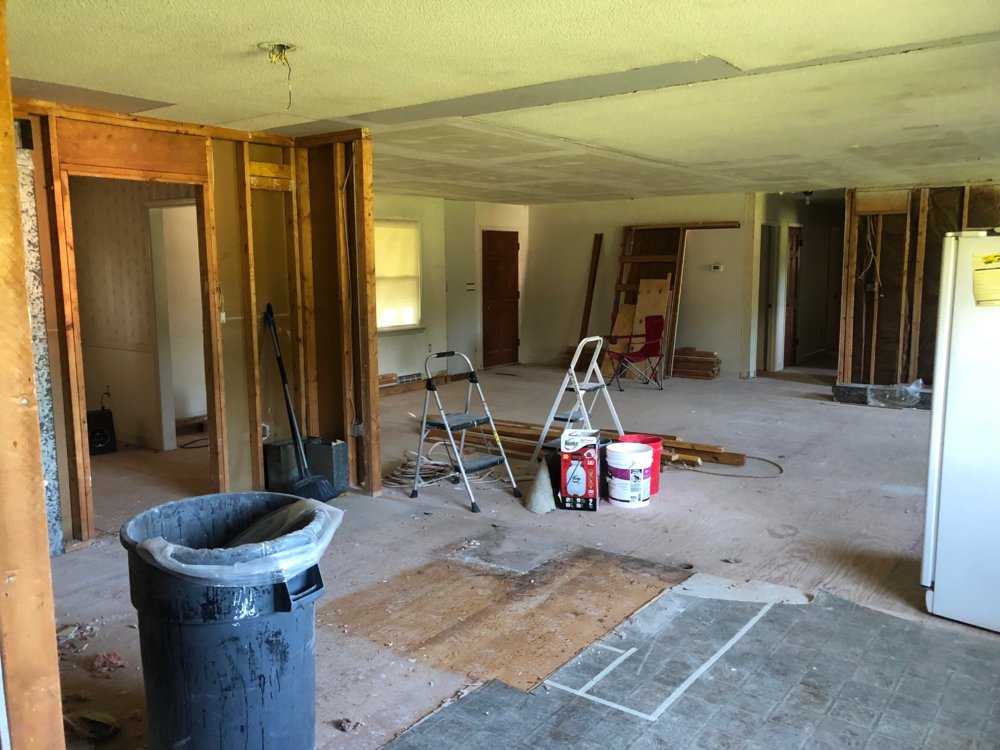

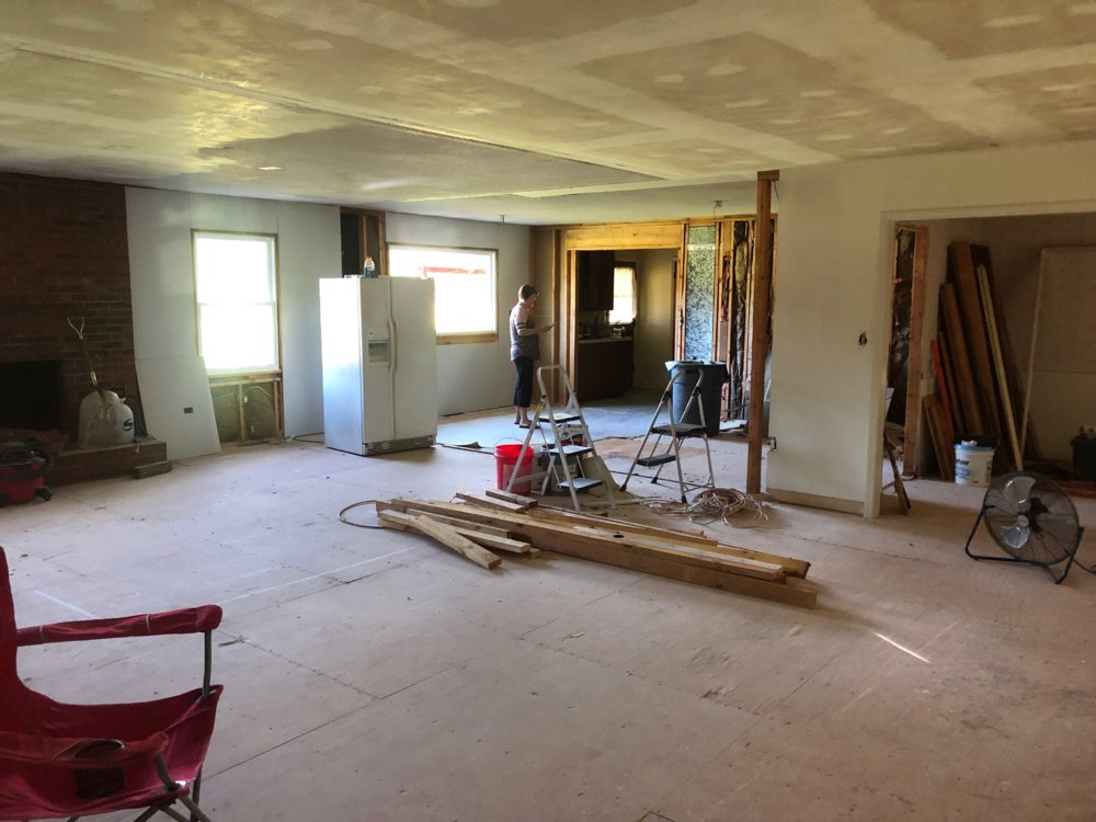

Couple more pics of that room once we opened it all up, it is now in drywall but came out nice. Room is now 33' x 29' approx from kitchen to far wall and front to back.

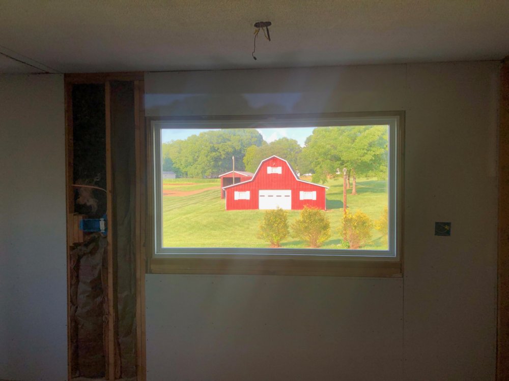

Plus we did a "picture window" in kitchen overlooking back yard and the barn, one of my favorite upgrades by far, LOVE that view!

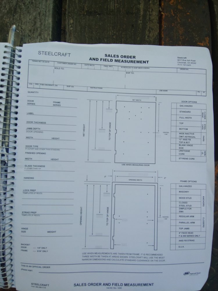

The exterior door in the basement is 32x78, has windows in it and would like to replace it with Steel door. The frame around it is already steel / and well embedded into the brick around it, so not wanting to mess with that, just get a replacement door. Any local sources you can suggest for doors?
Your best bet is to find the original manufacturer, if they are still around as most have their own unique hinge pattern. That is my experience with commercial steel doors. Unless you can get a custom one fabricated to match the hinge locations.
You can get a metal door to fit but most likely it’s gonna be speedy because it will be a custom made steel door.
I’d suggest finding a fiberglass door slab that’s hasn’t been altered yet and set everything up yourself.
“Most fiberglass doors will have some amount of adjustment on size that you can trim it down some.
Beeson hardware in High Point will have what you need. Call them and they will tell you what measurements they need. More than likely they have a slab in stock, if not it takes a few days to get the slab in. Only takes them a few minutes to cut and tap the hinges and drill for the handle.
Found a order form in my notebook. This may help you with the measurements.
