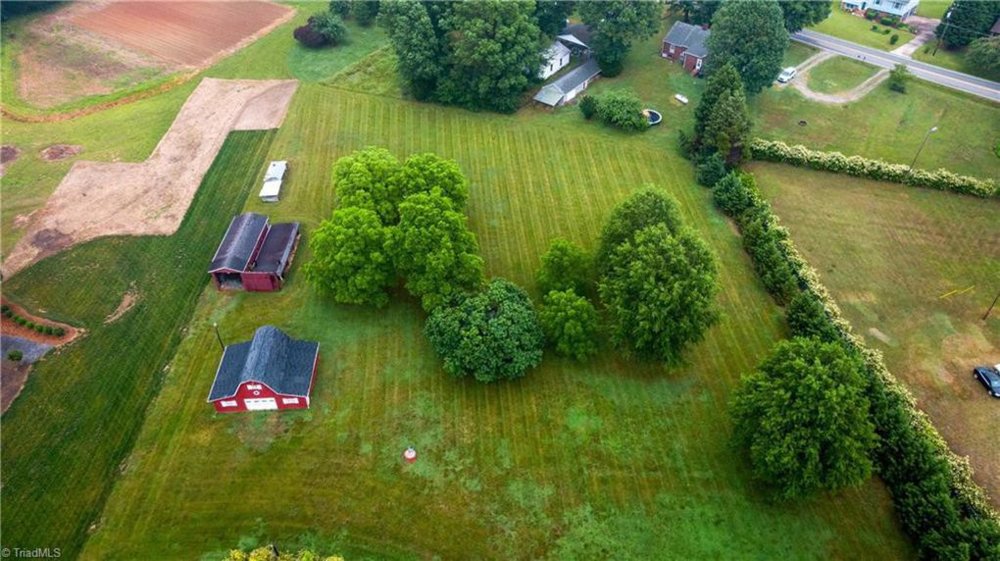

Nice. In for any and all basement work info...... Where is the house on the areal shot?
Just below the frame of the picture, bottom left!

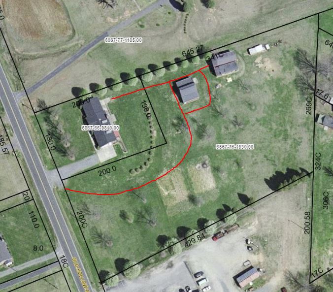

You can see here the whole property and in RED the approx line where I would like to do the driveway out to shops and back to house/basement entrance!

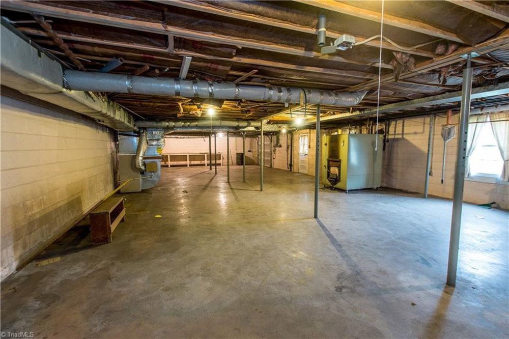

So, full basement garage?
How high is the basement from slab to joist?
I *loved* havin ga basement garage when we lived in Lewisville. Was super convenient during the winter. Not so great for my wife, when she was in the bedroom just above me and I was pounding away w/ tools at midnight, lol.

I’d build the driveway to the shops from your existing driveway. That way you are building and paying for less driveway by utilizing what already exists.
Where is the septic? Where is repair area? That will affect drive location to the shops.
The cheapest option for a driveway is fabric and some cheap version of crushed aggregate. You can get recycled concrete reasonably cheap but it can have metal in it you’ll have to deal with. Another option is asphalt millings. It’s recycled asphalt which is installed in lifts and bonded with tar. It’s cheaper than asphalt and concrete but is a little more than crushed stone. Depends on budget and the look you want.
But, whatever you do, if you put crushed aggregate down, always blade the soft topsoil off and add some decent fabric before laying down stone; it will keep the driveway stabilized longer and will help to keep the weeds out.

Basement is not wet to the touch, but flaking off all the paint and NEEDS a dehumidifier for sure, bit of wet smell. I will buy (advice?) a big dehumidifier SOON that has the drain (or pump/drain) where I can run it outside and leave it running all the time. My current house / basement went from 80+% humidity to a nice constant 45-50% with my current dehumidifier so pretty happy there (1600sf basement, this new house is 1800sf)
LONGER term thinking...I really want to close off and make the basement mostly "man cave" with window unit heater / HVAC system, needs to be good enough when I am done that I can put my acoustic guitars in there without worries of any damage!
There is also a distinct chance this basement, say 900-1200sf or more out of 1800sf could end up as a "live in" apt for my mom or my wifes dad or mom someday. We are at that age in life and that is in my mind right now that I may have to put in shower / toilet, sink, and small kitchen etc so they have their own space. Mom had to come live with us for about a week and just thinking at some point this could become SHORT term project instead of long term... This is one of the great parts of the house is this gives me that choice in life, would have their own garage door entrance and their own space as needed.
Septic is unknown, county does NOT have record of it, there is TWO pipes going into floor, calling septic folks to come out and look / pump out / give me a report soon. Not sure if 2 tanks, or they come out and meet in a single tank / field. But assumtion is that it will be immediately in the flat area right behind the house, which slopes down to water shed area (soil/conservation planned in 1972!) May know more soon.
Call @Riddle for your septic needs. You'll get treated right and meet a great guy in the process.
Call the county to do an inspection. I had 2 different private companies not be able to locate the tank, d box, or lines. The county came out and in 30 minutes had everything found and marked. Yay for gov help! :lol:

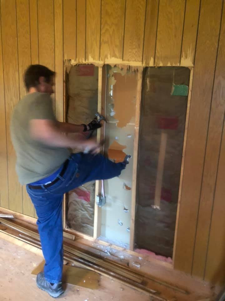

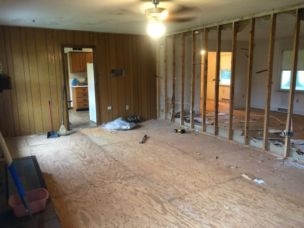

I'm sure you got an engineers stamp and a county permit before doing that, of course....
I'm guessing you bought from the original owners?

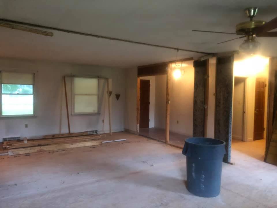

It was reviewed actually by a buddy that is a structural engineer. He gave me his blessing before any walls came down, will upload pic of the trusses but outside walls have the load, nothing internal on the home, the center of the house where that wall was is just below the center of this picture where the 'walkway' is on the trusses, so no 'weight' at all in center, might have been a bit more question if they were directly under the V part on each side.
As we are doing the work ourselves, the permitting process is generally not needed, bit of a gray area, but not in city, etc. Sheetrock, new floor, paint, new cabinets in kitchen, etc. My electrician will pull permits when he does that part, wires up the hot tub, etc.

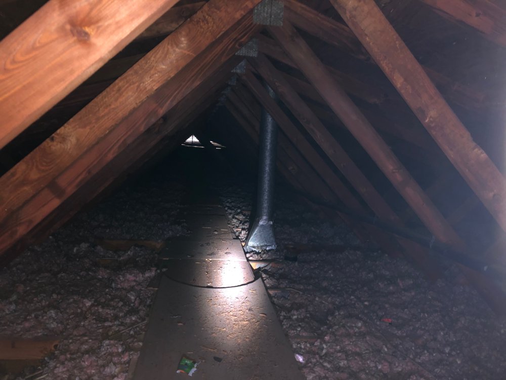

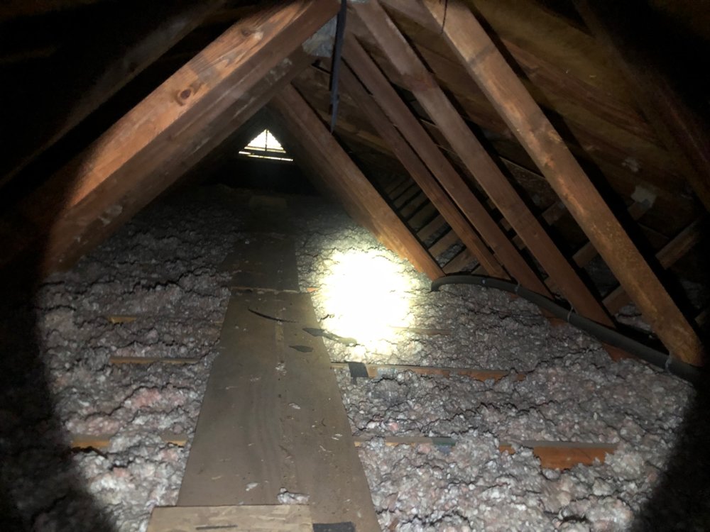

Hey, on that second picture especially, tell me your thoughts folks on INSULATION? Looks good, needs more after 40+ years?

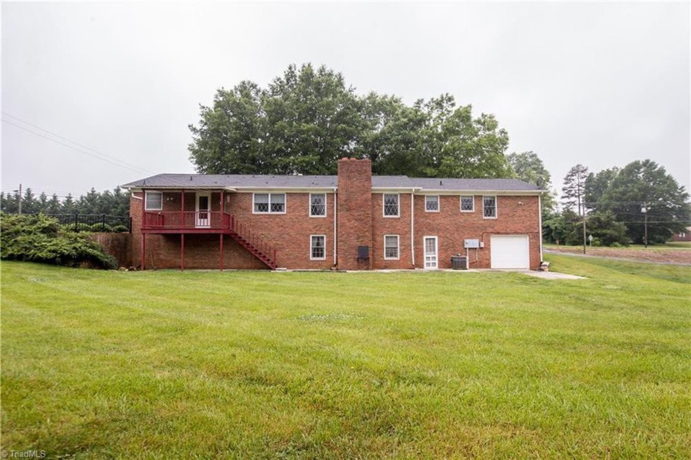

Drove by this afternoon and saw you are getting a new roof. Standing seam would have looked good on it.
For the house, just wanted traditional architectural shingles, had some issues with water inside, probably from old solar panel install. So put on a new roof over the whole thing to get water tight, then will do new gutters, fascia, etc instead of the wood, trying to get as low maint as I can.
Thinking long term of metal roof on the barns, the RV shop needs new roof and thinking pretty seriously of covering sides with Red metal "roofing" and then top with charcoal colored metal roofing. That way hopefully no painting in the future on that building and when time comes on the 'barn' will have to see what makes sense. I prefer the looking of the wood on it for sides, but might do metal roof then.
Why? That’s an interior wall on a non-vaulted ceiling ranch house. I’m 99% sure the only load bearing walls are the exterior walls.
You're right in this case, but the roof could have been stick framed. We did something similar in our kitchen, and needed a double 14" lvl to pick up the load.
How deep is it? Looks like "not very"... Should be about 15-16" overall by code.
