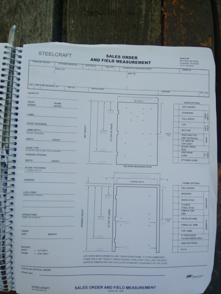

i fill those out and give to one of our damn door suppliers and he will still screw it up.

The exterior door in the basement is 32x78, has windows in it and would like to replace it with Steel door. The frame around it is already steel / and well embedded into the brick around it, so not wanting to mess with that, just get a replacement door. Any local sources you can suggest for doors?

As stated by others, each door unit is different; hinge location and route, handle height, door bottom design, sweep margin, etc. Based on the measurements provided, you have a 6/8 (height) door unit with a 2/8 (width) sill. I know it sounds easy to just get a replacement panel, but it will not come cheap. Panel manufactures don't like to sell individual panels to the home owners so the mark up is unreal. The best bang for you buck will be to get measurements of the rough opening and then buy a cheap ($200ish) prehung unit from a box store. The other option would be to call BFS since they have a prehanging shop off Market St.
Edit* If you have any specific wants/needs in the door unit that you're unsure of, feel free to PM me and I can walk you through every aspect.
