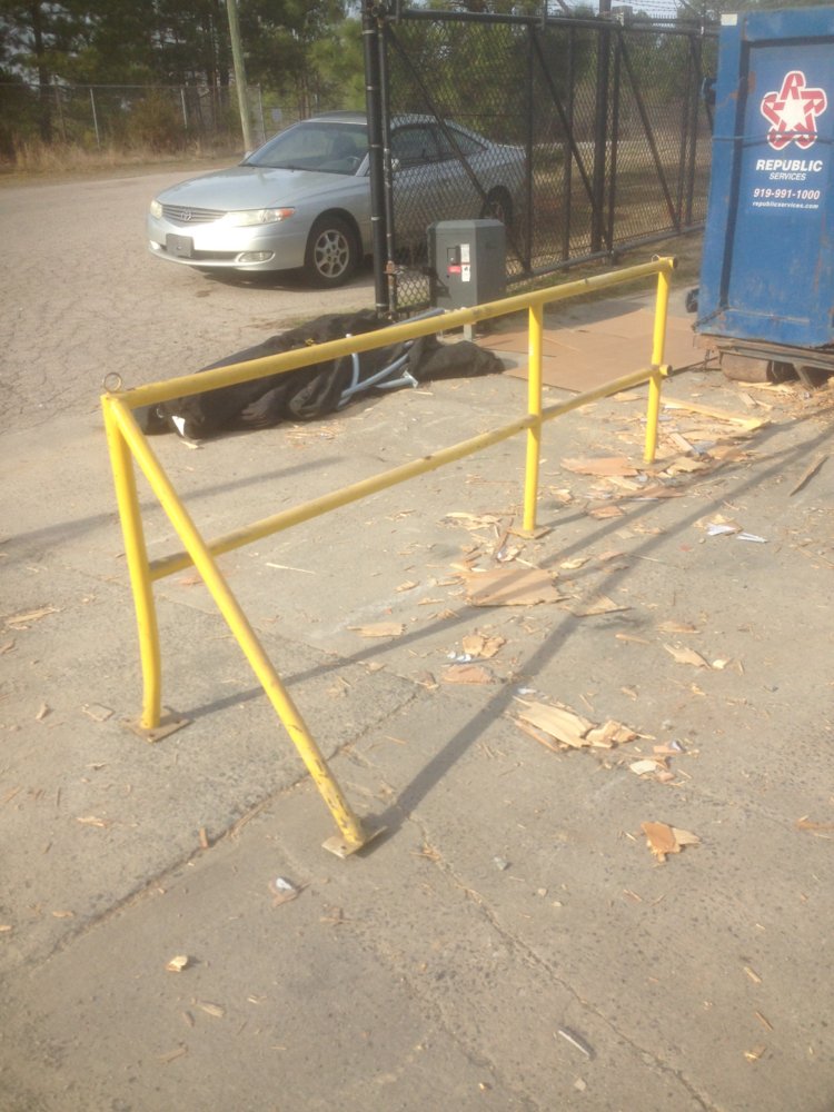

Been doing some demo and cleanup at the new building and came across this suhhhweeeeet specimen of roll cage potential. Decent wall thickness and hell, some even have base plates already mounted and has built in triangulation. Science of metals tells me that it's good to go!
Will trade for light bulbs and gutter ice.
