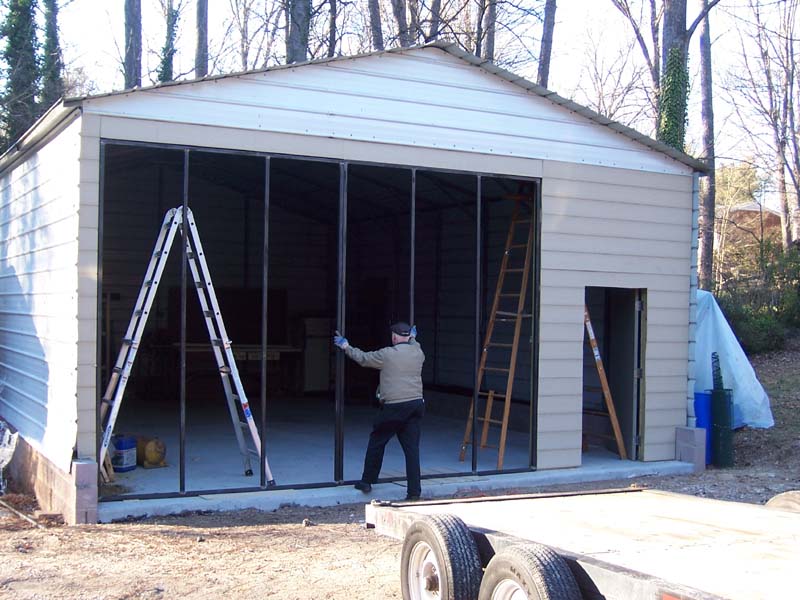

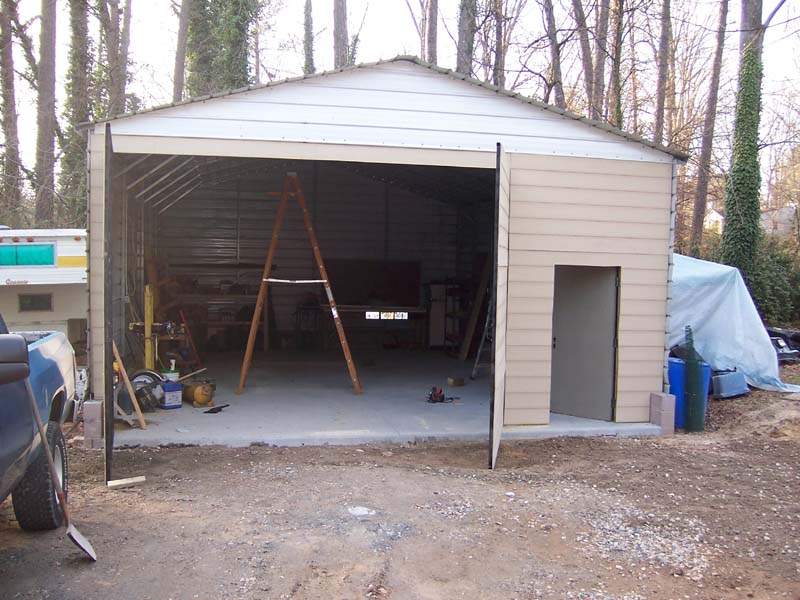

That is how the doors are on my shop, they are 10'x8'6", with a heavy 2x4 framing, plywood covering, and exterior wood siding to match the shop. Very simple design, could be made in an afternoon, of course they don't need to be quite that heavy, but it works. You could probably find some pre made barn doors to fit your opening though. Seals up decent enough, my shop is heated/AC.
Not the best picture, but you get the idea, one set of doors closed, you can kinda see the other set open.

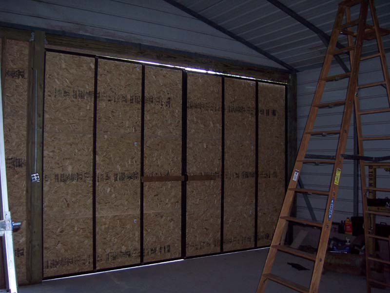

From inside, spring loaded "bolt" as a latch. Also a hasp/padlock down lower (not seen) for even more secure locking.
Thanks for the pics. I think I found some locks I feel more comfortable with as well. Looks like homebuilt it is.
holy crap Ken those must be heavy
Nope. Very light. The steel was 1.5"x 1.5" very thin wall and with skins on 2 of us lifted them up and attached them with no issues at all.
I guess I've just had .120 wall so engrained in my head it's automatically what I assume lol
