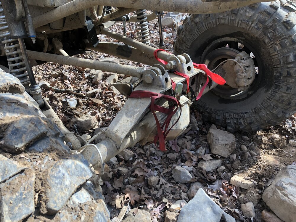

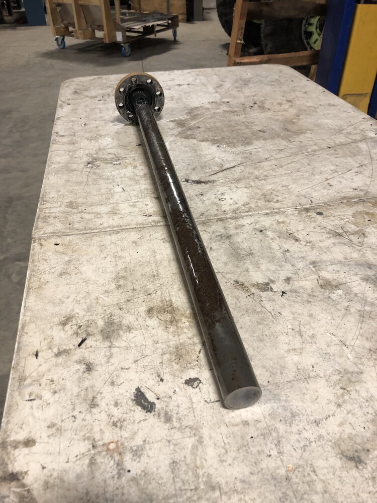

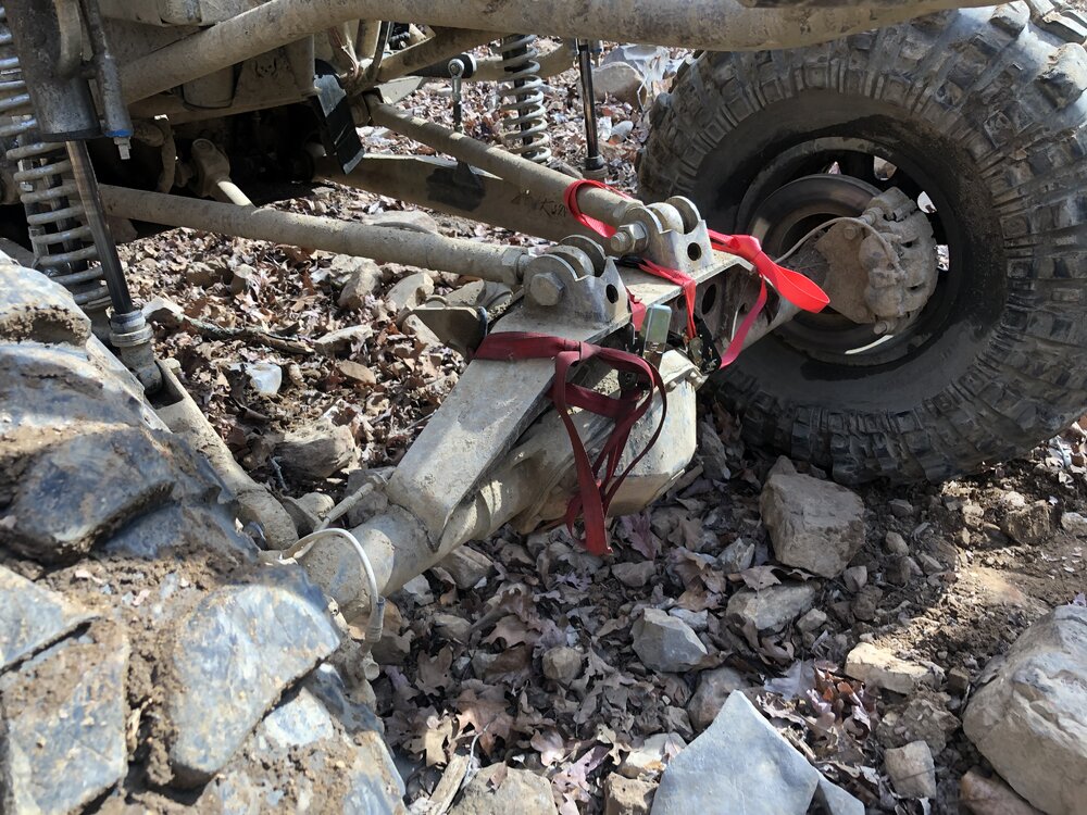

We covered some ground until I broke a 300M 14 bolt shaft on Stairway to Hell.
Before anyone freaks out, they were oooooold. Like 15 or so years and were in the axle when to bought it. I guess the ol’ 5.3 gave them a good workout over the recent years.

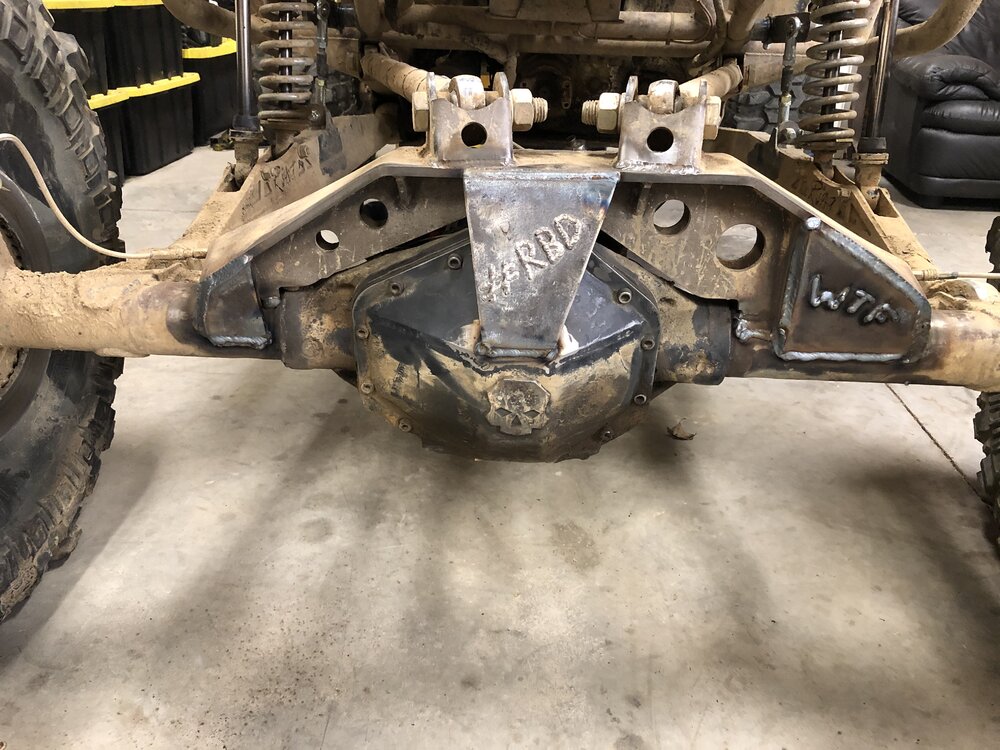

Slapped a stocker back in and I’m good for RBD.

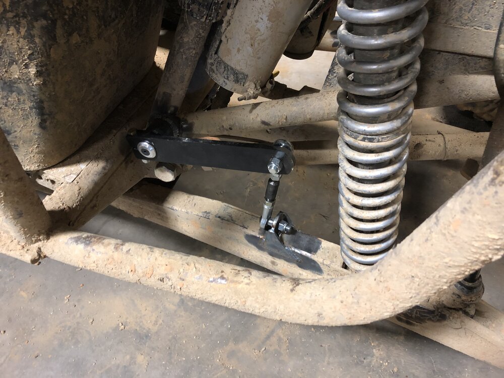

Also swapped the sway bar to a different setup.

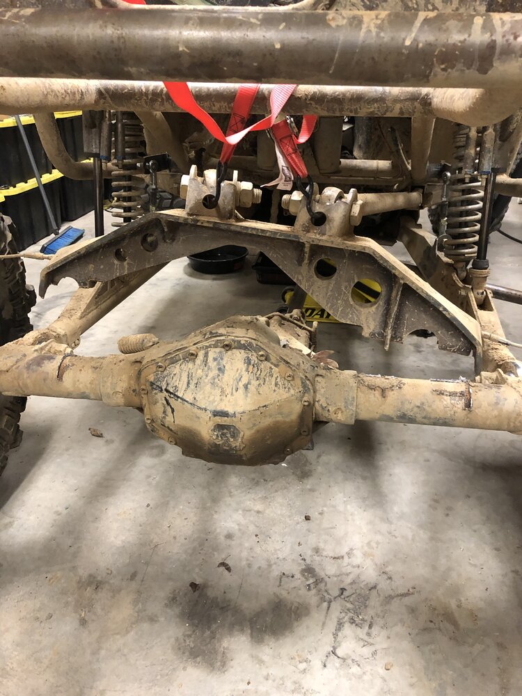

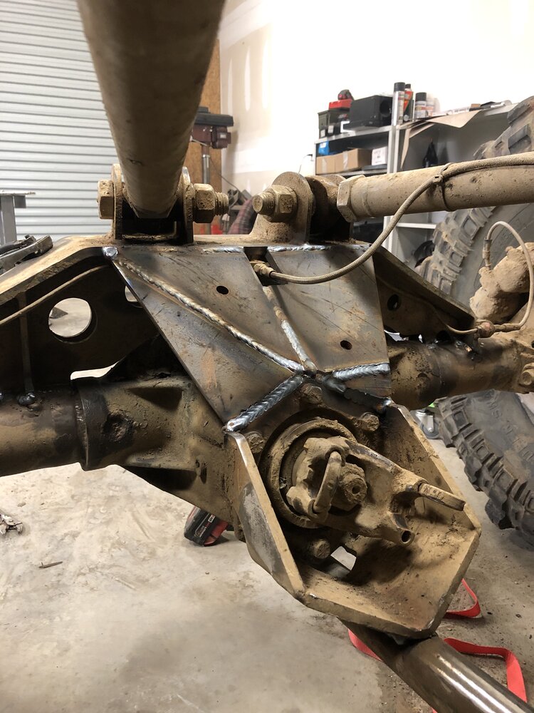

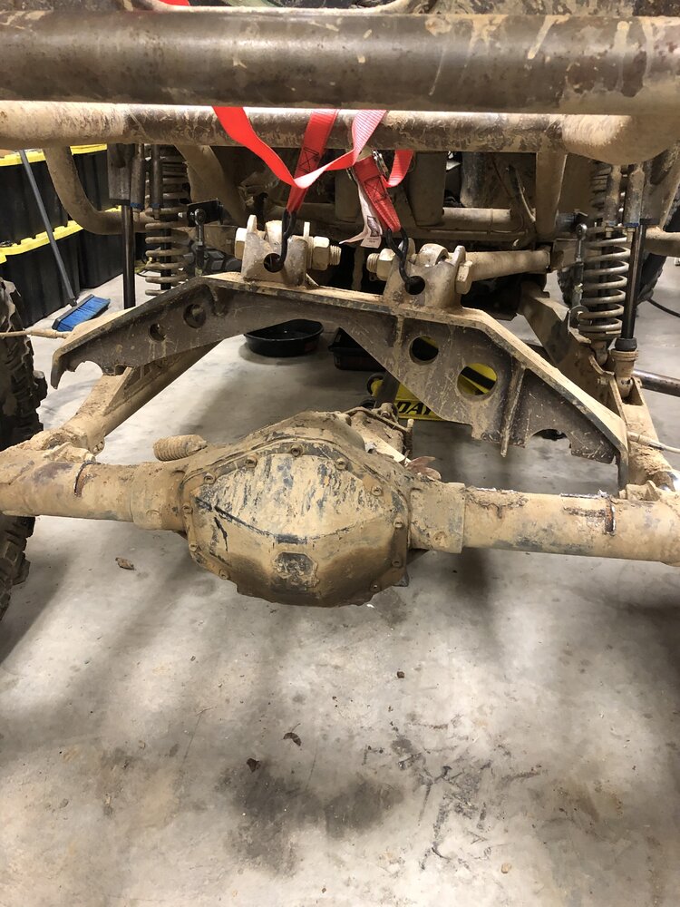

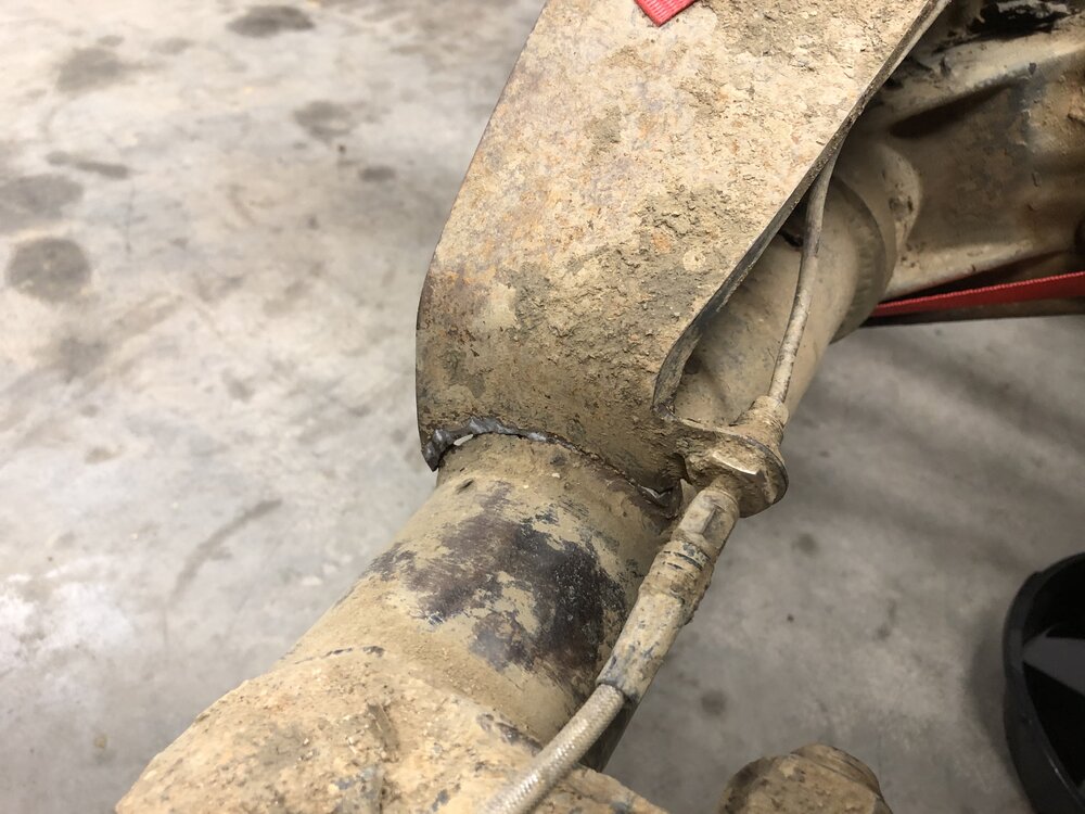

did the truss twist or "let go"? The Truss appears to be ok. The attachment seems to be the question. Some tie in to the pinion skid via a bolt on member seems like a good idea. I wanna see the weld tear out because my brain works that way.
The whole truss is tweaked, the welds didn't just break, the metal ripped off in parts.
That said, if I had to weld one again, I'd bevel the 3/8 plate in order to do multiple passes instead of relying on the corner joint alone.
The truss was welded by a competent guy with a good machine (IE not me and my miller spattermagic 211).
The little 3/16 "ribs" ripped right off and don't seem to have had any kind of strength.
The tubes also twisted in the housing.

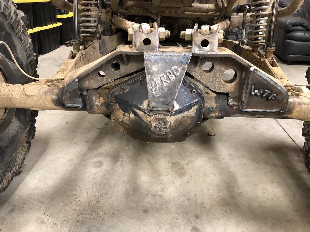

Since I knew this day was coming, I have another axle I'm ready to put together. Another 14b with a full artec truss with pinion tie in and and backbone (although I'm still not sure I want to do the backbone) :

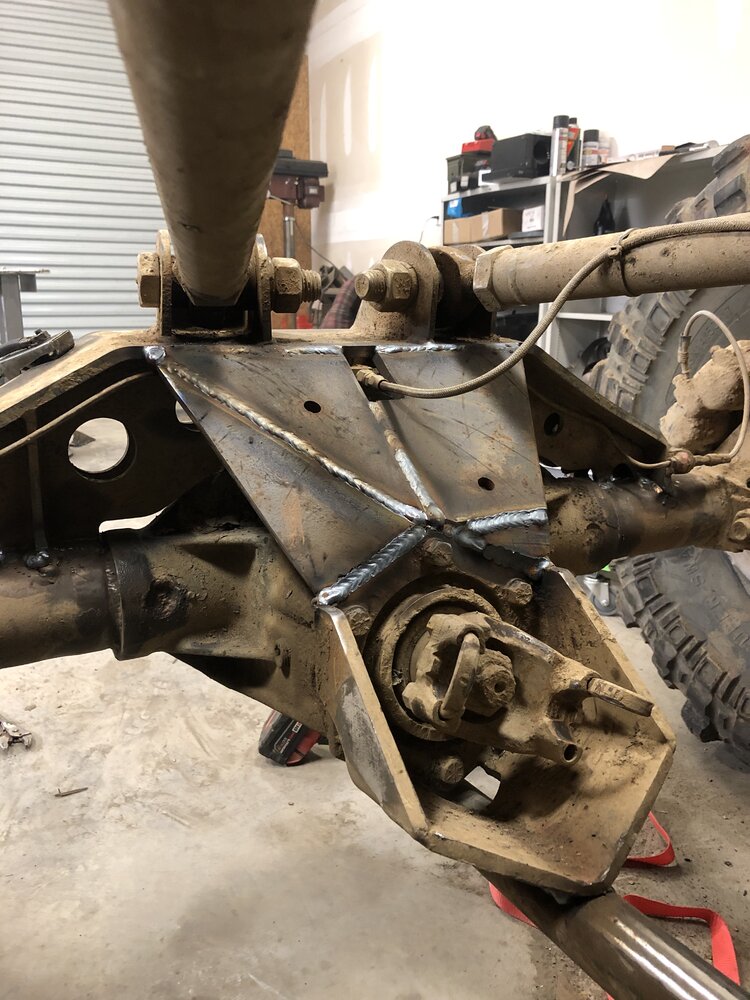

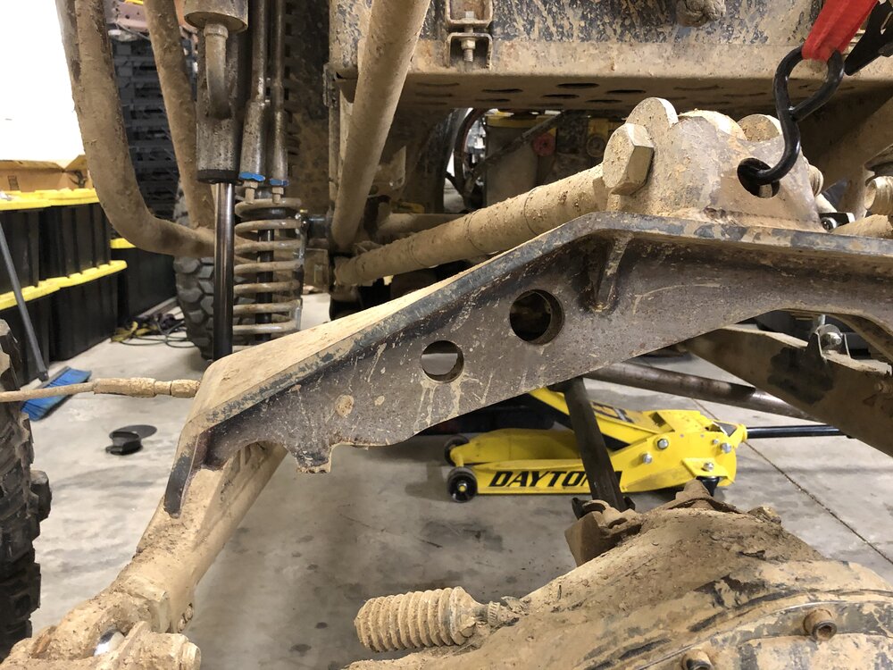

I tried to take the picture as square to the truss as I could. Both sides are tweaked similarly.
Plate is 3/8". Again, the reinforcement ribs didn’t do shit.

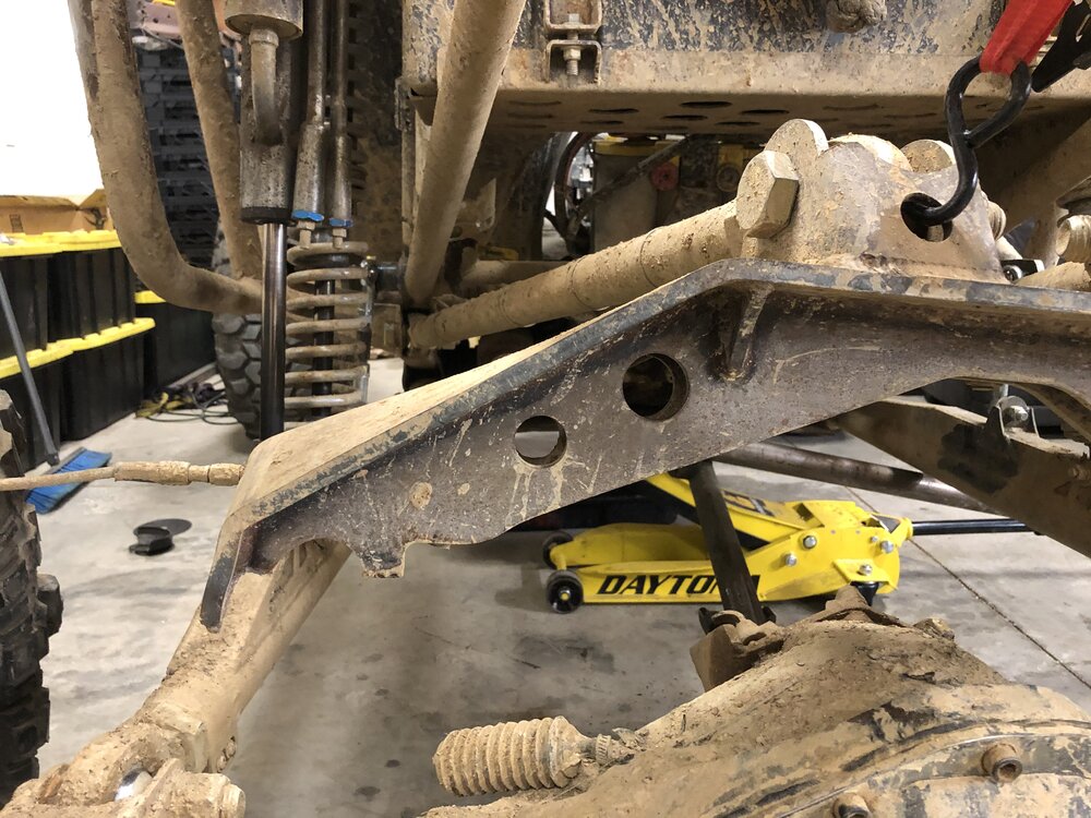

This picture does the twist justice. I second the Multipass weld. The 3/16 you referring to being the truss center sheet? Looks like two layers. Call it front and rear. Spacing those as far apart as possible does help with the load that tore it off. I always thought the 3/16 filler helps more with loads from wheel to wheel in up and down forces. Either way it seems you have put plenty of runs on it. Never met but I know enough to say your rig isn't a parade piece but used as intended.
The one pictured has twice the surface area and the tie in to the pinion.
Yes. They are pretty spaced out already on the new truss I will install (see picture).
I may pony up and build my own external plates and box the whole thing and tie everything in, including to the housing.
