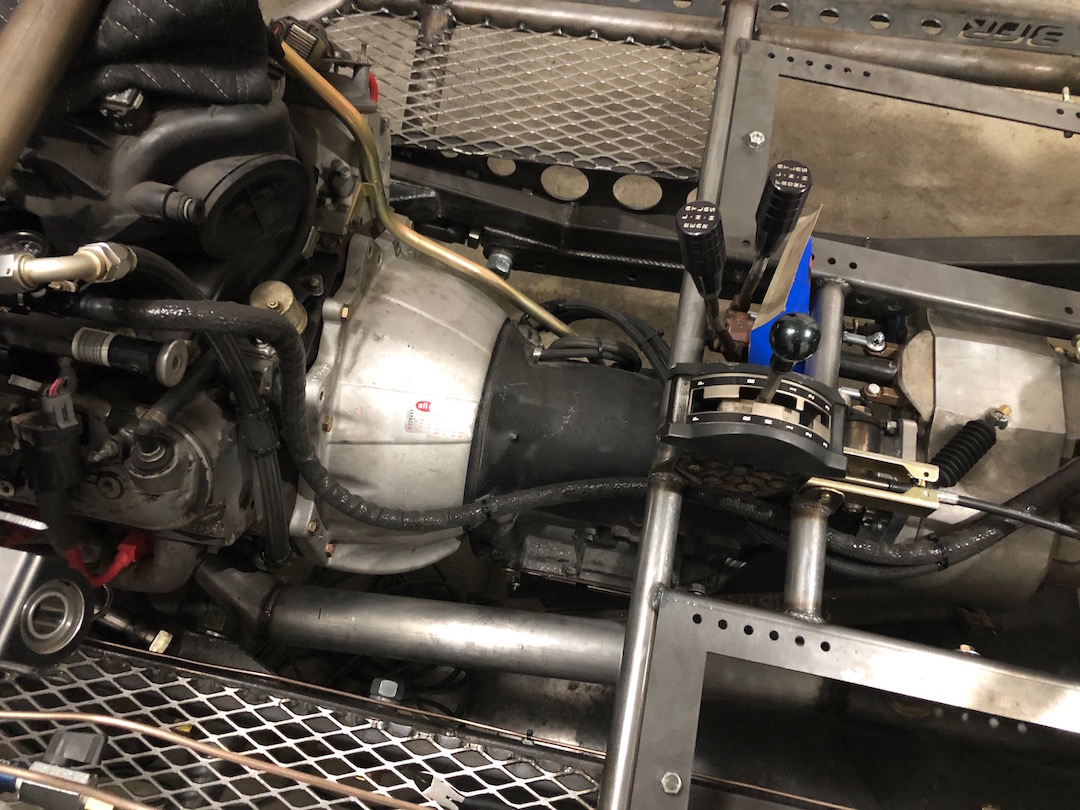

Trans : PTC TH400, RMVB, 2000rpm converter, Ultrabell

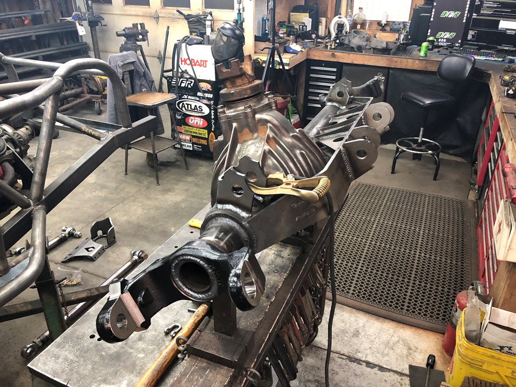

Front axle : 14 bolt, housing built to my specs by Jake Burkey of BKOR, Mark Williams 40sp spool, 4340 40sp shafts and RCV Big Bells, 13 bolt shave, 05+ F250/350 outers with BJE.

Misc : Heated seats, Hydroboost, Griffin FRONT Rad, GoatBuilt Fuel cell with stock Silverado pump, Winters shifter, Moroso Accusump, Holley ECU, Front AND rear 8274 winches etc…

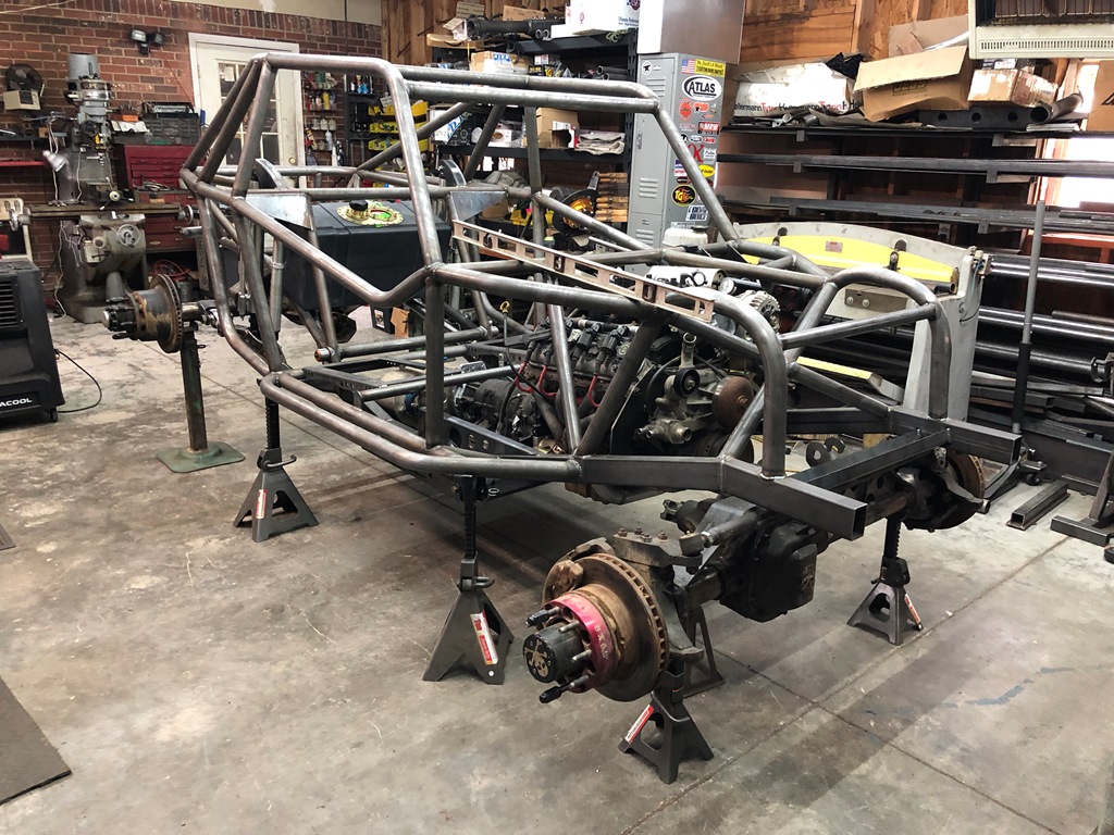

Tim from Bent Fabrications started on the roller September 2018 and I picked it up from him right before Christmas that year. Him and I and my best friend Donny thrash built the front 14 bolt in a day and a half right before I picked it up. I finished the buggy in my single car garage during 2019 and it's about ready for a test drive.

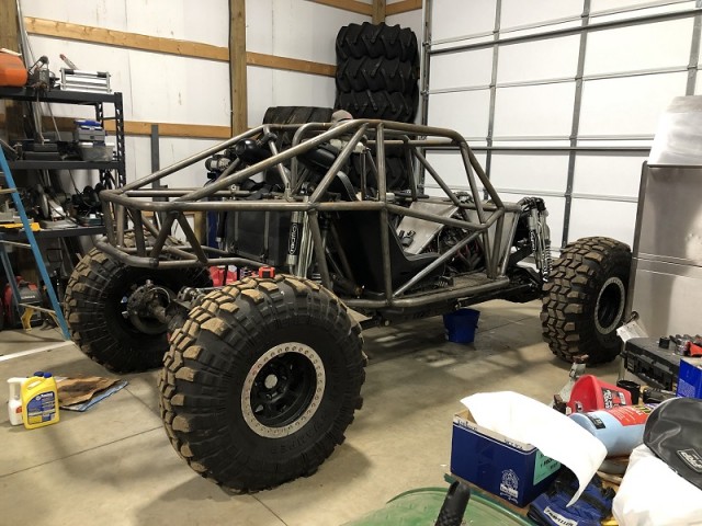

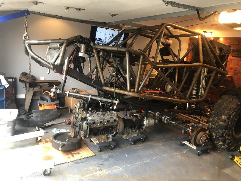

Some pics during the build :

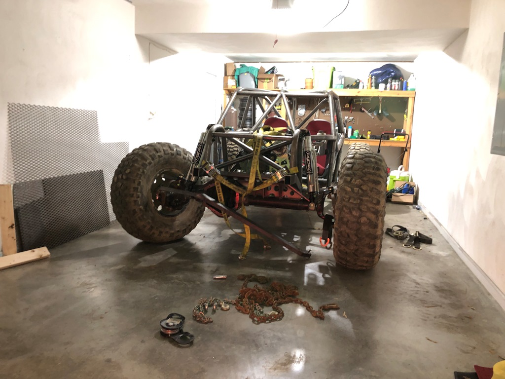

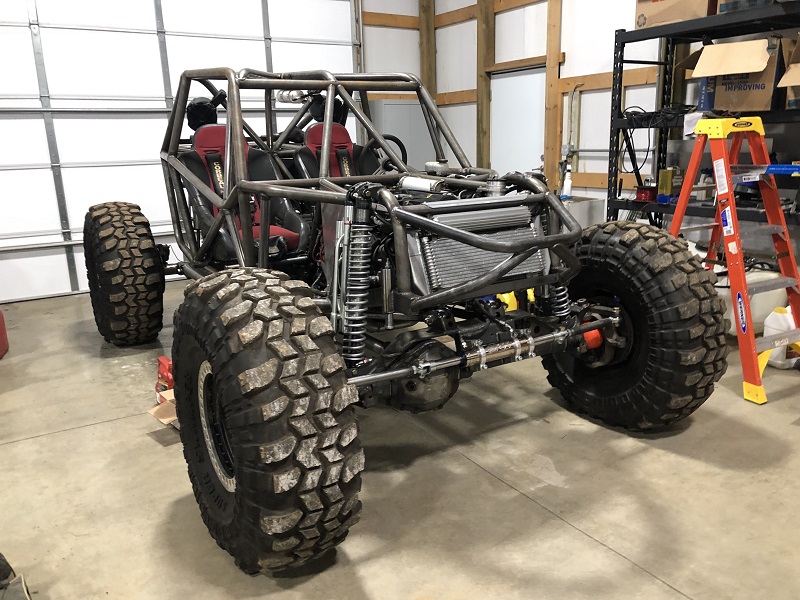

Finally, at ride height when I measured the weights to order springs, which is pretty much how it sits as of today.

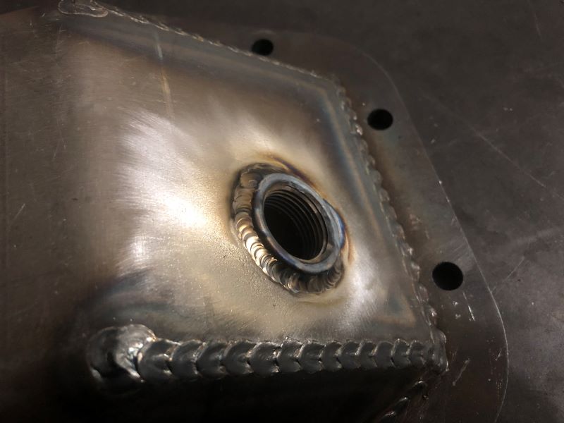

I enjoy TIG welding, wiring and the challenge of turning something that's in my head into a tangible object.
Little pic of definitely not my worst weld :

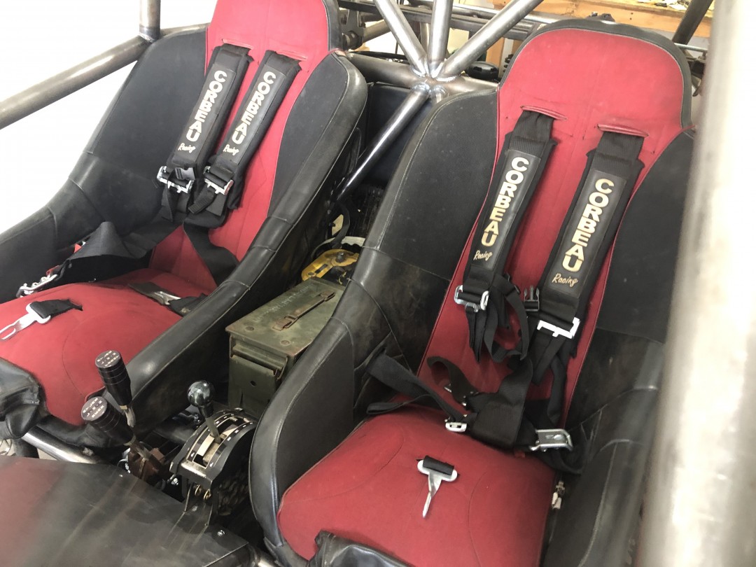

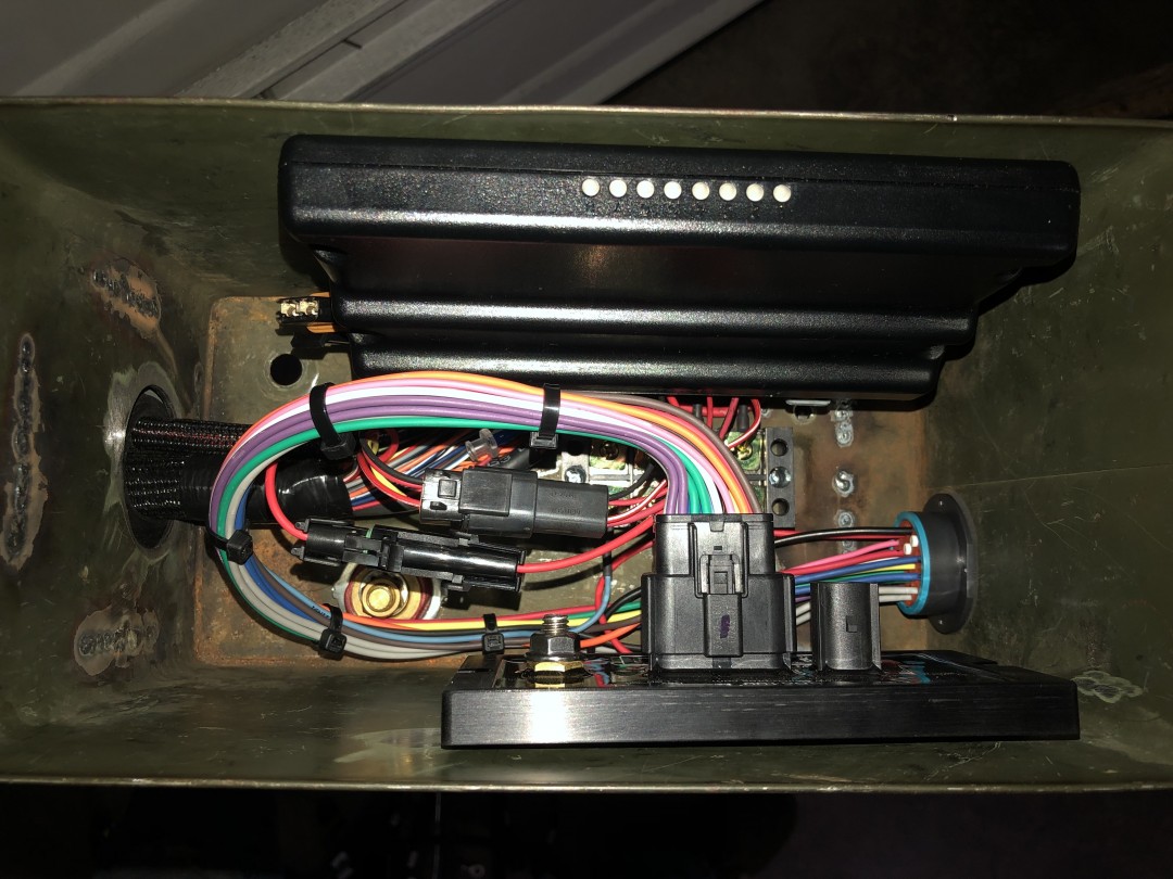

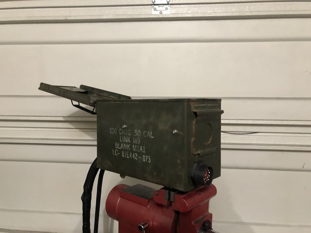

I ended up putting all the electronics into a waterproof amo can. The front 1/4 turn plug hosts all the chassis wiring. The engine wiring goes through the back hole but another quick disconnect plug will be added in the future.

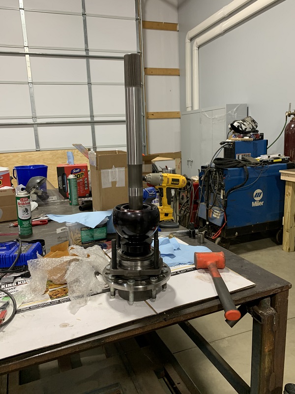

Also I'm pretty sure I was one of the first people to try to fit some Big Bells in a 05+ SD axle. I've become very familiar with these and was able to work with RCV and Nick Barna of BallJointEliminators (both great companies) to make this happen. I'm a unit bearing / CV shafts / hydroboost guy for life haha

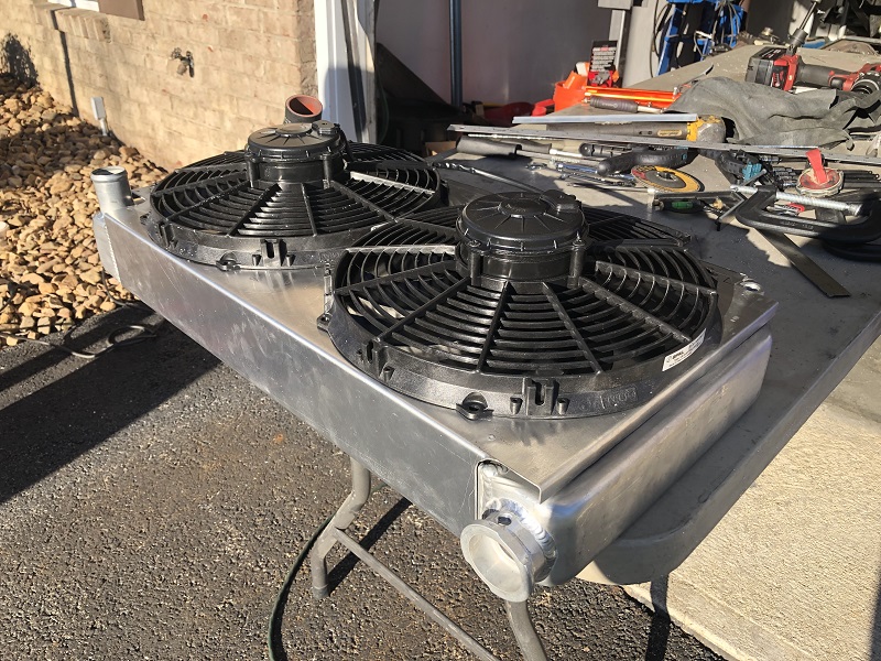

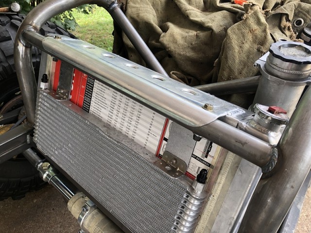

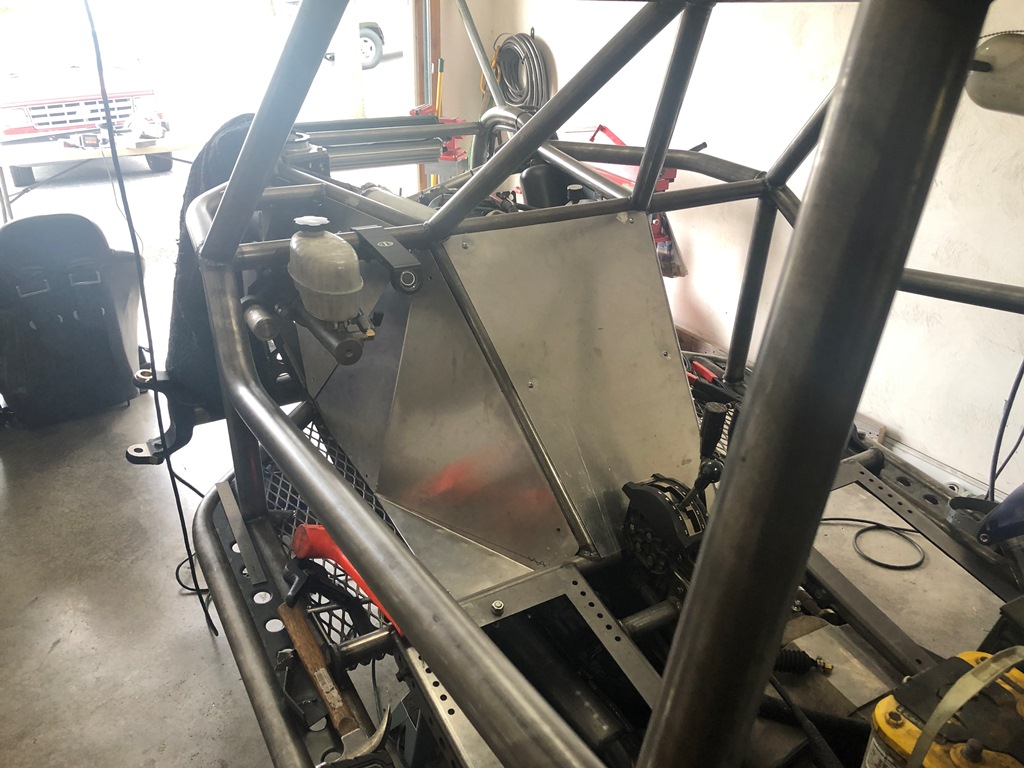

I chose a tubular front end cause I didn't want any bodywork and I like the look of the tubes better. It made my life way harder and I would advise anyone that wants a front radiator to go with his sheetmetal front end. Live and learn !

I will start by saying that out of the 2 days of riding we had, every issue that rose up wasn’t related to the chassis nor the suspension. These were the key factors of why I knocked on Bent Fabrication’s door and I can say Tim delivered! Both of them performed excellent. The springs and shock valving are way off (I threw the shocks and springs on to make it to RBD), but it shows incredible potential already. Can’t wait to spend some time tweaking these with my buddy Jake from Busted Knuckle Offroad!

Front rad cooling package works well. Stupid easy to bleed and no issues during the ride. I’m glad I put the radiator there. Another good thinking by Bent Fabrications.

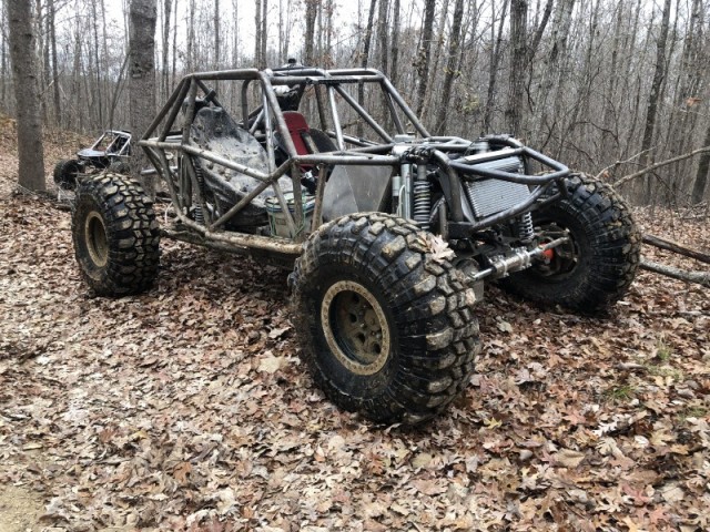

Here are some pics:

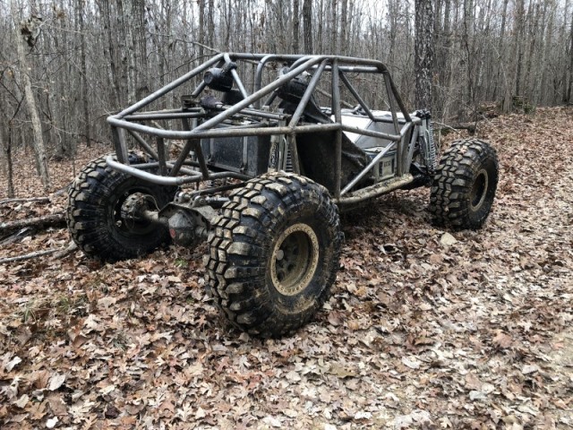

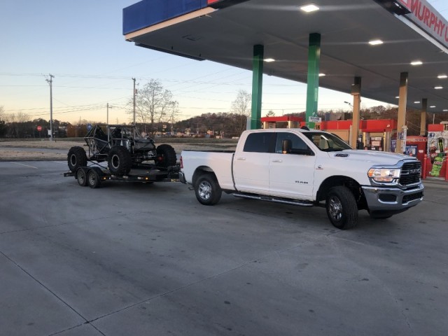

On the go:

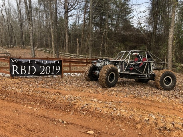

Arrived at RBD:

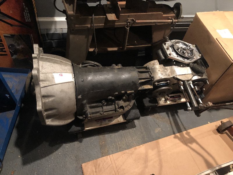

Drivetrain is out for rebuild/upgrades.
Gonna sell my LJ, need some $$ back in the piggy bank.
While everything is out, I'm looking into modifying some stuff to make wrenching on it easier : better wiring harness routing and disconnects, shutoff valves and dry breaks connectors for the fluids, new engine mounts, etc
