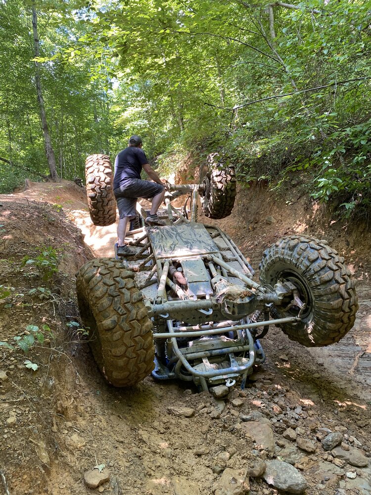

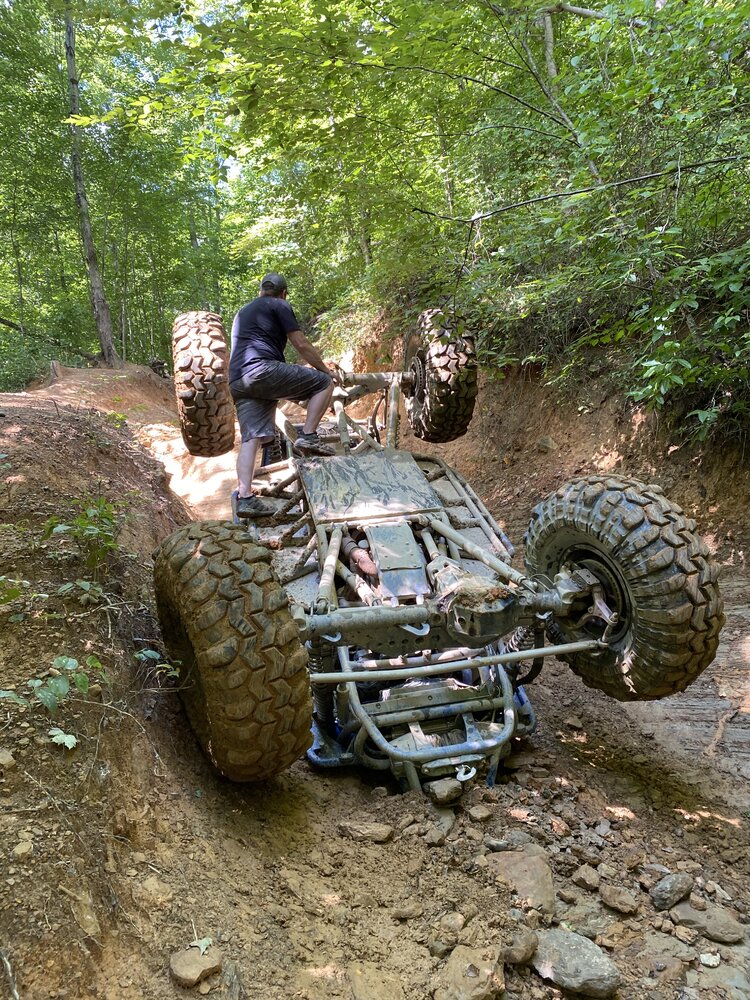

Alex showed us what 100% commit means and I chickened out.
Is this cadillac hill? If so, it looks like you fully committed to the back flip :rockon:
Airplane Hill, just before you turn right to Cadillac.
I believe I was the only one to give a half-assed attempt to the left exit of Cadillac Hill, but I was the last one in the group, day was running late and the buggy was miraculously still together so I elected not to push my luck.

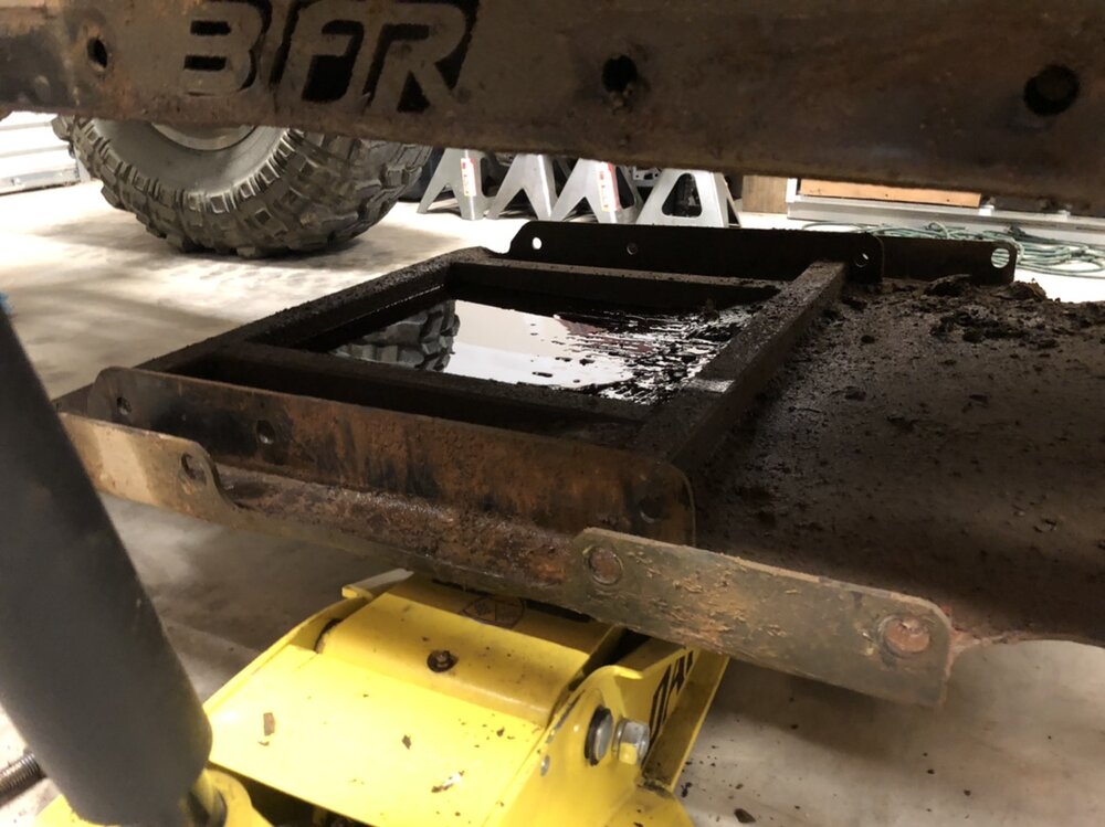

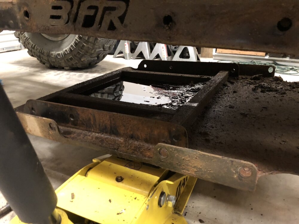

I pulled the skid plate Thursday. It was full of ATF.
Trans pan broke because a rock wedged itself between it and the skid plate and I probably bellied on something.
Gonna put a new pan and filter on it and hope for the best. Trans still moved the buggy in and out of the shop soooo IDK.

Dang. I know mine is leaking gear oil because you can see it dripping off the skid. I never thought to make it a pan so it would just catch it all and I wouldn't have to worry about it! :laughing:

Good catch! Figuratively and literally. I don't know that I wouldn't make a gracious provision to not allow that stuff to pool in the future. Many a fire has been started from Hot ATF hitting exhaust.
That's a very bad what if to contend with. I want my Fireball in a glass.
It’s about the motion of the drill not the size of the bit
What size hole do you recommend ?
Minimum .5 better at .75 unless you wash frequently.......sediment and the like will clog anything under an 1 quite regular.
