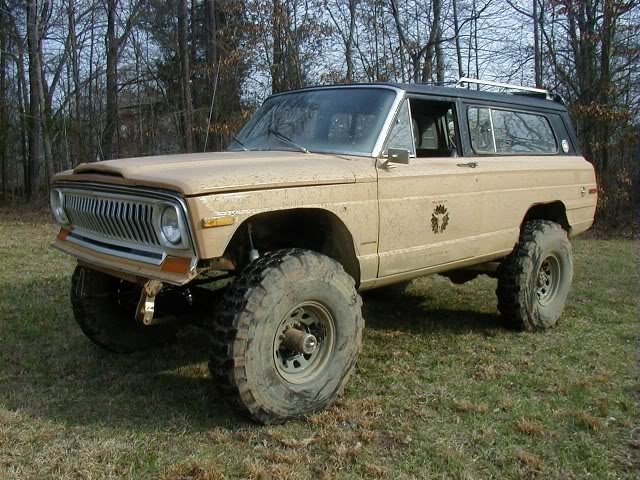

worked on the fuel cell today. bracing up the bottom to keep the rocks out and all that jazz
also installed a flow kooler water pump and a new heater core. go me
ill tow myself damn it!
[/IMG]
I'll believe it when I see that green heep on a trailer behind that behemoth!
Ex looks nice. Can put lots of stuff inside and help me move next month!!! How's the gas mileage to Roanoke in that thing??:driver:
