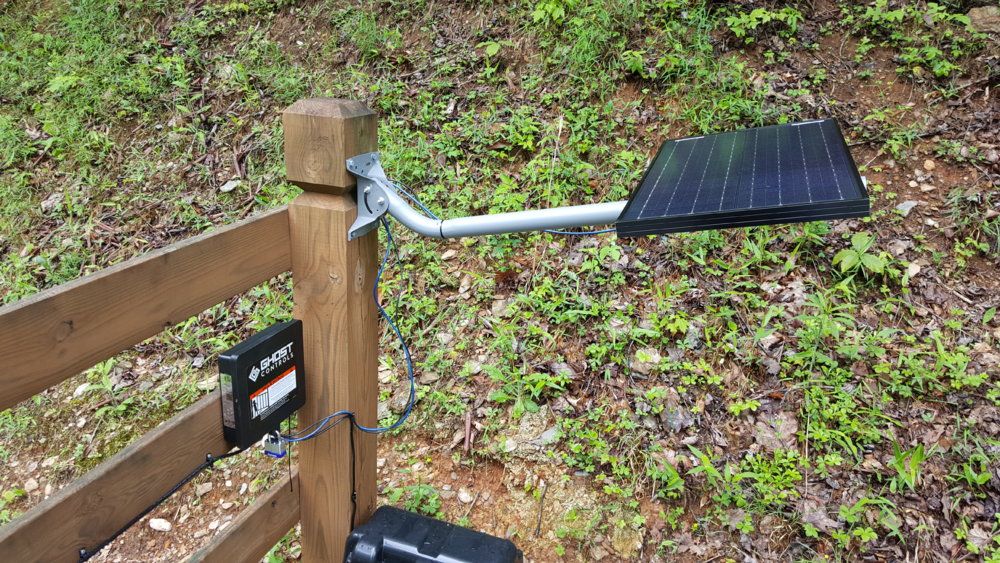

After talking with them and comparing the features/ease of install, Purchased a Ghost Controls TSS1 Heavy-Duty Single Automatic Gate Opener Kit for Swing Gates Up for $399 in April for a single 12' tubular cattle gate. Took a couple of hours to install (2 beers) it after waiting for the longer brackets ("Push to open", though it's actually pulling to open, due to the way gates's mounted on the backsides of the posts vs. in between).
Purchased plastic battery box at Advance (set on pavers behind fence & below the control box) that would take the battery I had (though I was heading for a deep-cycle, used a regular car battery out of my DD), and wired it up.
After some difficulties reading the plain English instructions, got both remotes programmed (2nd remote was extra) and we were off to the races!
After a few weeks, the panel was telling me the battery voltage (12.6VDC before install) was south of 12VDC... as it's just over 1100' from the house (fawk trenching a cable that far from the house panel in this rocky ass ground or $2500 for AEP to drop another transformer down there... which also poo-poo'd all the "surveillance" goodies I hand planned down there), I ordered in a 30W/12VDC mono-crystalline solar panel (per the Ghost engineer, the onboard charge controller will take 30W) and the cheapest "satellite dish" mount I could find (both from Amazon & 1/2 the price of their 10W solution). Took a few days to actually aim the panel per the interwebs.... checked the voltage every couple of weeks for the first month (12.5VDC) and quit looking for a problem. Will see how it does this winter when sunlight gets scarce for days on end, but think

Just wanted to follow up on this after about 8-10 months of use...
3-4 weeks ago during the hard freeze (was single digits up here on the mountain), I left for work, the gate opened & shut behind me.
My wife calls about lunch to say the gate won't open. I relay to pull the hair pin & hitch pin the secures it to the gate, and swing it open...
I arrived back home in the dark and threw the meter on the battery. Thinking with 10+ cycles per day, winter times reduced sun angle (fawk moving the panel 2-4 times a year) & rain/snow since early December keeping the charge times reduced, I figured the car battery (my 7 year spare out of the DD) might be getting low... nope, fully charged at 12.6VDC, so buttoned all back up for the night.
Later that week, after some googling, walked down, observed 7 beeps (a code signifying something was wrong with the arm) and "reset" it via the switch (conveniently hidden on the bottom of the control box :flipoff2:)... we're back in business!
Fast forward to sometime last week... same scenario, arm moves 2"/stops = 7 beeps, and no amount of resets were working.
So, Wednesday I called Ghost Controls (trying not to be pissed about an opener that's less than 1 year old taking a :poop:), got right thru to "Mike", described the issue & beeps... he told me there's a lifetime warranty on the arm (control board is 1 year) and he'll be sending me a new arm with return shipping for the old arm. I asked if they just rebuild them and ship them out for warranty... "Absolutely not, we take it apart to see what/why it failed and use that info to make them better! You will be getting a brand new arm".
It arrived today (brand spankin' new), and took less than 15 minutes to swap out (despite the cold/rain) and the gate is again keeping the lookey-loos (several adjoining properties for sale, teenieboppers looking for a deadend to drink/party on, etc.) "of my yard"!
