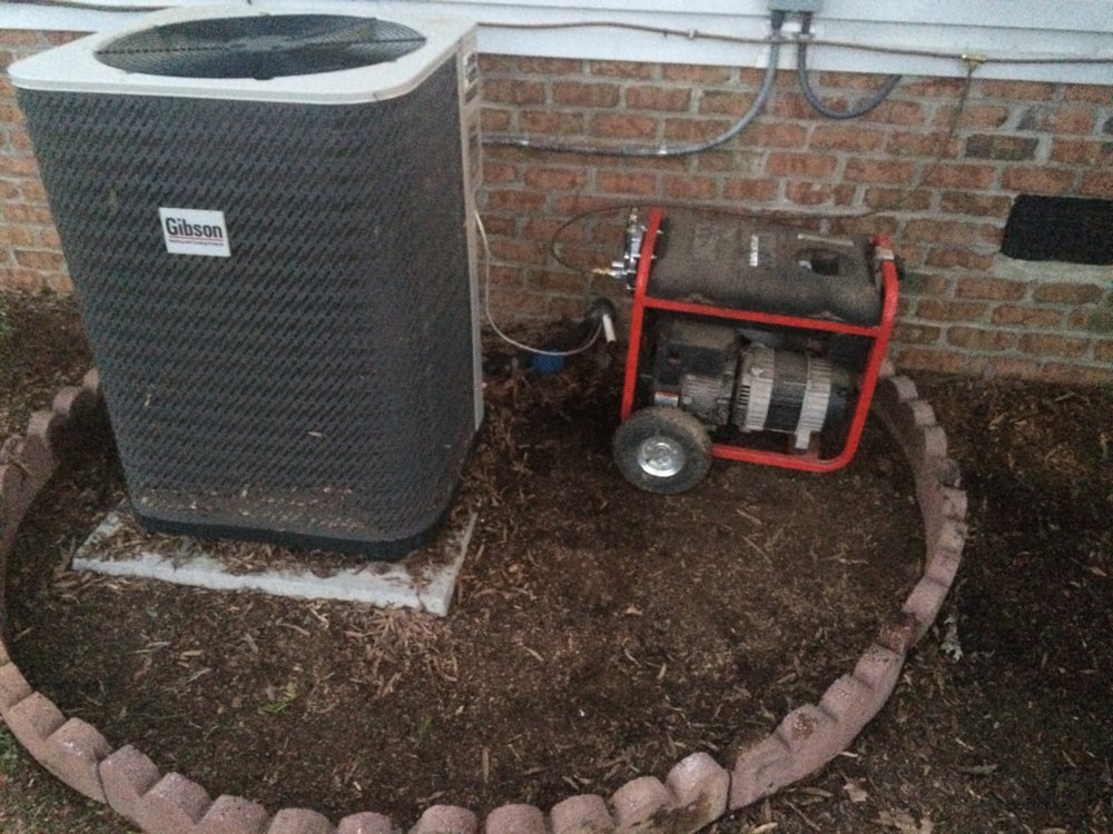

Thanks guys for the replies! I have not yet been able to introduce a load on the unit but plan on it either sometime this week, if not, definitely next weekend. Under no load, everything runs good. So, we will see shortly how everything performs and I will update. It does have a some 90's in the pipe. Pic below.
Sorry, just noticed I never stated the make of gen which is a Troy-bilt model 1924, constant 3600rpm, ohv, 3350 watt 5250 starting. And also, I remember the logs are 30k btu logs and the run from the tank to the logs was 40' with 3 90* bends. Looks more and more like I need to up the size of tubing at least from the tank to the tee which is around 25'.
