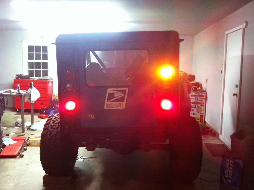

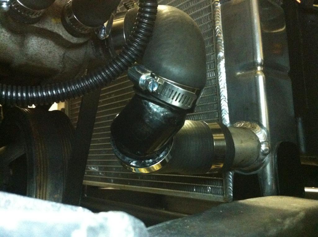

More work done today. We had to go back in and re-wire the turn signals. I had them flipped around. Now the bottom red (brake) lights only work for the brakes and the top amber lights only work for the turn signals. The middle clear lights will be setup to run as offroad lights. I'll be adding lights in the fenderwells front & rear also.
I made a custom radiator adapter since the lower hose had such a tight bend in it.

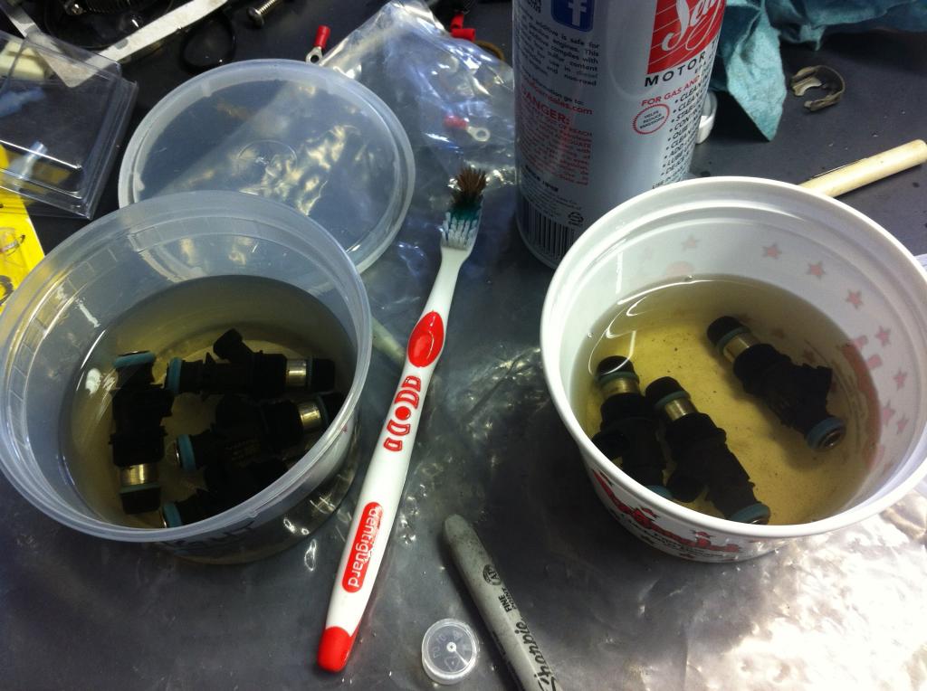

In place. We also added the coolant and a few other odds and ends. I have to take the fuel rail back off this week and soak the injectors in some sort of cleaner. I'm thinking about using seafoam to some them with because some of the injectors are still not firing quite right. I think they're still pretty clogged up. Anyone have any suggestion on what to use to clean injectors?

Apply voltage to the injector and spray carb cleaner through the injector with the straw. I have used a pencil eraser with a hole in the middle around the straw to get a bit of a seal with tham out on the bench you can watch the spray pattern this way as well

Thanks for the advise. I'll try that. I picked up some seafoam too. I plan on letting the fuel parts sit in that and soak. Then I'll blow them out with your method. Should be good to go then hopefully.

First off, I took the injectors back out this week and soaked them in seafoam for two days. The f'ers still didn't work. After two days, they looked like this. I ended up buying a set of used injectors from a friend of a friend for $50. I didn't figure that was too bad.

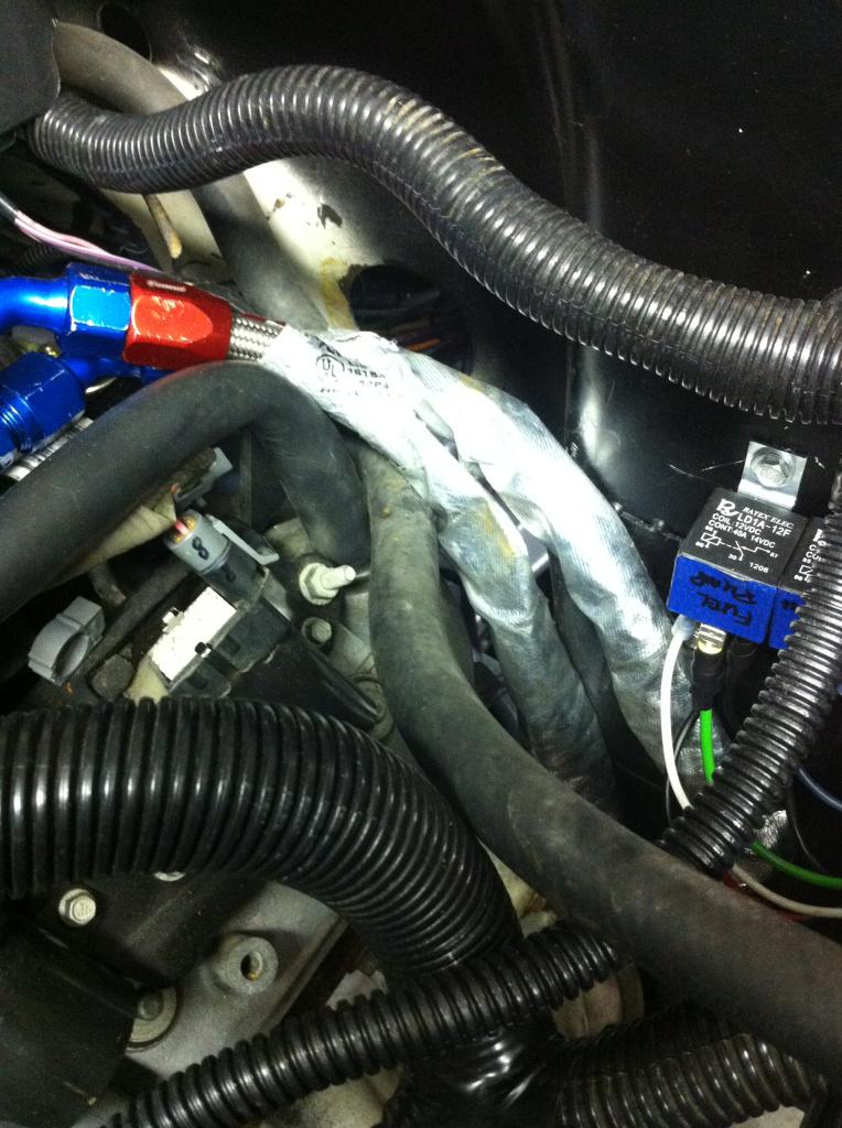

I wrapped the stainless fuel lines in nascar heat wrap when I put the fuel rail back on. Hopefully that will keep the fuel from heating up because they are very close to the manifolds.

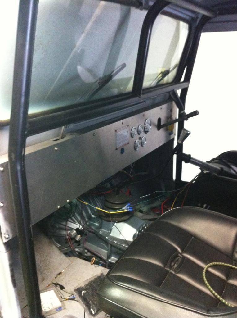

I also got the dash back in. Still have to clean up and button up the wiring behind it but it's one step closer.

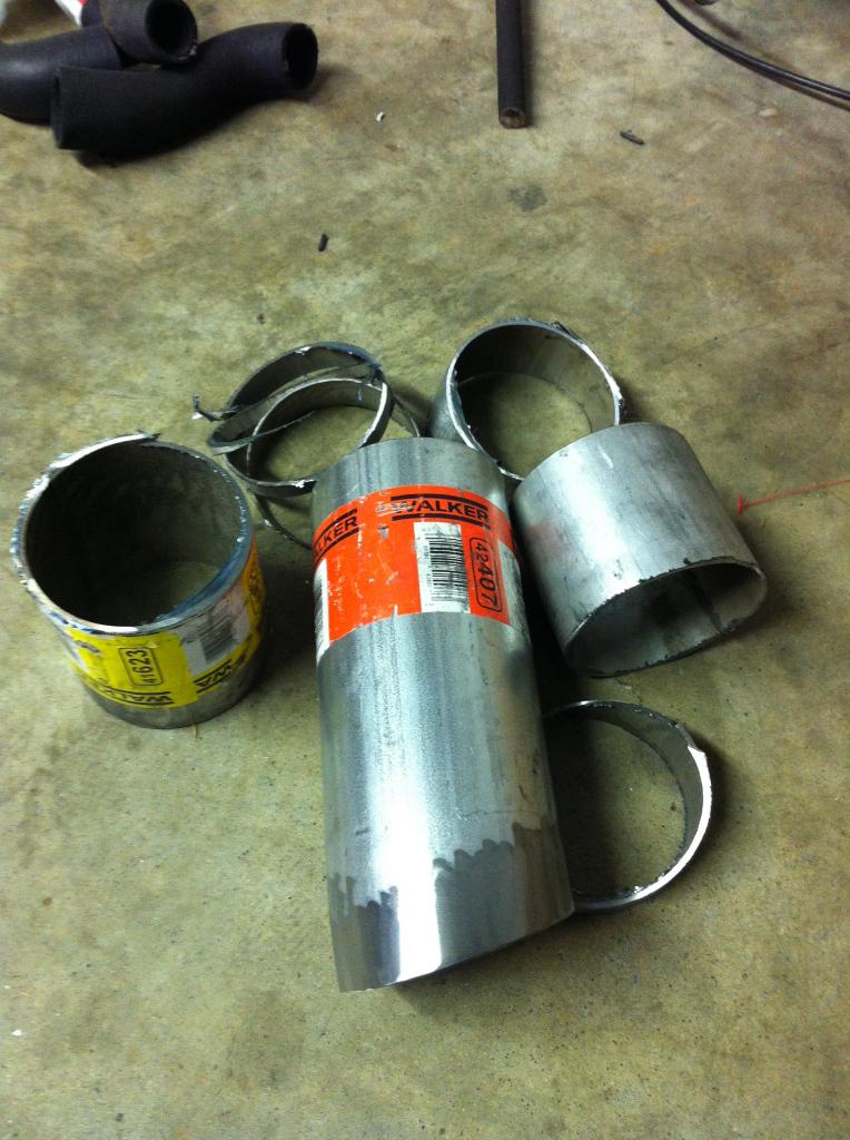

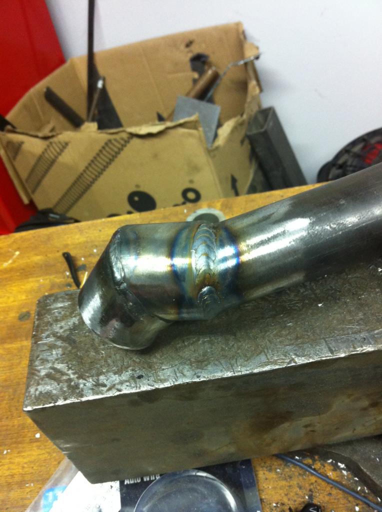

Then I had a little art project with some 4" exhaust tubing. :D This is what is left of the 90* and 45* 4" exhaust tube I picked up from summit racing.
ai1024.photobucket.com_albums_y309_95builtjeep_gone_20postal_photo105_zps425c467e.jpg
Cut down, tightened the bends, welded back together, ground smooth and voila!

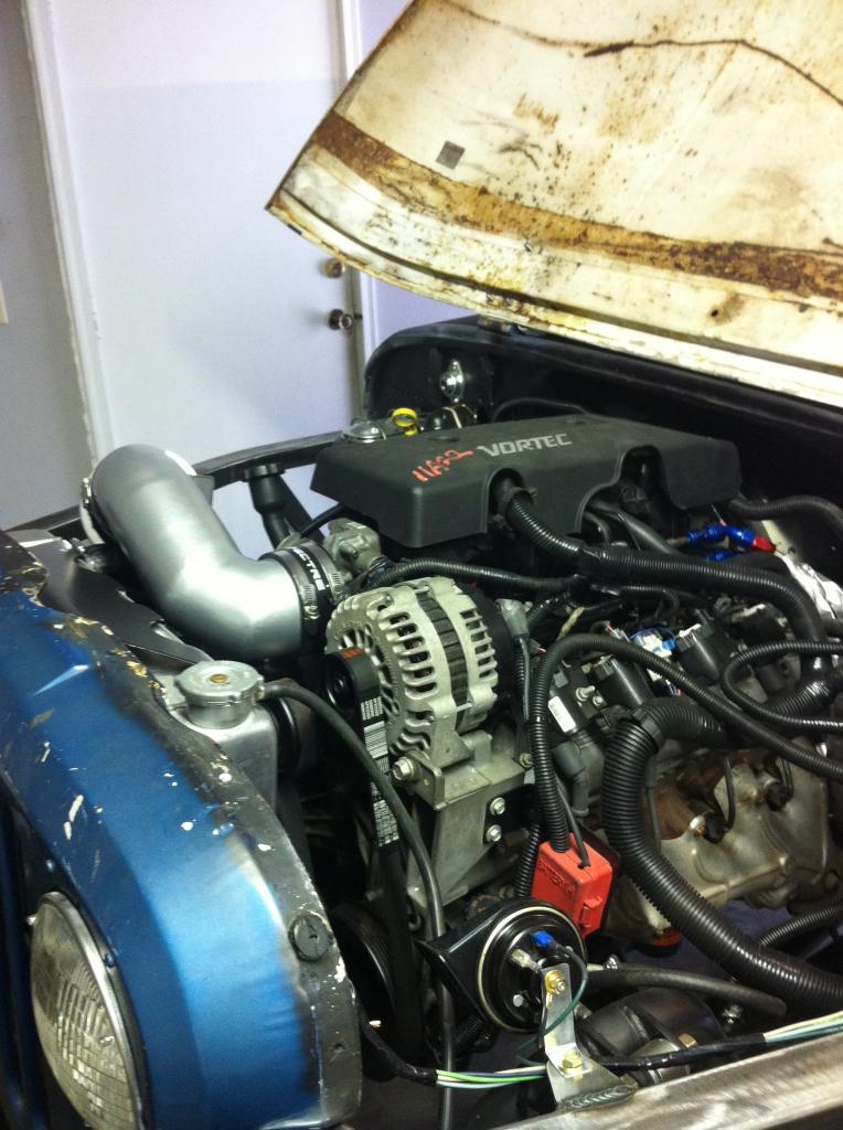

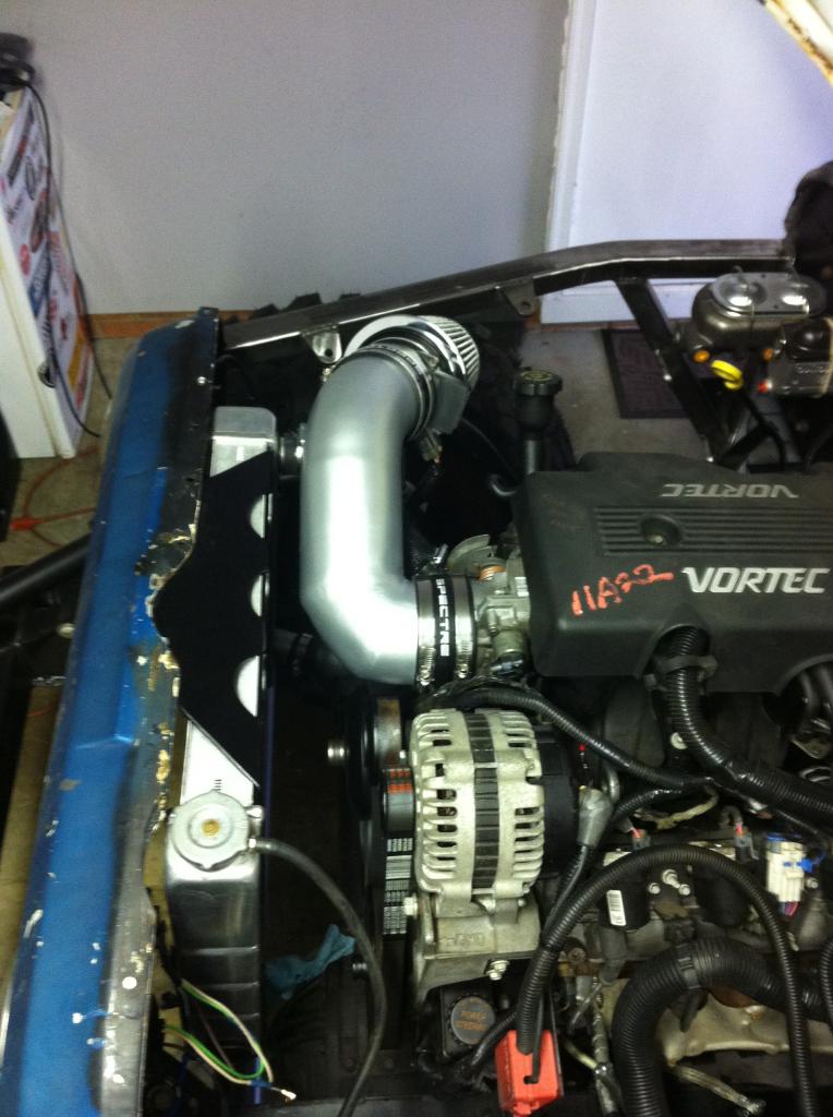

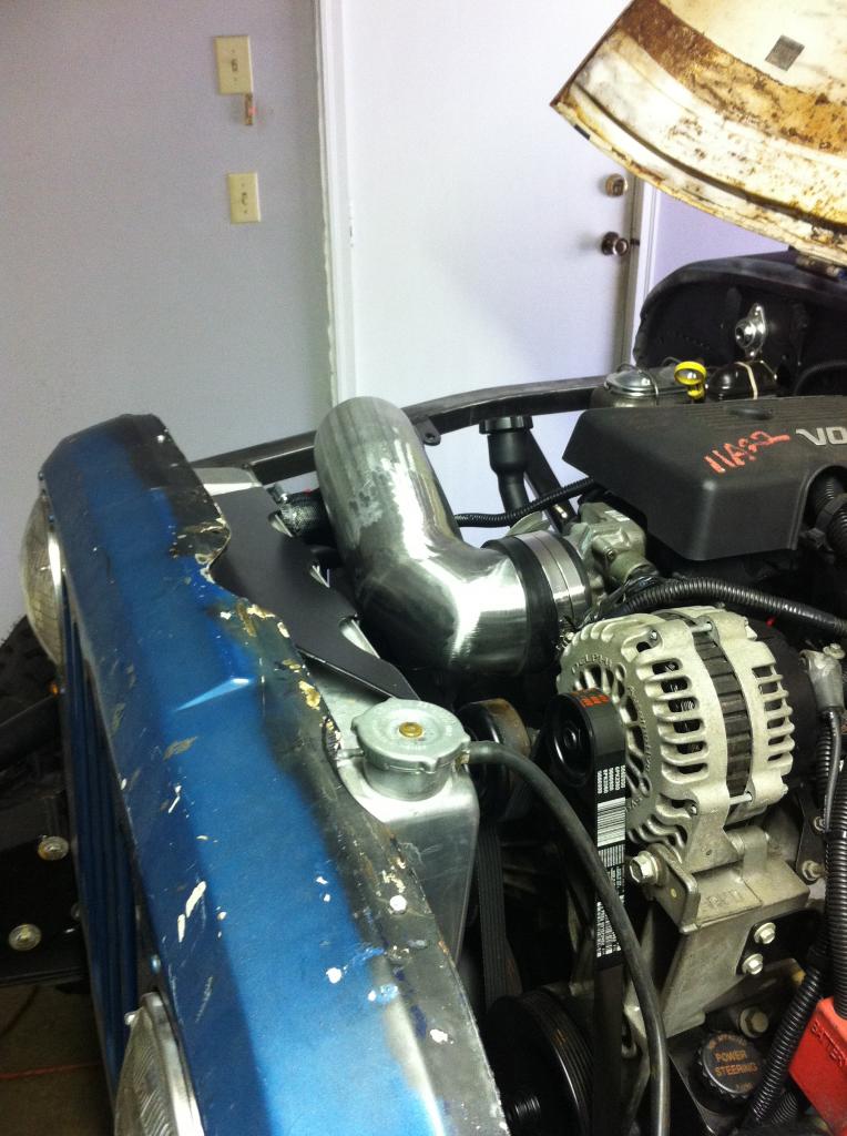

From the other side. You can see where I had to cut and re-shape to get the tight bend I needed. It also had to bend up then back down so it would clear the upper radiator hose. This is the final solution. It clears the hood and everything!
ai1024.photobucket.com_albums_y309_95builtjeep_gone_20postal_photo104_zps204e5847.jpg
Painted metallic silver. I thought it looked better than black.
ai1024.photobucket.com_albums_y309_95builtjeep_gone_20postal_photo108_zps9d2e737b.jpg

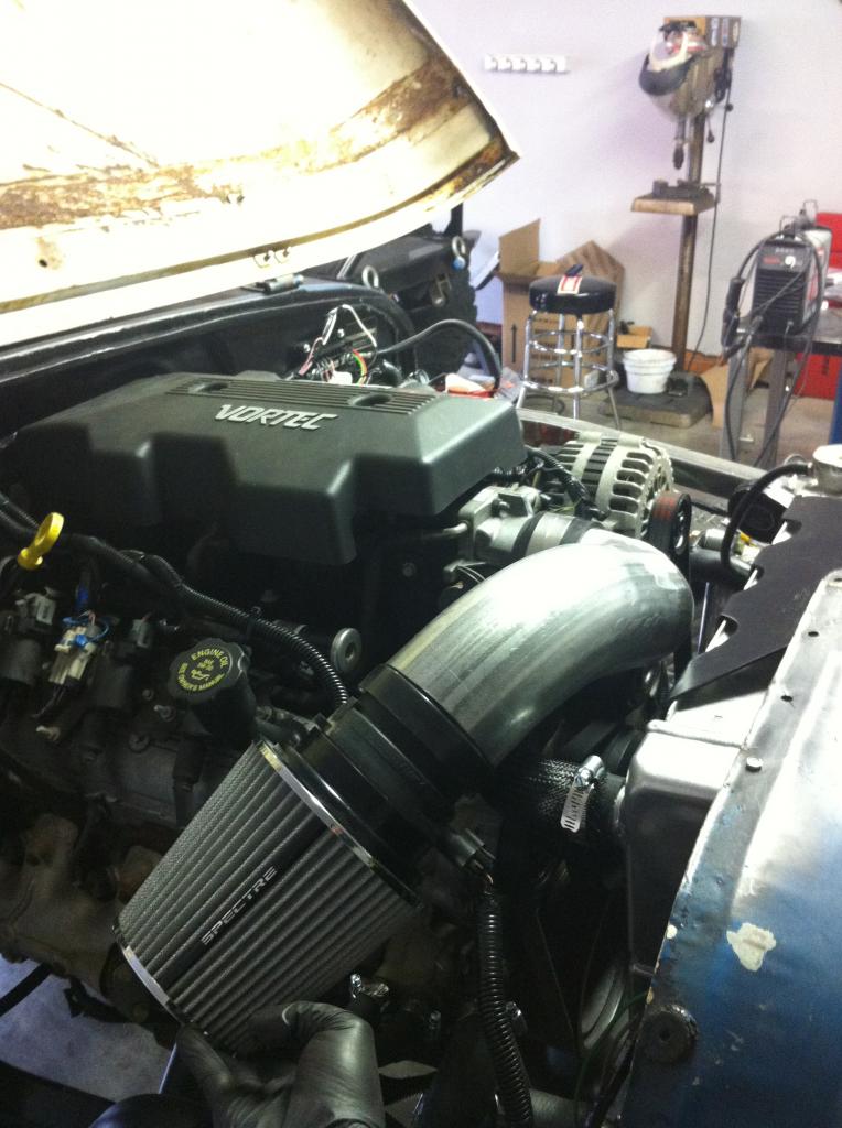

Another view. This view kind of helps you see where the bend at the radiator hose was needed.
