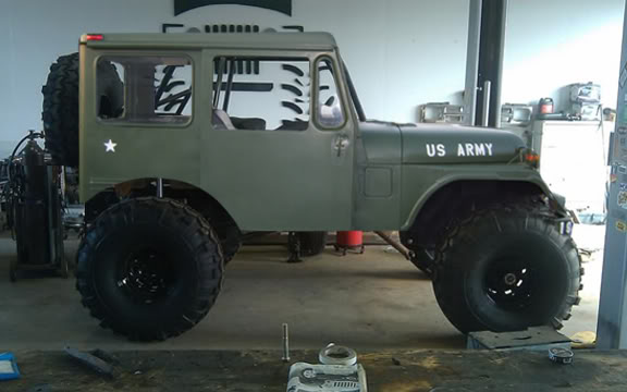

Okay guys. I just finished up my YJ build and now I'm bored with nothing to do. So what I found was an old Postal Jeep - '82 DJ-5 Mail Jeep in okay condition. Runs but tranny is bad. So here is my plan. I photoshoped what I want the jeep to look like. My inspiration is the build that Chris at Marsfab did called "Mild CJ5 Build". If you haven't seen it you should check it out! http://nc4x4.com/forums/showthread.php?t=94675
My mockup...I am a graphic designer so I had to see what it would look like. I like drawing pretty pictures. i hijacked marsfab's cj5 with their cool jeep wall art.

Holy Crap! I thought somebody was copying my shop. Thats pretty cool man.
haha. nah. i just used the cj5 you built for my photoshop'd picture.

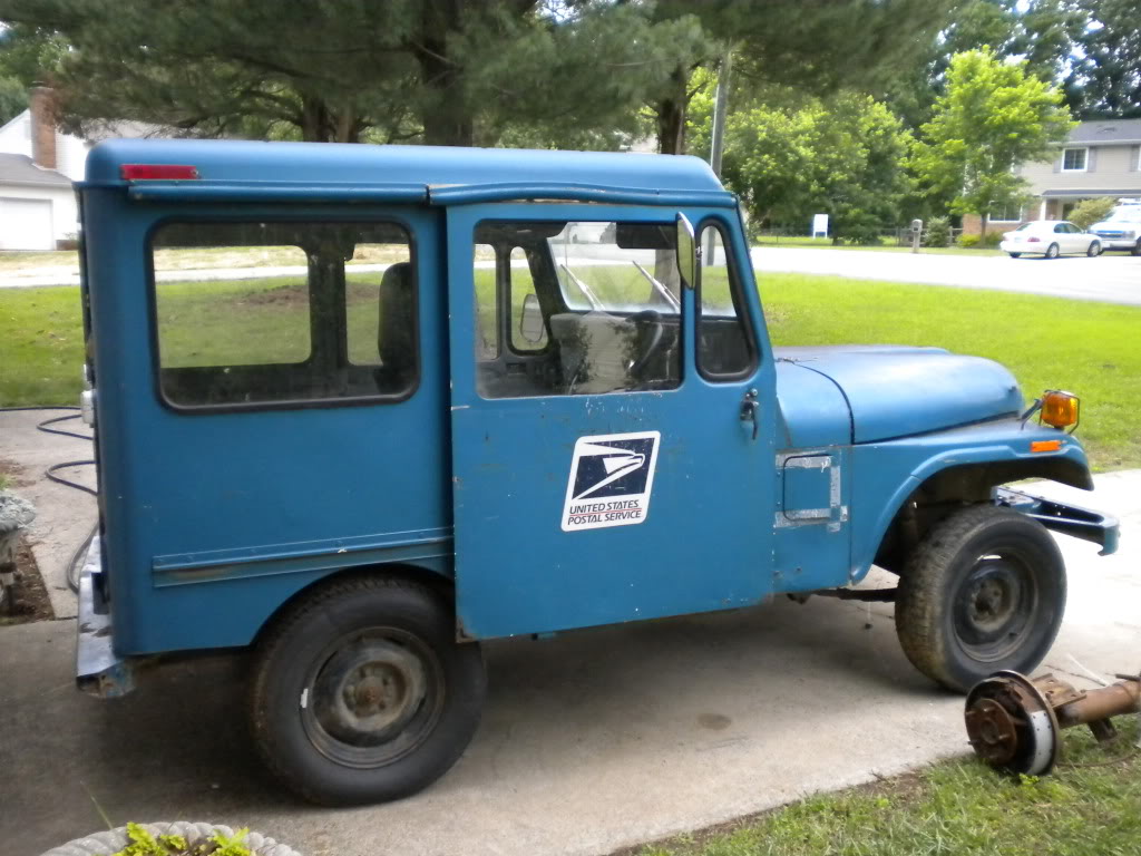

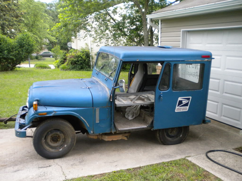

no updates yet. it will be towed to the house on monday so i'll get started then. i'm getting the title work done on it today. i'll snap some pictures of it today and post up some before pics so you can see what i'm starting with before i tear it all apart.

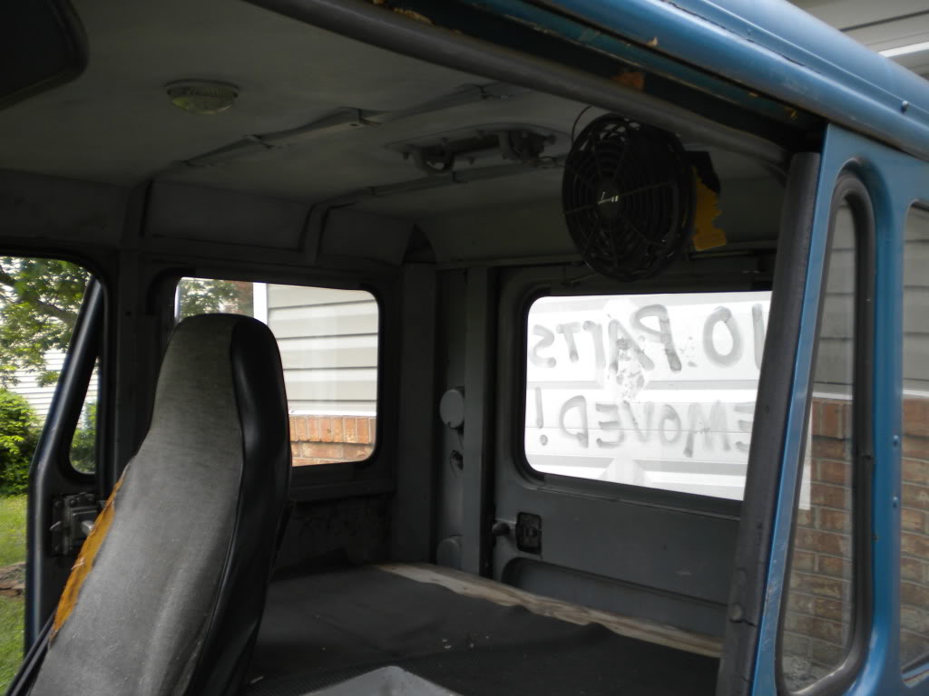

hey guys. my first post. this is the before pic i have of it. this POS is what i'm starting with. yes it does still have the USPS decals on the sides and back. It even has a fan mounted in the inside for the driver.
definitely keep that fan! :)

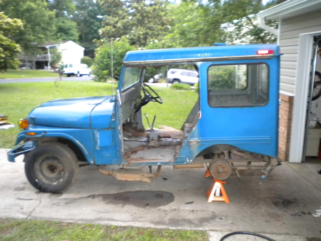

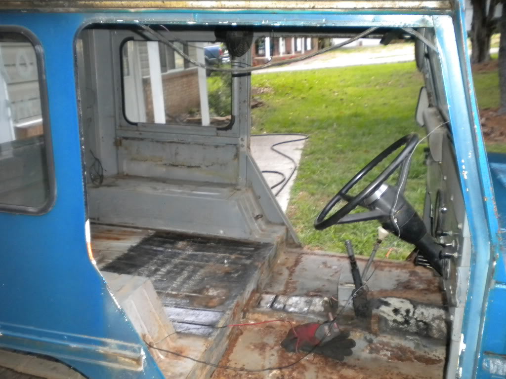

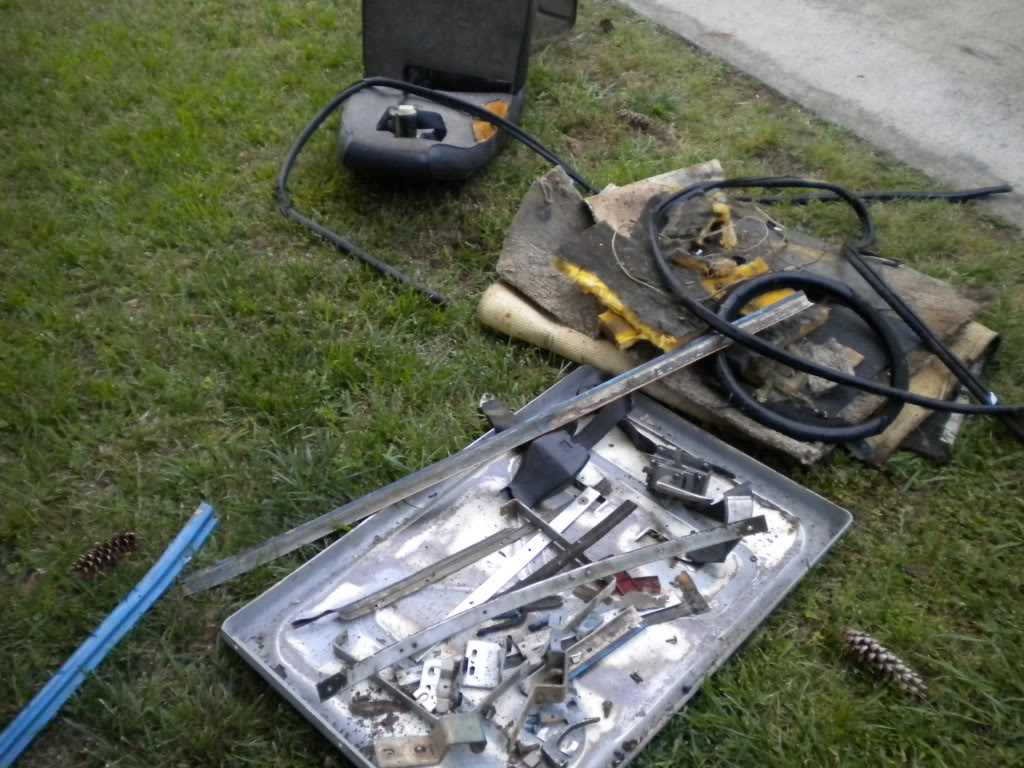

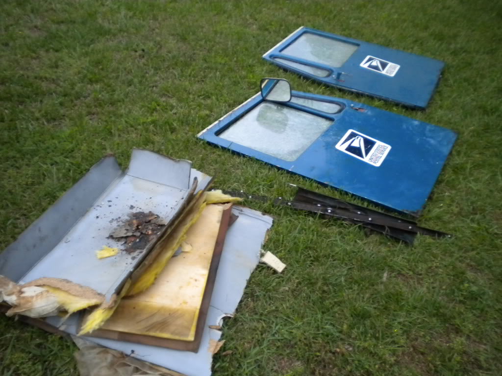

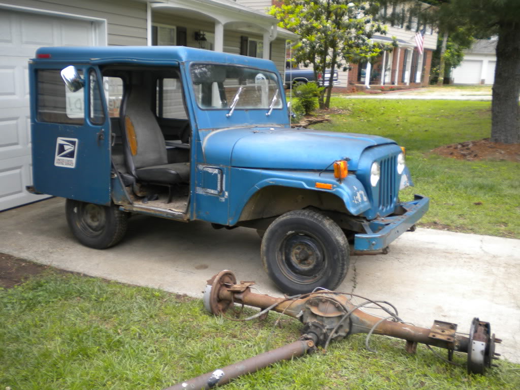

okay. so day 1 of the build consisted of tearing stuff apart and cleaning out all the old nasty carpet, roof insulation, gas tank, rear bumper, etc. there's a little bit more rust than i thought but i can cut the floors out and replace some of the rusty stuff.
what it looked like when it was first towed to the house today.
ford 9" in pic. the full width axles are going to stick out past the body. the body is only about 60" wide. i hope it doesn't look goofy. we'll see soon enough i guess.
straight up nasty old junk.
stripped interior ready for cleaning

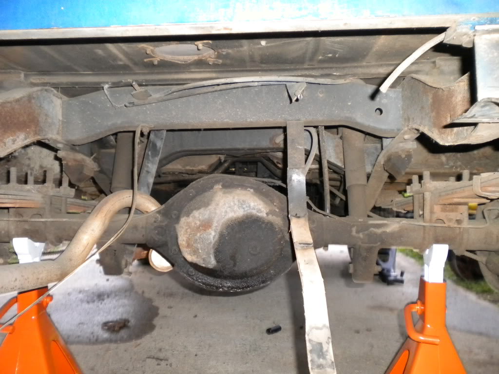

rear looks like an old dana 35. not positive. either way it's going to the scrap yard unless someone wants it.
