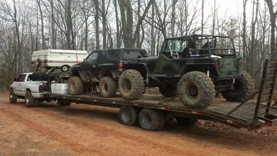

If you already have a gooseneck trailer, you could probably find a pop up at a decent price. Could either mount it on the trailer or back it on or off as needed. Not as nice as a regular camper but possibly cheaper and lighter.

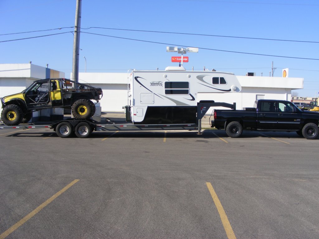

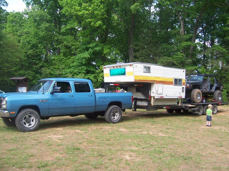

Could also use a truck bed camper on a goose neck. You could build a "rack" that supports it like a truck bed would out of tubing and use the area where the wheel wells are to put tool boxes, extra water/fuel storage and a generator for the camper. Then add some heavy duty jacks for the camper at the corners that come off and then it's possible to take it on and off trailer pretty easy
loved this setup, but wanted more security for the buggy so we sold it and went enclosed this time around.
it was nice leaving the GN unhooked and still being able load/unload the trail rig.

A gooseneck with a camper on the front of the trailer is safer for a single, and dependent on how its loaded, could easily see less tongue weight.
I just sold my combo, it was great, but I didn't like the fact my buggy was exposed.... if I were to do it all over again, I'd buy an enclosed trailer and upfit it with a living space. Being able to LOCK everything up at night while on the road is a good feeling. I'd up fit it with the inners of an older slide in camper that already has all the cabinets and minny lite weight compenents. Honestly... someone could do it in a solid weekend and a 12 pack. Its just a matter of trying to find a cheap used slide in for a good price.
