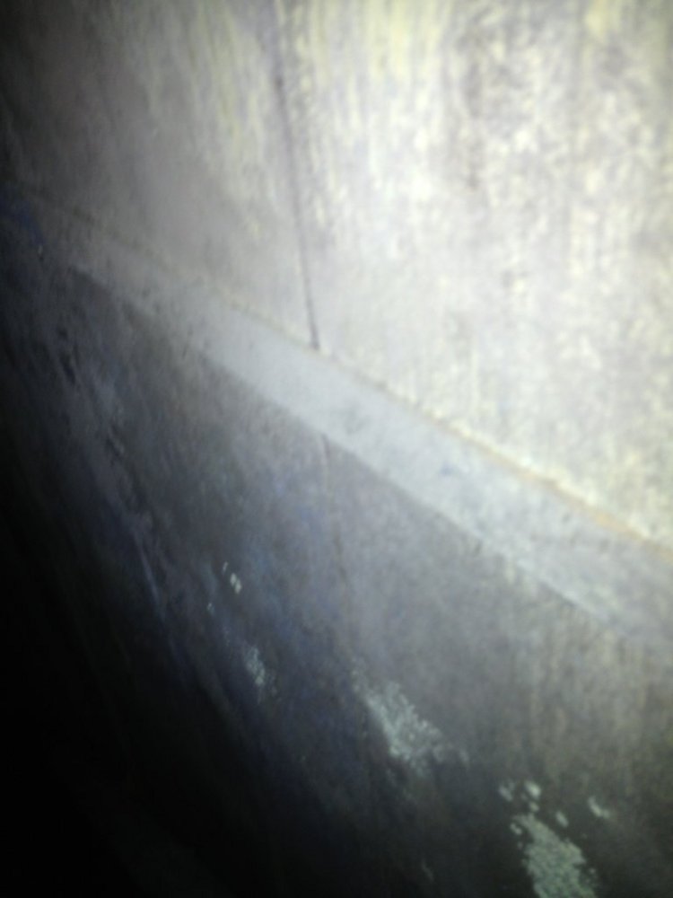

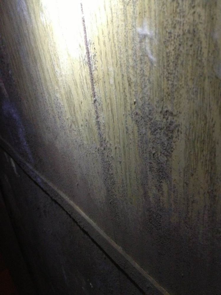

I'm glad this thread came back up because I'm gonna brag a little about what I've been up to. Our house was built about 12 years ago and during construction it began to rain every day. It got so bad, the floor joist in the crawl space began to mold. I had a company come out and clean everything but they didn't insist on a dehumidifier and at the time I didn't know any better. I installed a crawl space dehu later but mold had already taken back off a little. Fast forward to a couple months ago when I decided to encapsulate the crawl space. I looked at all the mold remediation products but decided to use white vinegar instead. It's amazing stuff and I'm looking for all the bang for my buck or bucks. I got a pump up sprayer and went to work. I could spray both sides of 6 floor joist before the vinegar dried. I pulled the insulation back and sprayed all that area too. After those 6 dried, I re-sprayed those same 6 and wiped each one with vinegar soaked rags. Before anyone reminds me that I should remove the old floor joist insulation and insulate the walls instead, I decided not to increase my termite infestation chances and stick with the insulation in the floor. The very little mold in the original insulation would turn black after the vinegar hit it and die. Let me say here as a disclaimer, vinegar will eat the skin right off your tender areas and cloud your vision. Salve, lotion, and eye drops were used in abundance until a full face respirator was purchased and rain suit pants were worn. Anyway, I put down virgin 12mm glossy white plastic and drilled holes every 16 inches along the walls to attach it to using the "christmas tree fasteners". I drilled each hole 8 inches from the top of the block. This allowed me to have a 2 inch flap of loose plastic above the fasteners to use caulk to seal the plastic to the walls. I wanted to use radon approved caulk but the supply had dried up so I used some other grey caulk. I would have used double sided butyl tape but that would have increased my cost by about $400 and I drive a Ford and a Jeep so I don't have money to burn. I installed a Aprilaire dehu and plumbed the pump to an outside drain line. I got the 12 mil vapor barrier and dehu from Crawl Space Ninja's and everything is working perfectly. I even plumbed in the old dehu that Mac5005 suggested I buy. (Sorry I'm not cool enough to know how to link that to you.) It was quite a job for an old fat guy with 2 torn rotators and 2 missing ACL's. Oh and the hemmoroids were burned off from sitting in the vinegar so that's a plus.

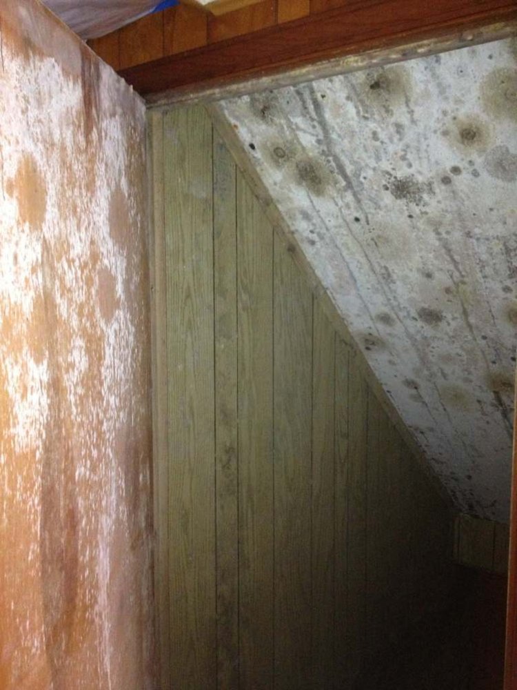

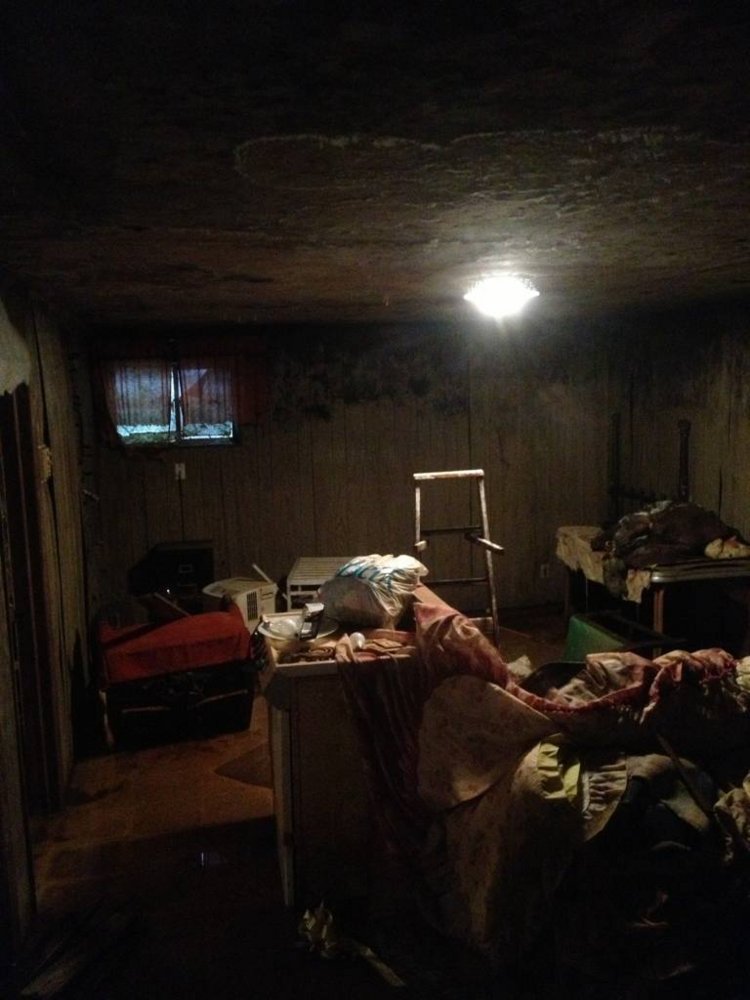

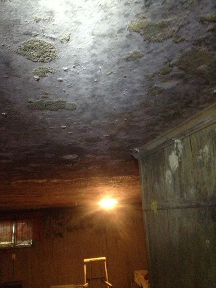

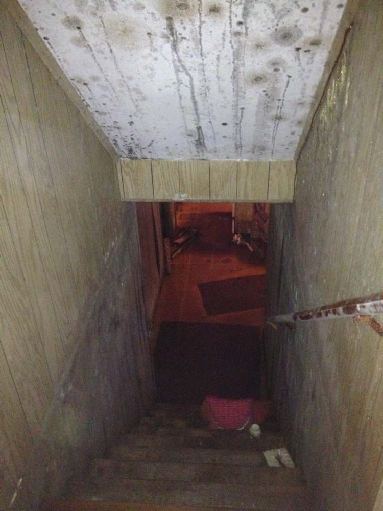

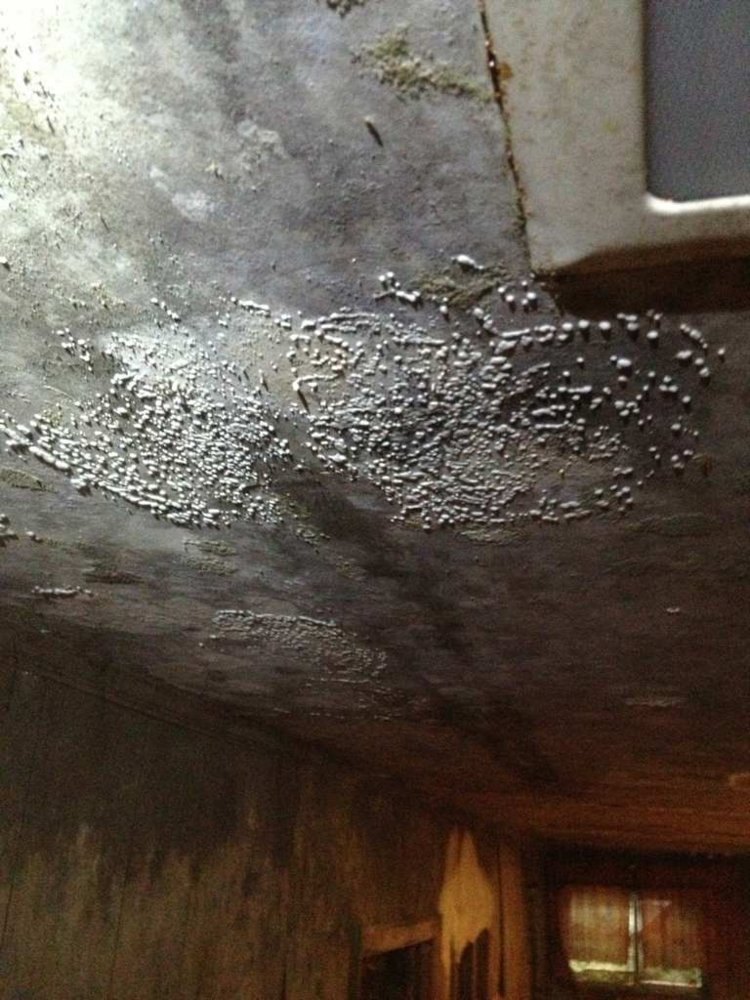

So some of you know I do disaster clean up for AdvantaClean. Today I seen the worst flood/mold problem I've seen so far. This house belonged to the current owners parents who died back in October. The house sat vacant and no one went there from the beginning of November to just last week. The basement had flooded due to the pipe from the well to the pressure tank bursting, and the sump pump not working. The lady said "we've always had some water and a little bit of mold but never like this". The water line can be seen in the pictures. The water was up to the windows, everything was floating and the water is estimated to have been there since late November to when it was pumped out last week. I could only go to the bottom of the stairs since water was still 5" deep thru the whole basement. These are the only pics I got but will add more in the morning as we are pumping the rest out right now. Rain water is also coming thru the foundation so that's why there is another 5" even though it was pumped out last week.
This is what I found when I opened the door to the basement.
Note the water line
The curtains in the window looked like they were cut straight across but that's the water line. That's some nasty water!
Check out the door to the left in the lower center of the picture. There is another door adjacent that has mold growing downward from the top of the door frame!
That's all I got, I can't wait to add more pictures when I get in there to get my crew started in the morning. Glad I'm paid well and don't have to do the bulk of the work or else I may be looking for work, this place is gross!
