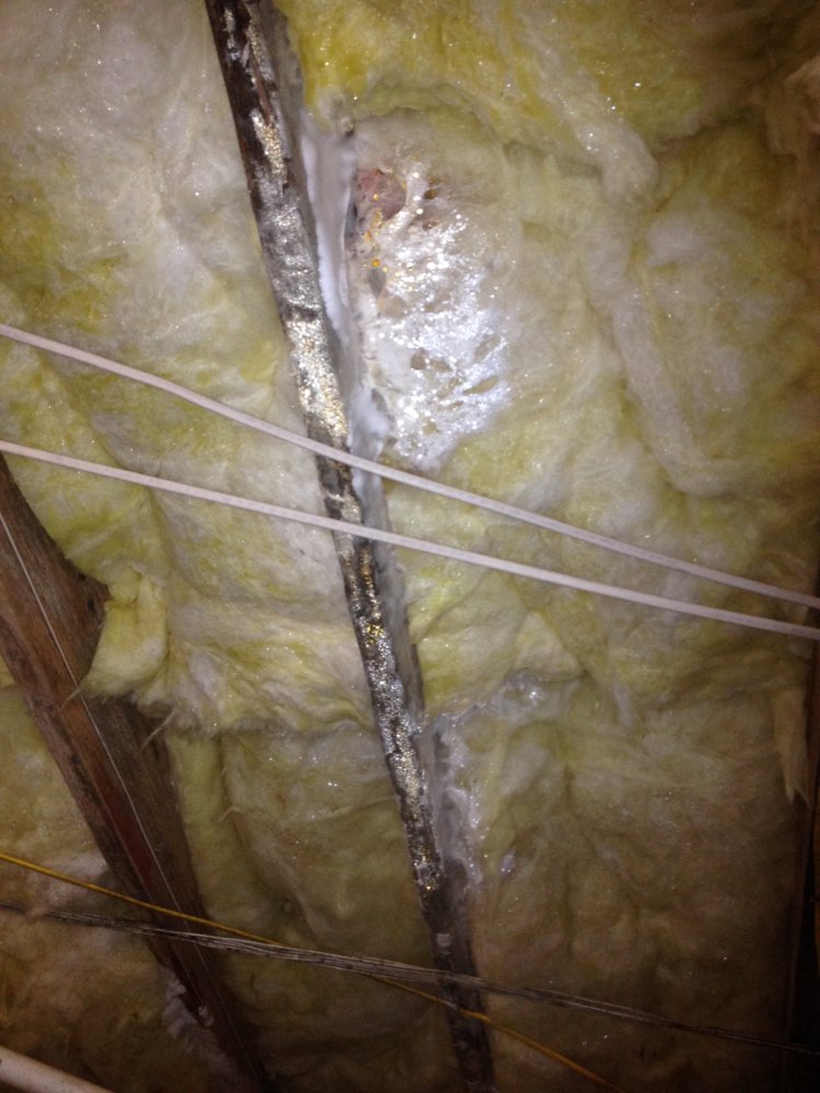

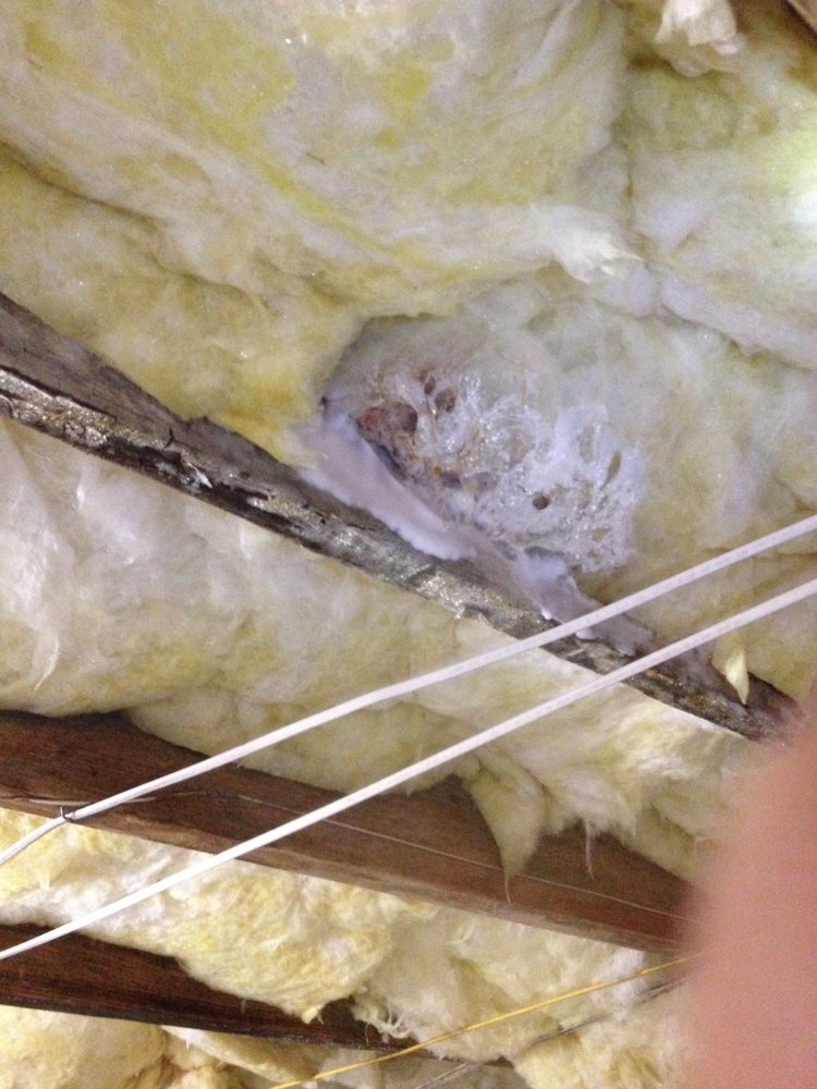

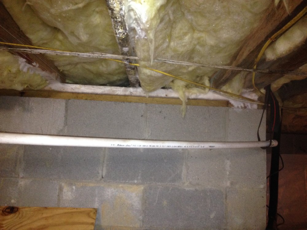

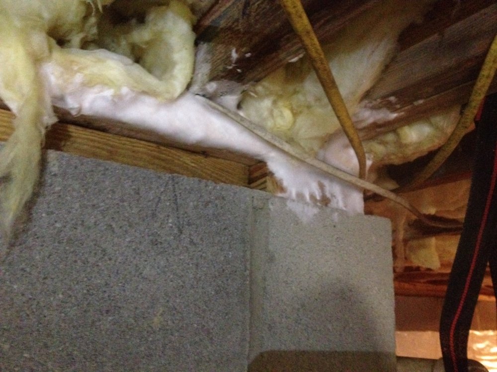

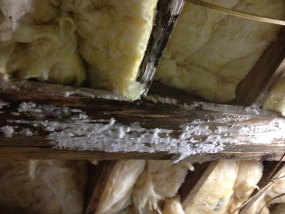

here are a few pics from a job we worked on not too long ago. That white fluffy mold typically has veins in it and can transport moisture from the source to edges of the colony where the hyphae are growing and expanding. These images show a good representation of those veins, and the expansion onto the fiberglass insulation off the floor joist.

There were lots of veins in this stuff today. It took a lot to get them off the block walls, amazing how rooted it was.

Looks like something from the movie Aliens!

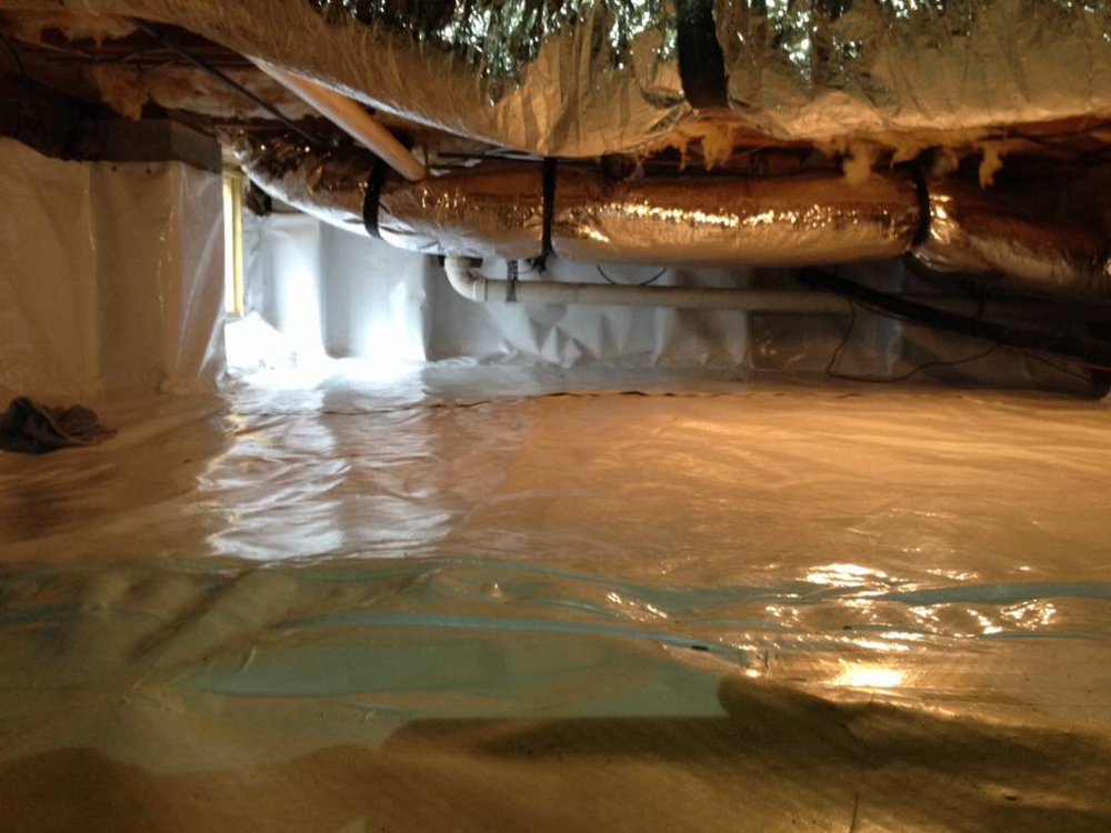

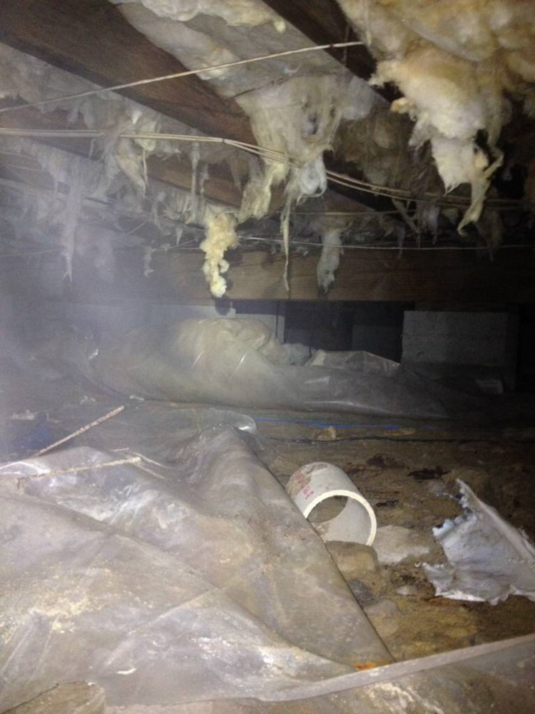

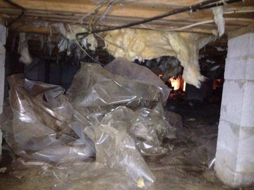

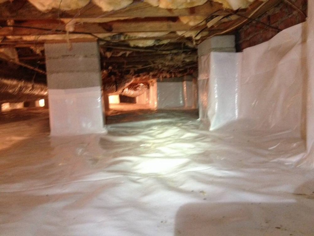

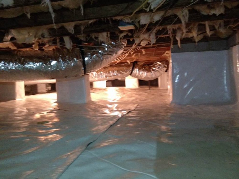

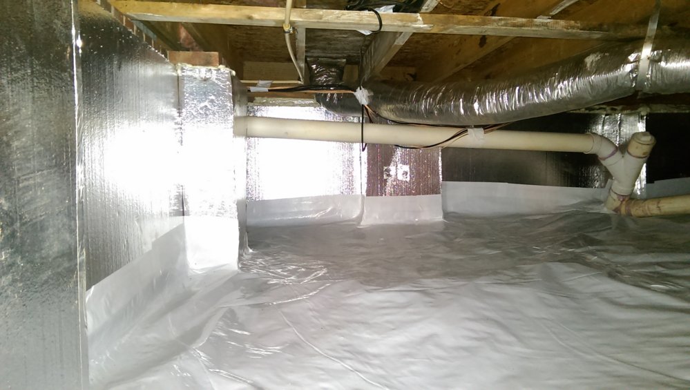

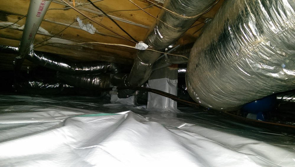

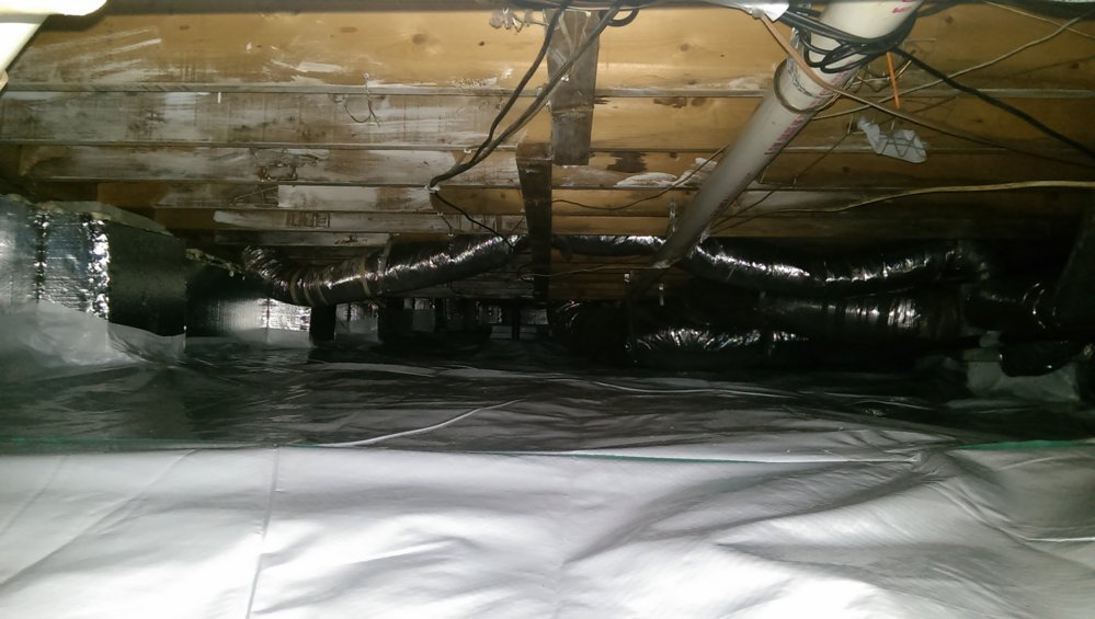

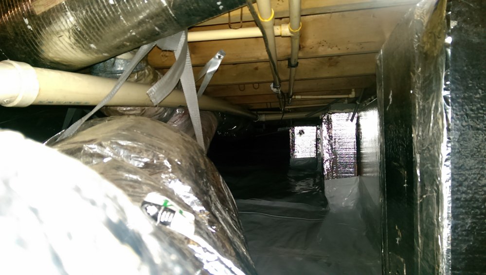

Here are a few from a recent job that really kicked my butt. Tons of trash, debris, water, cat poop. We really had to work and keep after it to polish this one.
Before
After
That looks like my before and afters, but I will say it's the best improvement I have done to my home so far. Plus its nice that anytime I have to go under the house its all nice and clean

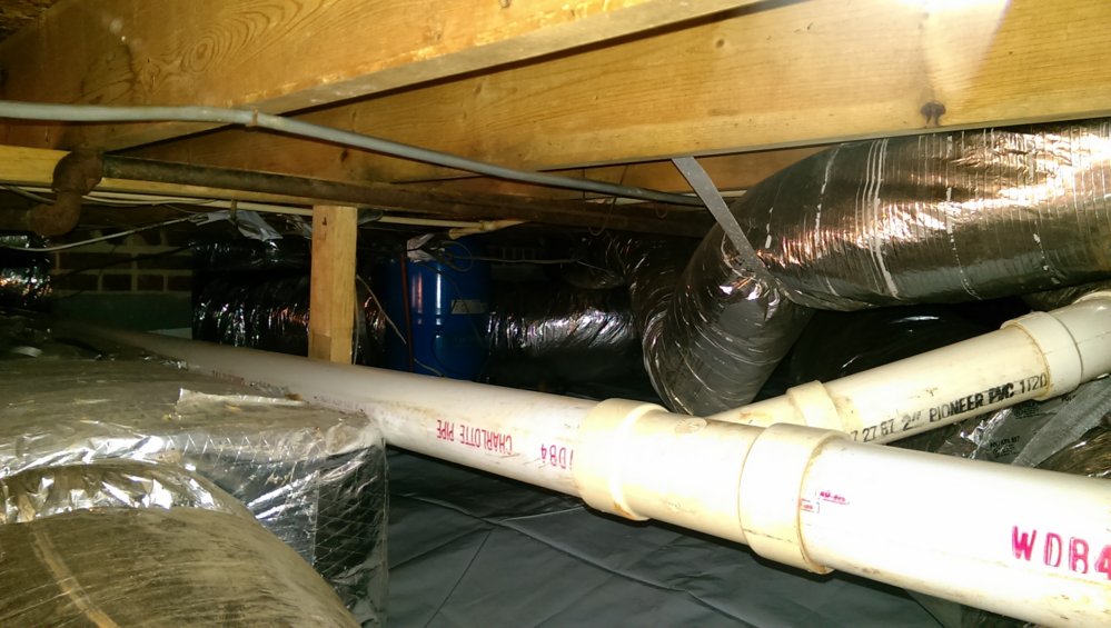

I didnt do a dehumidifier either, my HVAC unit is under the house and it dropped the humidity fast. I was told I may need to put a damper in and let more air in but I think my system leaks enough to handle it
