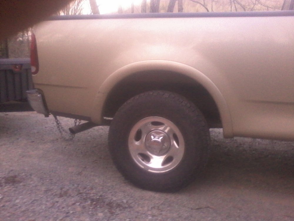

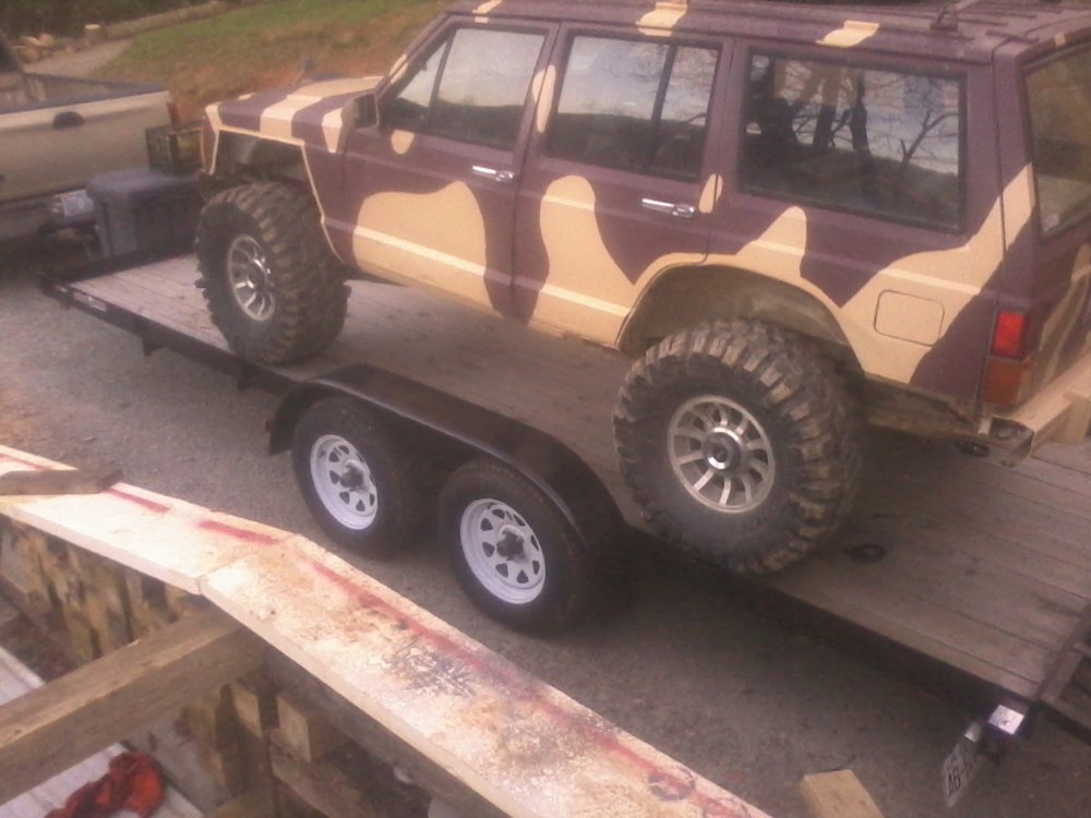

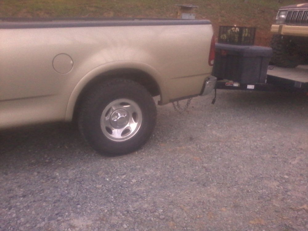

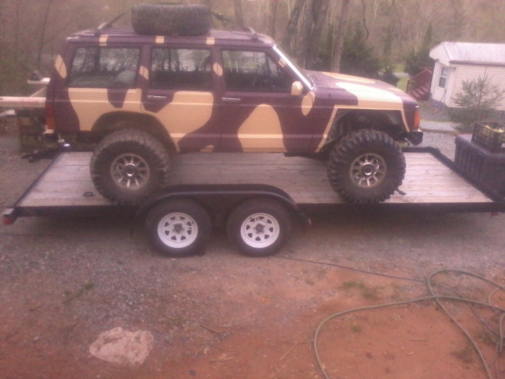

ok so i rehooked up trailer, got my straps from a friend and ready to load and strap it down. how do i look now: i positioned it back right at a Foot towards the rear which does seem to sit better on truck sag:the driveway tilts left a little so DS rear is sagged a little more because of that.

BTW, those axles aren't rated for 12,000. Those are a pair of 3500# trailer axles. Be safe and take your time.

will do. so the positioning of the jeep looks better i guess since no reply to that...if so that's great. i'll strap her down and ready to roll. slow and easy is my motto on and off the road!!LOL thank you. and yeah i don't know nothing about nothing on trailers but at least this is a good trailer for me to use for now until i get mine ready. gotta admit...this thing is freaking heavy and big...like way to big for my needs. when i'm done with mine, it will be WAY easier to pull than this big house he he. even empty i can feel it behind the truck...my trailer behind the jeep couldn't tell it was back there at all.
That trailer is a 2200# trailer on a set of 3500# axles. Your XJ weighs probably 4000# with you and your wife inside.
7000-2200-4000= 800# leftover useable safe capacity.
That is an ideal trailer for your needs John.

So looking at the picture there, I noticed a D-ring looking thing behind the jeep on the wood. How is it attached to the wood?
theyre bolted through the angle iron on the trailer and then through the wood but on the bottom there is a extra flat steel plate for the other bolts....i didn't like that setup so i just strapped it to the corner bracket thingies that are all over the trailer every 3ft or so...they are way more solid than the D-rings on this trailer and 1/4" thick. i got five straps on it so it aint going nowhere. see you later guys...heading out soon as bus shows up at 3.
