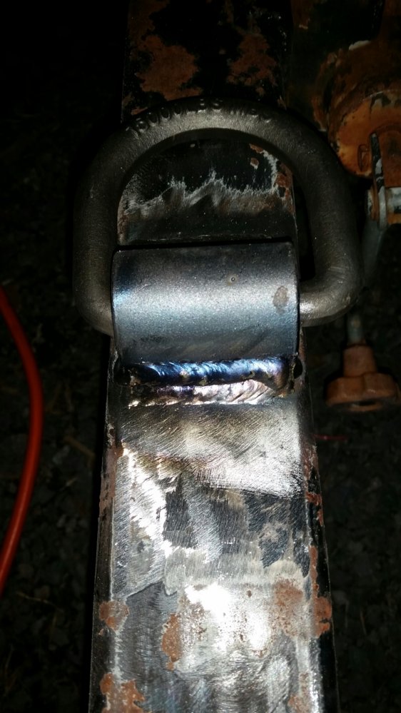

@John Fuller look at this D-ring weld and tell me what you think....
well if i had to guess it doesn't look too proper but please don't bash me if i'm wrong cause i'm really not able to tell very well from the look of welds. some i guess i can but the realm of welding and pictures of it are far from my knowledge. i do what i can but any serious welding i've always taken to others. i taught myself back 7 years ago with flux and just stuck with it and have learned and gotten better over years but i actually don't know squat about it as far as the math/metalurgy/finesse/or proper ediquette for it. i know what i can weld for sure and holds up but things i don't trust i have others do.
Fare enough, what would you say is wrong with the weld (there is a problem with it)
well to me it looks like the bead that actually seals/seats in the d-link is so small with not much penetration and the second bead they ran is on top of the bead and the D-link but not even touching the piece that it's attached to therefor making the second bead pointless??? am i close. that's what i see anyways.

look at the top weld you will see it is undercut, so the voltage is to high. You want to clean your weld before the next pass but not grind! since the D- rig is what will keep from killing someone, you may want to get some help and maybe a bigger welder.
We will let some other people critique the above weld, this will help you to see what need or does not need to be done. There is alot more to welding then just laying down a bead!!....voltage, wire speed, shielding, tip angle, tip distance. ....ect...
