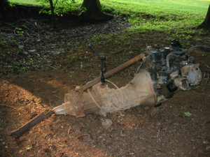

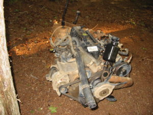

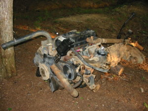

I had a pretty good day today. My only real goal was to get the old engine/tranny/tc out, and organize some of the stuff I took off the Jeep. Hopefully, after the project is finished I can sell some of it. As the photos show, I took the whole assembly out at once. I hadn't used that old "swing set" for about 20 years, but it worked just as well today as it did back then... and I did too. :driver:

A few more of the engine pull...

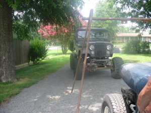

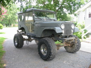

These are probably the last photos that Old Granny will ever pose for in one piece... and yeah I do have feelings about it. I am preparing to pull the battery, drain the coolant, and start removing wires, hoses, driveshafts, etc. By evening I hope to be ready to lift the drivetrain out.

Granny was a fine piece of old iron! She will be missed and remembered fondly :driver:

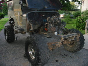

Everything is unhooked and out of the way. Tomorrow it comes out.

The main reason... Granny's frame is badly cracked in multiple places, and I found even more cracks yesterday after pulling the front sheet metal off. The frame is beyond any further patching. Other reasons include a little more room, easier passenger access, better ride, and a few creature comforts that would have been next to impossible with an old CJ-5. Hope that makes sense to someone other than just me. :)
