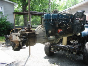

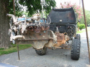

I got Old Granny's engine/drivetrain out today, and got the engine-side adapter plates made for the motor mounts. All I have today is a couple shots of the beast hanging in the air.

Don a couple of questions(none about the swingset)
Staying with the carb or going Fuel injection or propane?
Any deeper on the axle gears?
What are your plans with what's left of Granny?
Are you gonna go with a new wiring harness or graft into the one on the YJ?
cage plans?

The carb will stay until I get everything hooked up and the bugs worked out. Then, if all is satisfactory a DUI ignition will replace the stock system, and a Howell injection will replace the carb.
Axle gears: I'm thinking no more for the time being. I'm pretty happy with what I have as I feel it's a perfect setup for trail riding... which is still my preferred cup-o-tea. This is subject to change.
Granny's body/sheetmetal is up for grabs (first come/first served). CJWalt has already inquired about it, but I have not heard back from him.
I'm going to try to use the Wrangler dash & gauges. I think I have most of it figured out. If for whatever reason that fails, I may try to find a blank CJ dash and go back to CJ gauges. This is also subject to change.
Full cage with option to lay the windshield down. I have a good friend who has a shop in Concord. I will most likely leave the cage work to him. If, for whatever reason, he can't do it I will go down the road to MarsFab.

I'm going to attempt to get the motor set today, and get the mounts welded in. Gonna be hot, but I will be in the shade most of the time. More later............

For the past two days I have been working relentlessly on setting the engine in place, and I had to fabricate mounts from scratch. I hope to finish up the mounts and get them welded in tomorrow. Also, during the process, I have installed one inch of body lift which appears to be allowing everything to fit nicely. All indications are that with a few modifications I will be able to use the stock belly pan. If all goes well tomorrow maybe I will have a few more pics.
