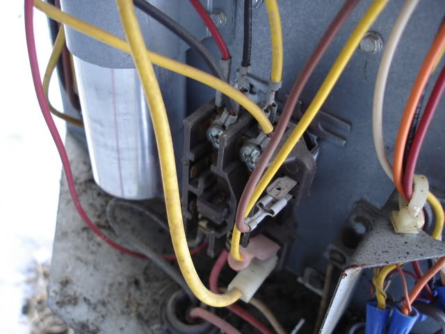

Most heat pumps have a gizmo called a contactor that works much like a starter relay. They are the most common failure part and east to replace and test. When you turn on the thermostat it should have power on both sides.

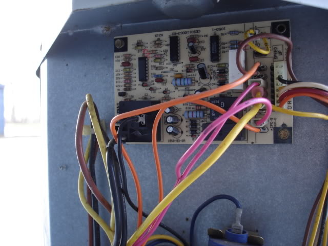

Could you be a little more specific here? I may know what you're talking about, I took the cover off the unit and I can press this piece down(sorry for the lack of correct word usage here) and the fan will come on. It's a little metal piece with a spring in the middle and as I push it down it makes contact between the two circuits and the fan cuts on but I don't know if that's only for the fan or what. Is that what you're talking about? If so it doesn't look like this piece is made to stay down, looks like it's meant for test or something. I'll go snap a picture....
Thanks for the help!

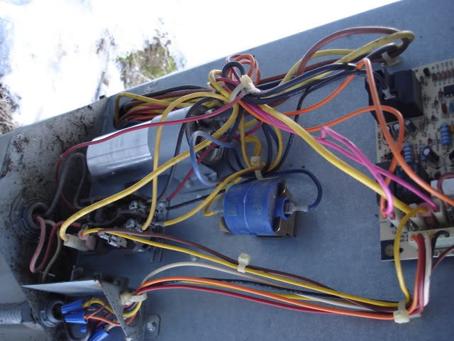

Okay, here is what I've got. The first picture, in the middle of the black/brownish piece there is a little plastic piece with a spring in the middle, that's what I can press for the fan to cut on.... The other pictures just show the other electronics that I have there.... Any of those looks like what you're talking about?
I ge the DVM out and check the voltage going into the unit.....It would be a good starting point
