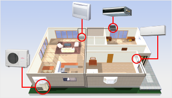

Concealed, ducted, multizone VRF FTMFW
http://www.daikinac.com/content/assets/DOC/Product Brochures/CB-VRVIV-S-05-16.pdf
MVZ Multi-Position Air Handler Rounds Out Diamond Comfort System™ for Efficient, Whole-Home Cooling, Heating
Airstage™ (VRF Systems) : Duct - FUJITSU GENERAL GLOBAL & Multi Split Systems (Air Conditioner) - FUJITSU GENERAL
LG Home Comfort Solutions - HVAC Air Conditioning Solutions for Homeowners and Residential Applications & Multi Zone Indoor Units for Multiple Room Air Conditioning in Residential & Light Commercial
