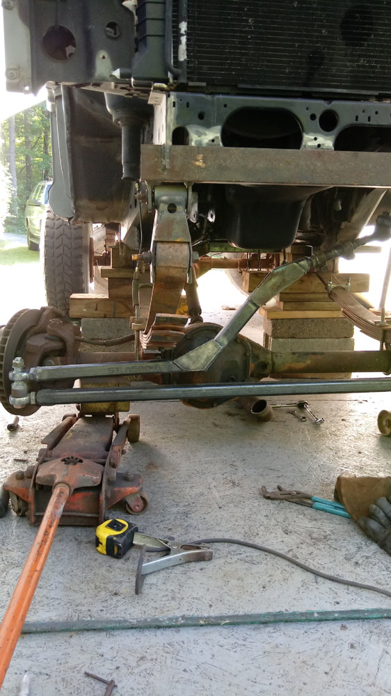

Lets be honest here.
That front cross-brace/spring mount/chassis bar will break before any of this steering does.
The entire front suspension is mounted to a piece of angle with minimal attachment. I think under a duress braking manuever his doors might pass his front axle
Y'all thought death wobble was bad.... better hope Hey-Zeus takes the wheel
That's some cobbled up shit. However, "IF" The welds are worth a shit those gusset plates will keep it from breaking/bending. I would be more concerned with that little ass ball joint at the steering box. Looks maxed out now, wait till there is axle drop.
Yea, as said. should have stayed with the coils..
Not to mentioned the box getting ripped from the "frame".
That front cross-brace/spring mount/chassis bar will break before on of this steering does.
And he did not do a rev. shackle. Which will be more stress on the piece of angle. Good eye Ron.

In that case, have at it. If this is off road only, don't worry as much about angles and alignment. You may have said that somewhere in the 10 pages, but ain't nobody got time for that. :D
Since u want another pic..here's my beautiful work of art again..LMBO

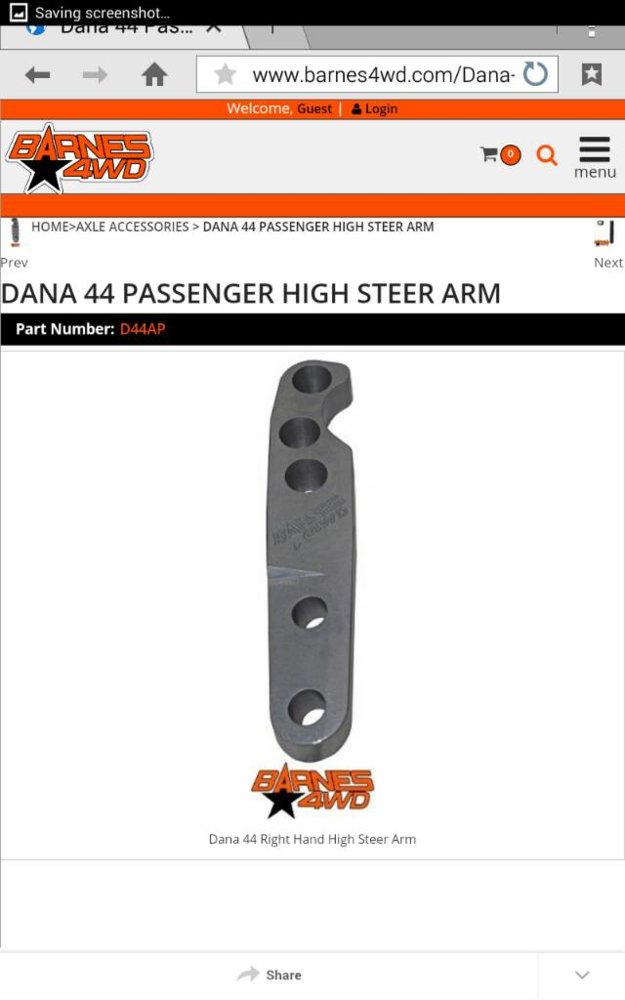

If you put this on top of that knuckle you can have a straight drag link and much better steering.
