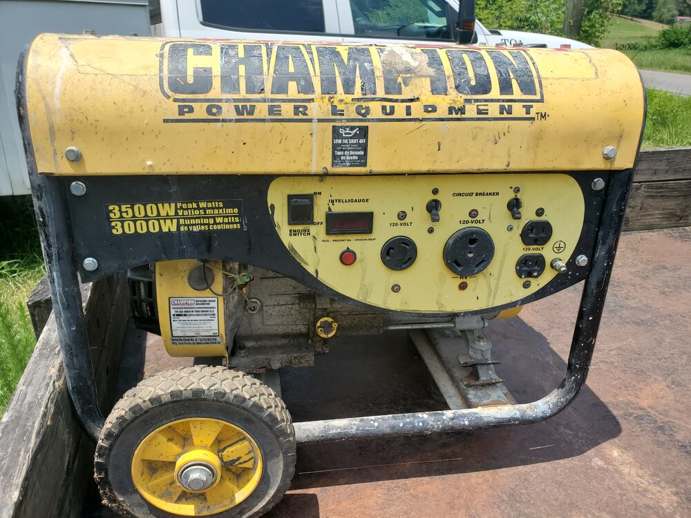

Year old thread, ik. But anybody got experience with these generators? Got a line on one, cheap. Was used, put away with a dry tank, and sat for a couple years after the guy died.
Edit: Runs fine. Puts out 124 V, 62 Hz, has 250 hrs on it. Anyone wanna guess what it'd be worth so I dont over pay?

Not knocking a deal but your not looking at anything speacial. Fairly limited output. Probably not built for noise reduction. Job site beat around tool runner....Sub 200.00 is what I'd be pressing. I am personally curious about parts availability or dry rot of hoses and such.

Well, got it for 100. So I guess that's not bad. You're correct, it's a little louder than I'd like but when I'm inside it's just a dull hum. Looks to be a typical Chinese 196 Cc engine, just with a different breather and muffler.
Sold new for 299, good little machine.
that’s a GNRC/vanguard reject engine if it’s been used a bunch a small still running it’ll be good for a while..
champion is a decent compiler. Still in business and parts aren’t a problem for it because others (bigger names) make all of it

Good to hear. Main thing is keep the fridge and chest freezer cold and phones/pager/radio going.

Order spare brushes and figure out away to keep them attached to it in case the ones in go out.
we had it happen to my dads that is similar, we were outta power for another 8 days with a running generator that wasn’t able to make power. May be a freak thing but for less than 20 bucks it don’t hurt to keep them around

fried and chest freezer together is probably pushing(exceeding) the limits of that machine. Might work but I’d both ever cycle same time it won’t.
Phone chargers radios etc are inconsequential.
Ok, so would need to run one at a time.
Edit: tested this today. It will start both compressors, but definitely all it wants. Otherwise it seems to be doing good.
