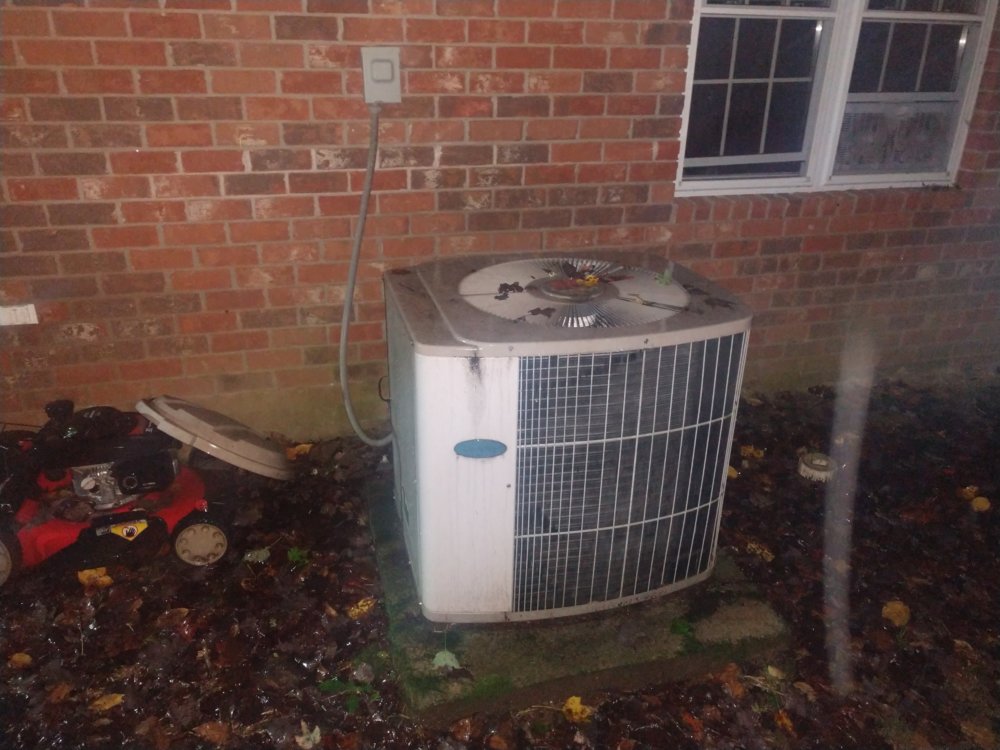

So what was replaced just the outdoor unit and not the air handler?
A heat pump and a/c both are the outdoor unit. You have one or the other not both. Basically a heat pump is an a/c unit with a reversal valve that changes the direction of the refrigerant so you get heat inside during the winter. But in a/c mode they are the same thing.

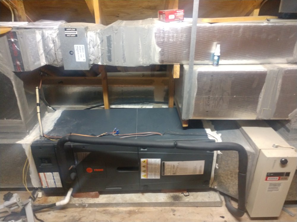

How's this? I put on my Crocs and took some pics
Old
New
Yes I would stick with Trane if not changing the indoor unit again.
Far as quality of Trane I would agree I feel like it has went down some over the last few years but still on par with everyone else. I can not say there is any brand that really just stands out as the best. They all have problems. Even new ones as said earlier the install is the most important thing for a system to last. And maintenance, keeping filters changed and coils clean.
