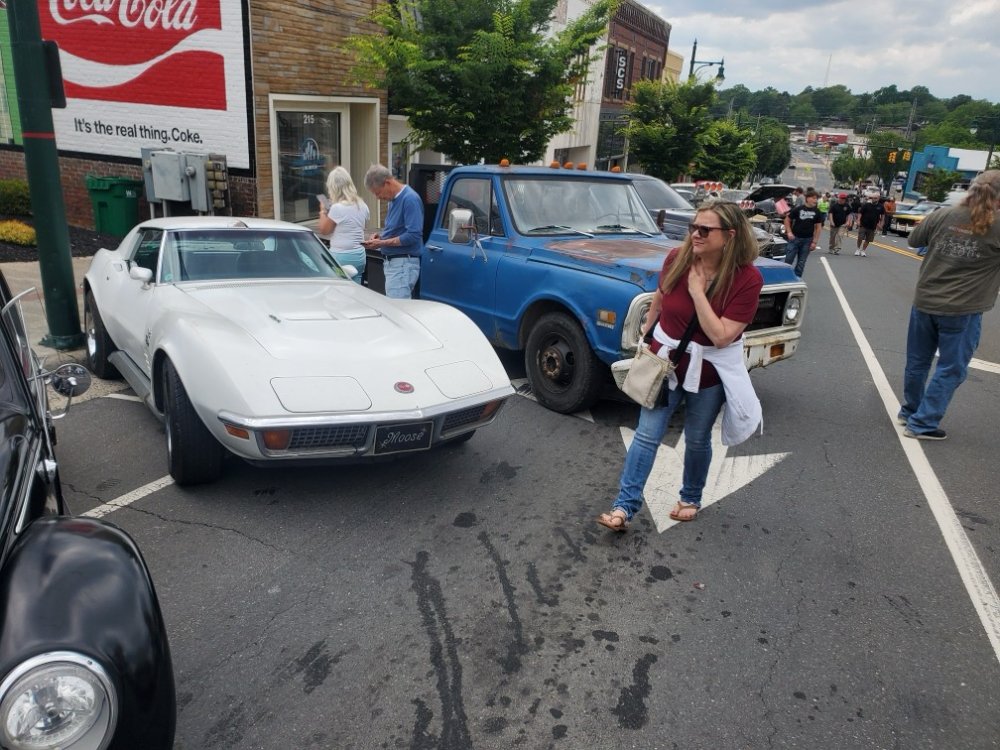

Took the C3 & C30 to a local car show Saturday. The guy in blue sold dad the Corvette in 1980 and actually has a bunch of history he paid for that he is going to give dad!

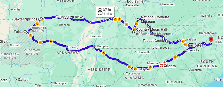

Planning the trip now...if anyone has any suggestions for places to visit and/or avoid I'm all ears!
So far the plan is to cannonball to Tulsa and road-trip/sight-see on the way back:
The day after the parade we plan to drive 50-100 miles each direction to see all the sights/Americana/tourist stops along Route66. Leaving Monday to drive all of Route66 in Kansas (13 miles), Bass Pro HQ, Corvette Museum (obviously) and tail of the dragon. I'm kind of torn on the Country Music Hall of Fame, but I've never been to Nashville.
Looks like wide open designs is on or near that route, you will also pass Graceland.
The upstairs in country music hall of fame is old country Hank Willie Watson etc, it’s worth going to, the downstairs is modern Taylor swift and crap, but I’d say it’s worth it if you stay upstairs

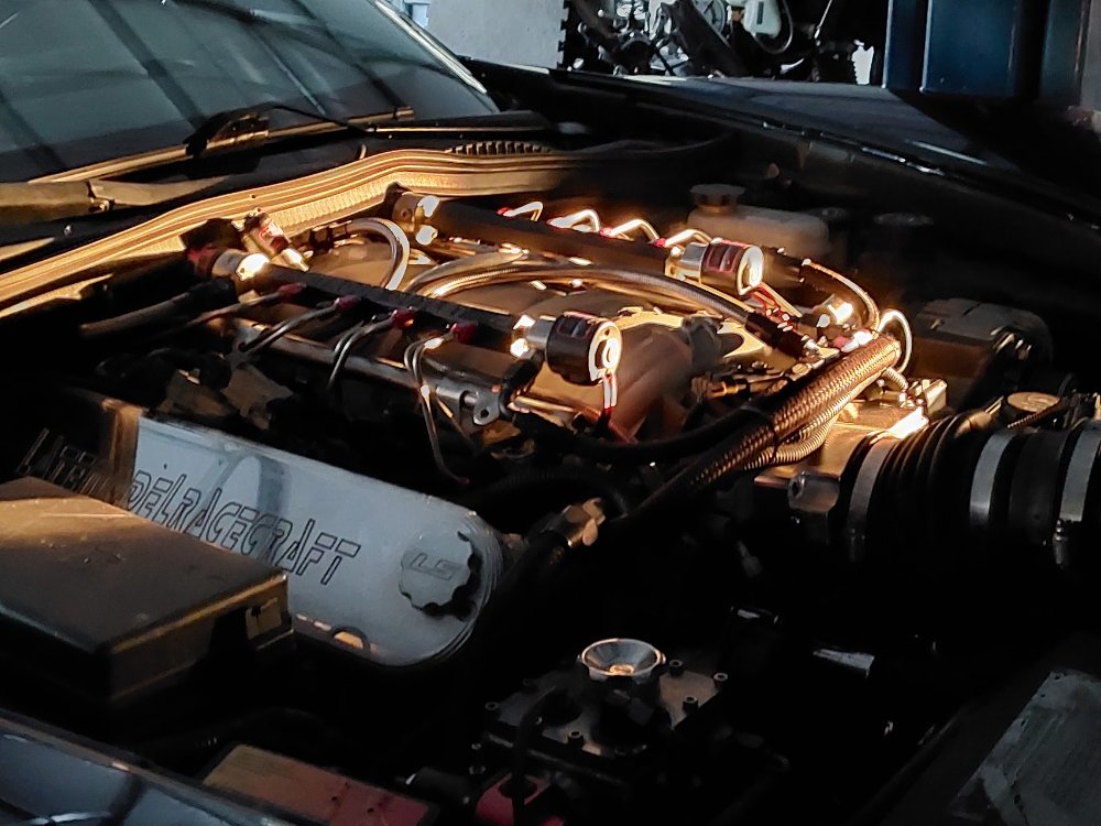

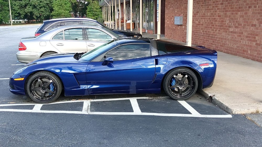

She put down 671whp on the fresh 441 build , still haven't sprayed the new motor should be a good bit over 1k whp.

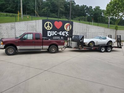

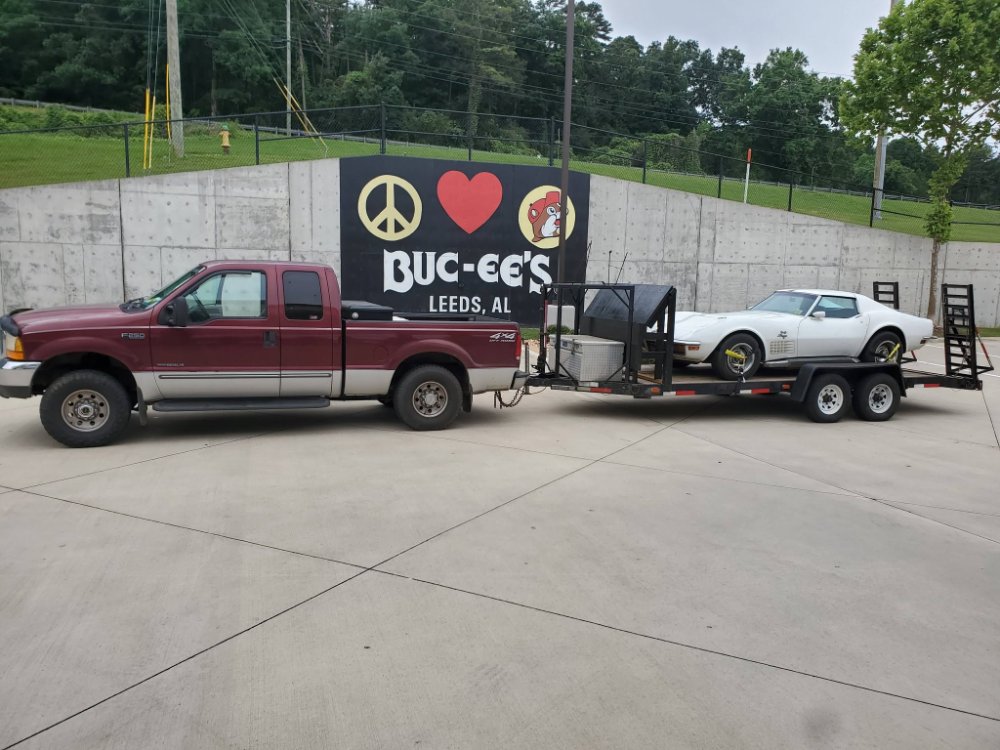

Left Albemarle on 5/26/26 @ ~9:30am with ~191k miles on the F250, topped off diesel in Locust, filled up again in Atlanta. I think it rained the entire way through Georgia! Topped off again at Buc-cee's in Leeds, Alabama because why not? Breezed through Tupelo, MS with no issues and ate dry rub ribs at Corky's in Memphis, TN. Called it a night at a Holiday Inn in Memphis and parked the F250 & C3 in a gated lot for the night.

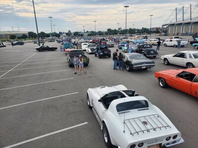

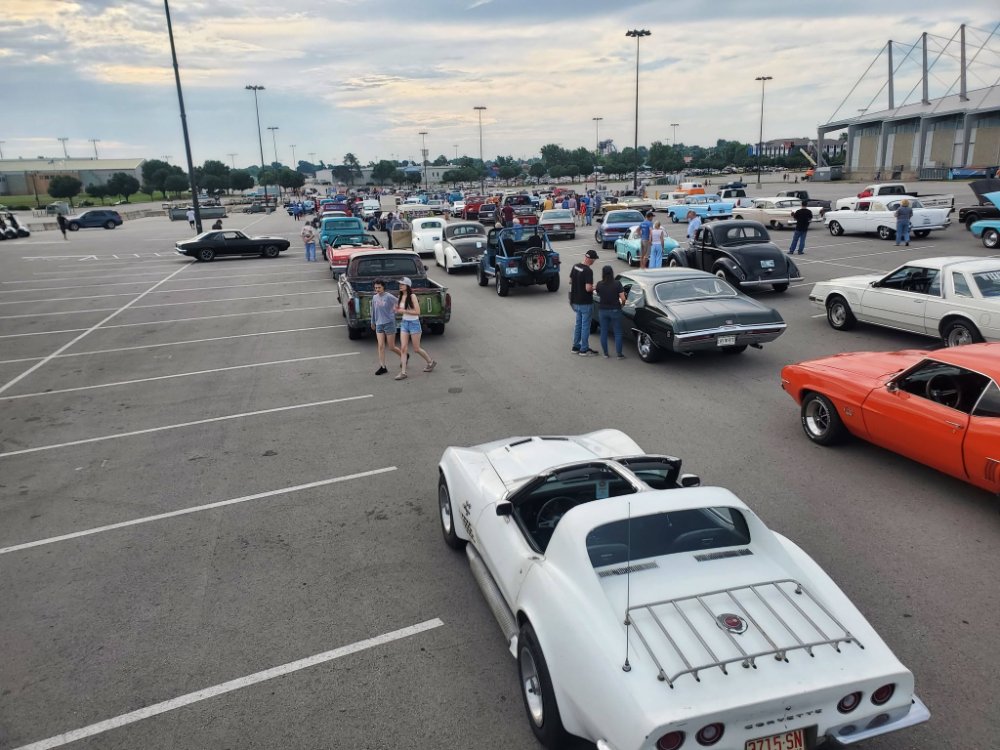

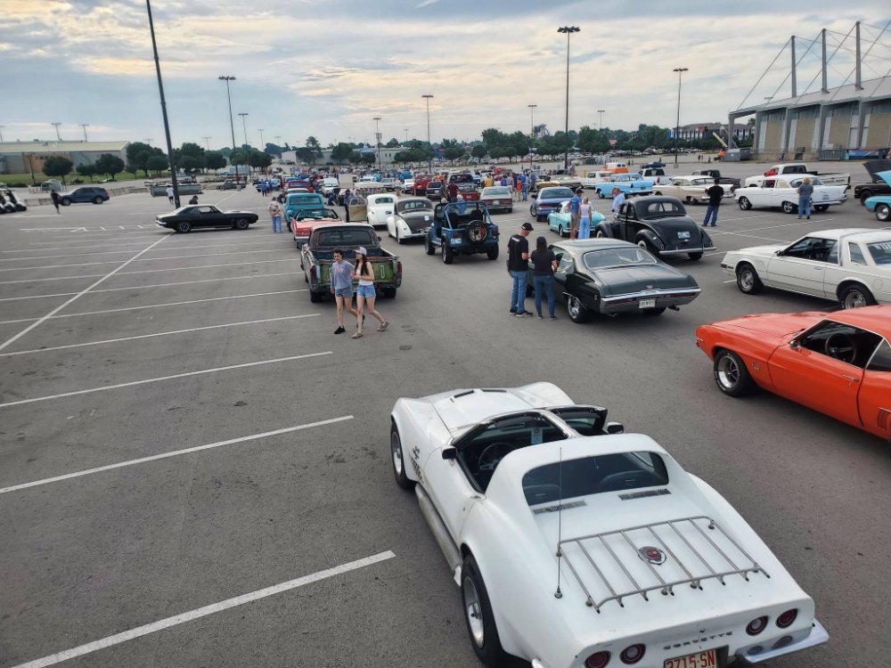

Left the hotel on Saturday around 6:30am for the Expo Square, cranked and unloaded the C3 which was running rich. Popped the hood and pulled the air intake and the carb was flooding. Dad wanted to pull the carb apart and I was going to let him do that solo so I couldn't be blamed for it not getting put together correctly. He was worried about taking it apart in a parking lot and we ended up tapping around it and it turns out it was the needle and seat being stuck open. Let it warm up and pulled into the first staging area and talked to a bunch of folks parked around us. Around 8:40am we moved up to the final staging area before driving on the street. We sat there for 5-10 minutes before entering the parade route which took ~30 minutes to drive ~6 miles. We finished the parade and parked the C3 at the hotel so we could walk to watch the rest of the parade. When we got there a police officer said they still had 2-3 hours of cars in the parade so we only stayed there for 30-45 minutes before heading back to the hotel to cool off. We then went to Lowes to get a spare key made and they couldn't make one for a GM car so we headed to a local burger place. While at Lowes a '66 Mustang had lost its mechanical fuel pump so we helped push him on this trailer so he could head back to Texas. Burgers were good and it was nice to cool back off again!

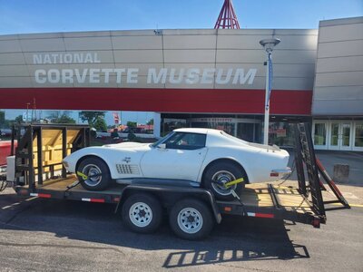

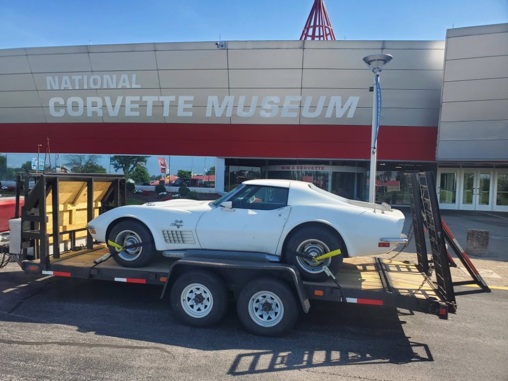

Slept in a little bit on Monday because I'm 40 now...old bones and what-not! Drove through IL to KY to tour the Corvette Musuem in Bowling Green which was awesome! We went to unload the C3 to get some pics of it at the Museum and it keeps flooding so we took some while it was on the trailer. Headed south for dad to have an apple pie old fashioned at the Dueling Grounds Distillery in Franklin, KY. While we were there we made a plan to clean the carb overnight in the hotel and head to the Tail of the Dragon with the goal to be there around lunch. We filled up at Buc-ee's in Crossville, TN, got new fuel filters at an Advance across the street, supplies from a Dollar General and called it a night at the local Hampton Inn. Progress Update - we think the original float absorbed ethanol in modern fuel which caused it to sink and swell which led to the carb flooding; we are going to try and get a new brass or plastic float tomorrow on the way to the Tail...fingers crossed!
