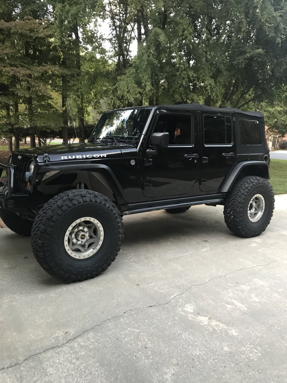

I’m on 37s / beadlocks with 5:38s. Rear 44 is stock aside from the gears. Front 44 is sleeved, Chromoly shafts, heavy duty ball joints and steering. I don’t abuse my Jeep but I also don’t shy away from things either. I’ve considered axle swap and larger tires but it does what I need it to do in its current state and can cruise the interstate with the best of them.
My point in sharing this is that in my opinion anything more than what I have warrants an axle swap. If you’re eventually gonna go that route get a Sport instead and save the money. The time between purchase and axle swap can be fun wheeling a lesser built Jeep and relying on skill.

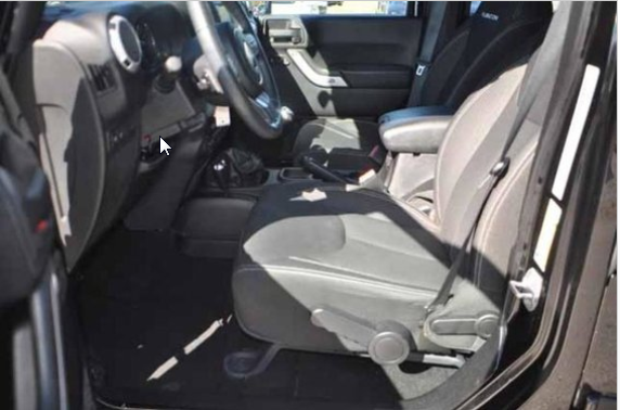

You can see the locker switches in this crappy pic:

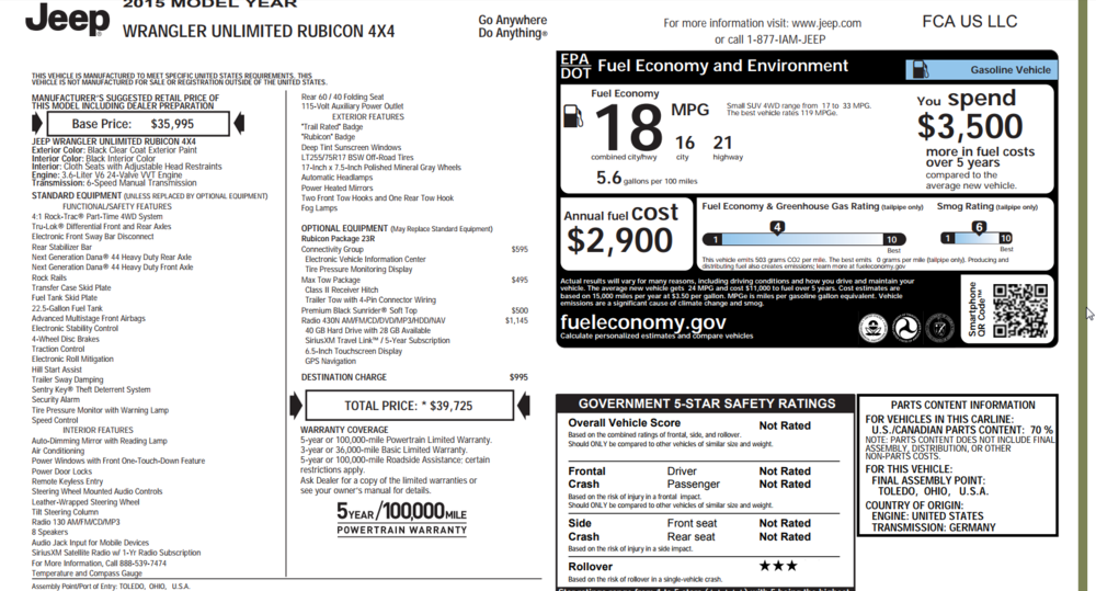

And the window sticker agrees that it's a Rubicon
So you should be good to go on the whole Rubicon thing.
