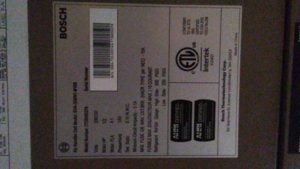

Back to HVAC... OK, the fella who installed the heat pump did install the air handler,ductwork,condenser and ran wires for both thermostats. After that he said I'm done til you get power and we start the system.
Now i'm trying to get ready for rough in inspection and I believe I'm supposed to have the wire run to main for condenser/air handler including interrupts for each. I called the hvac guy and told him I need that stuff completed. He says that's for me to do and he does not mess with high voltage only low voltage final wiring. I said well my contract says turn key...He replied well I can maybe try and help you figure it out next week...

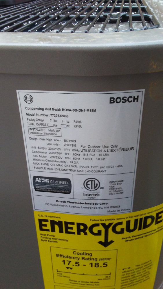

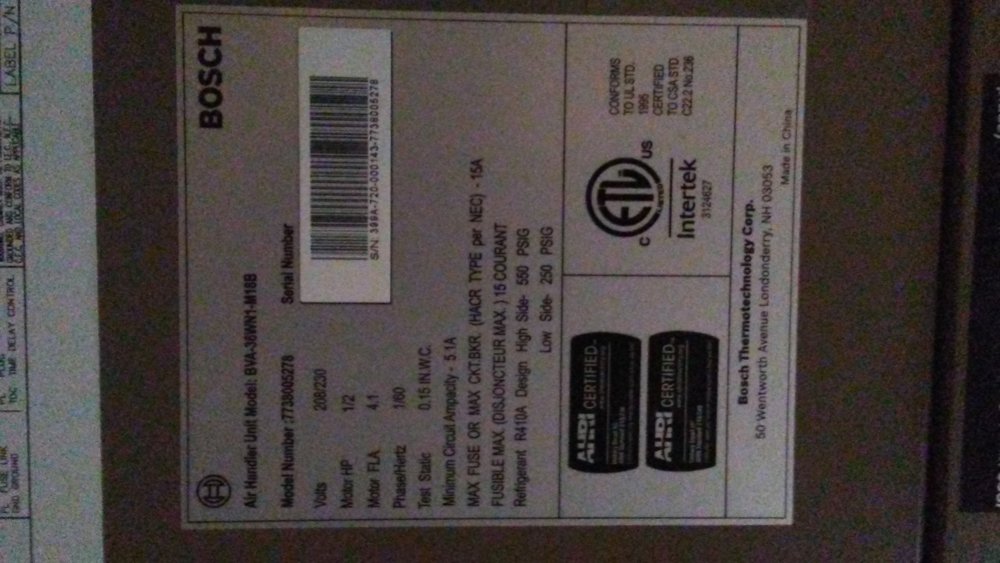

What say you guys? I can see the UL stickers on both units. Air handler says max fuse or breaker 15amp but it has 10KW heat strips. Air handler does have a 60amp breaker on the side of it. Can that be considered the interrupt if it cuts power at the unit? Condenser says max breaker 40 amp.

I’m assuming air handler has one connection for power as is normally the case, You would wire air handler and size breaker to meet the needs of the heat strips. So number 6 copper wire and a 60 amp breaker for 10kw. Ignore the 15 amp if using heat strips. If the air handler and heat strips power separately then size wire and breaker for each accordingly.
Far as outdoor unit goes I’m pretty sure by code you can size wire to the minimum circuit amps which is 24. So that would be number 10 wire. But in my mind if I’m installing a 40 amp breaker I want wire that can handle 40amps. So that would mean number 8. The breaker is little larger to handle inrush amps of compressor on start up but once it’s running continuous amps will be less than the minimum circuit amps.
