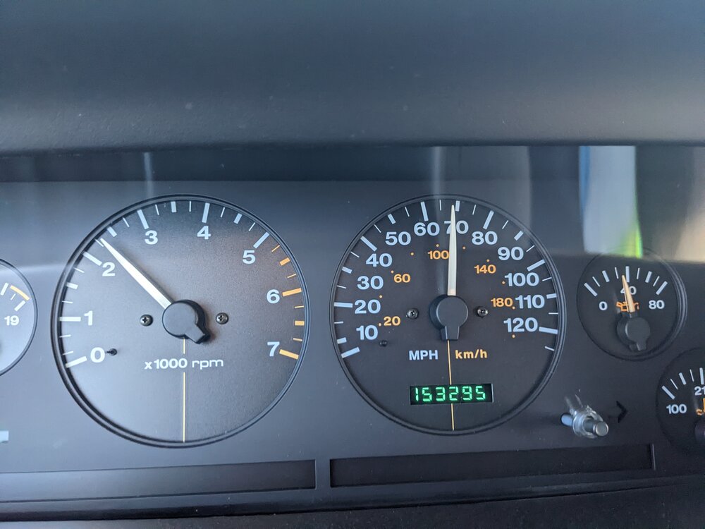

Finally had a day at work that wasn't insane and took it for a spin with the new Tom Woods 2.5" diameter rear shaft...fixed it!
At around 58-60 there's a minute amount of vibration, but you'd be picky to detect it. All the way to 70 it's super smooth.

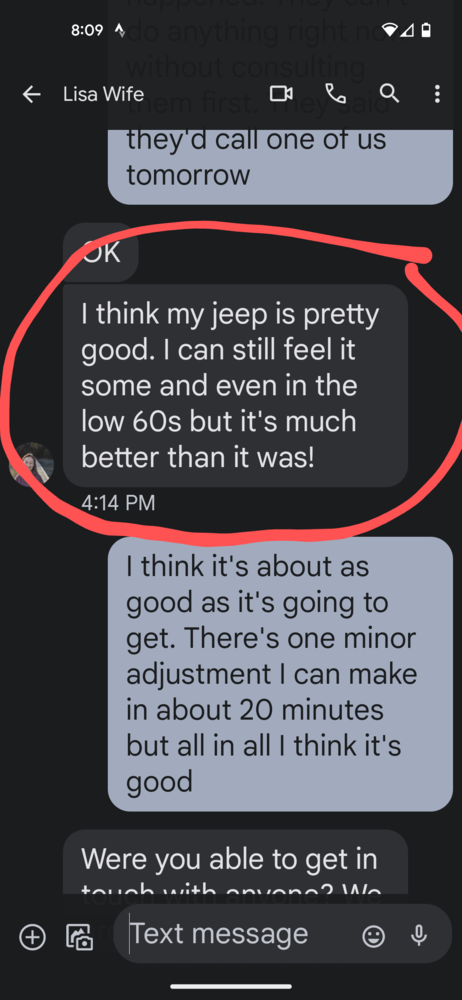

But I'm not the judge and jury, my wife is. She drove it home and reported back:
Thank God it's finally driveable. I really can't say enough good things about Tom Woods in this scenario. They blindly sent me a second shaft when the original one was fine (by the build sheet). I'll take up a refund with my local shop this week.
