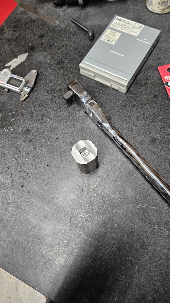

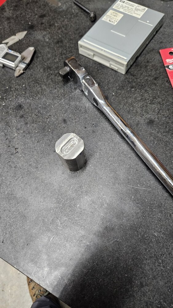

I mean I weren't joking a couple weeks ago, this is the socket out of 4140ph. The oval is just wider since don't know where the sharp corners are on the part. It's 12.89mm between the flats.
