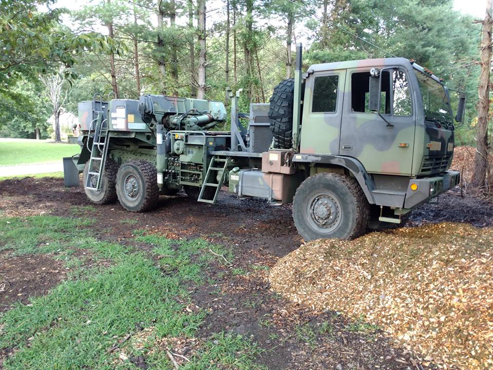

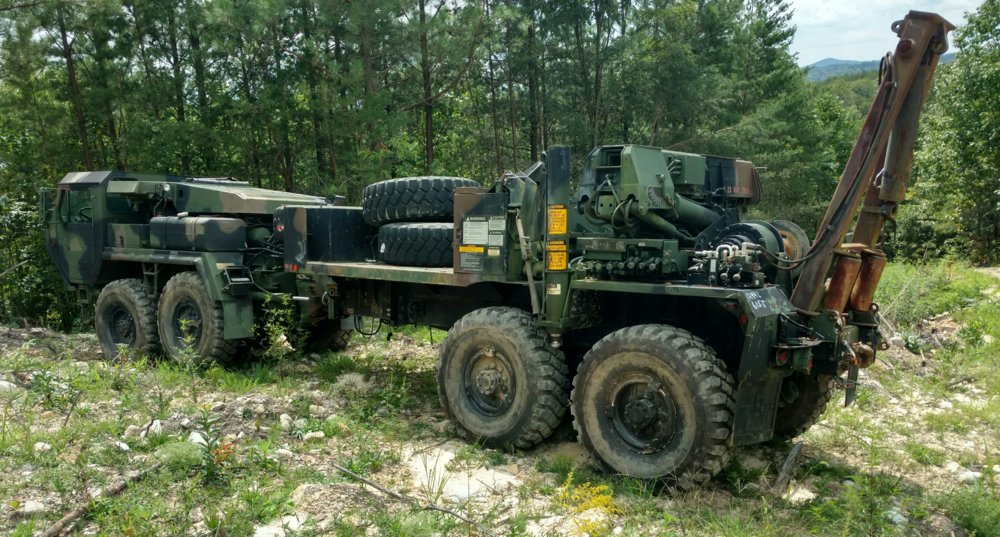

You have to know Michael to know what he means by "both rears"
