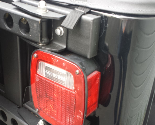

I've got a set of corner guards now I need to install, and I want to install them UNDER my Exogate tire mount. The exogate comes with a 1" spacer for the hinge side on the body to extend it the same amount as the frame on the tailgate.
So to delete the exogate spacer and still be the same thickness as the tailgate, I need a 7/8" (technically a 13/16") poly or aluminum or steel spacer to go under the hinge now after mounting the corners.

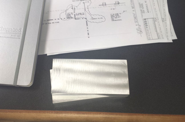

Well, I just saw this and looks like you already have it taken care of. I could hook you up no problem, and I'm right down the road from you. Let me know the size and the bolt hole locations and I can fix you up. I could do aluminum.

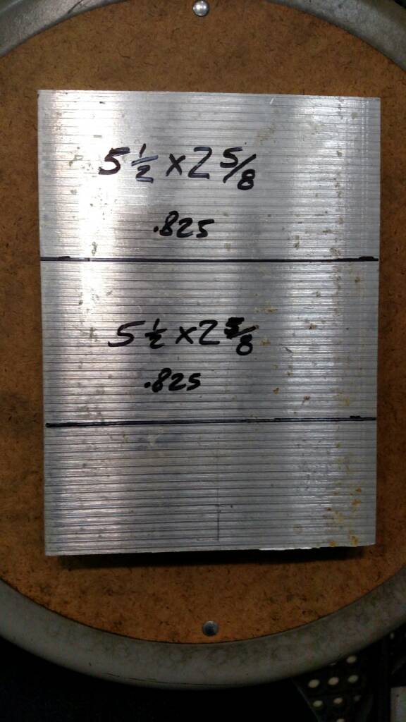

Joe just hooked me up with some custom cut aluminum pieces and brought them TO me!!
Thanks Joe! You are the man! I owe this guy a bottle of good stuff for sure!
No problem dude, that's one of the perks of being in the club lol. Just figured since I talked ya into getting those corner guards out of my way in the garage the least I could do is help you get them on your Jeep.
Hope they are thick enough for you, I had a guy saw them out for me and he flubbed up the first one, so I had to find another piece and it was a few thousandths thinner. So I made them the same on the mill.
