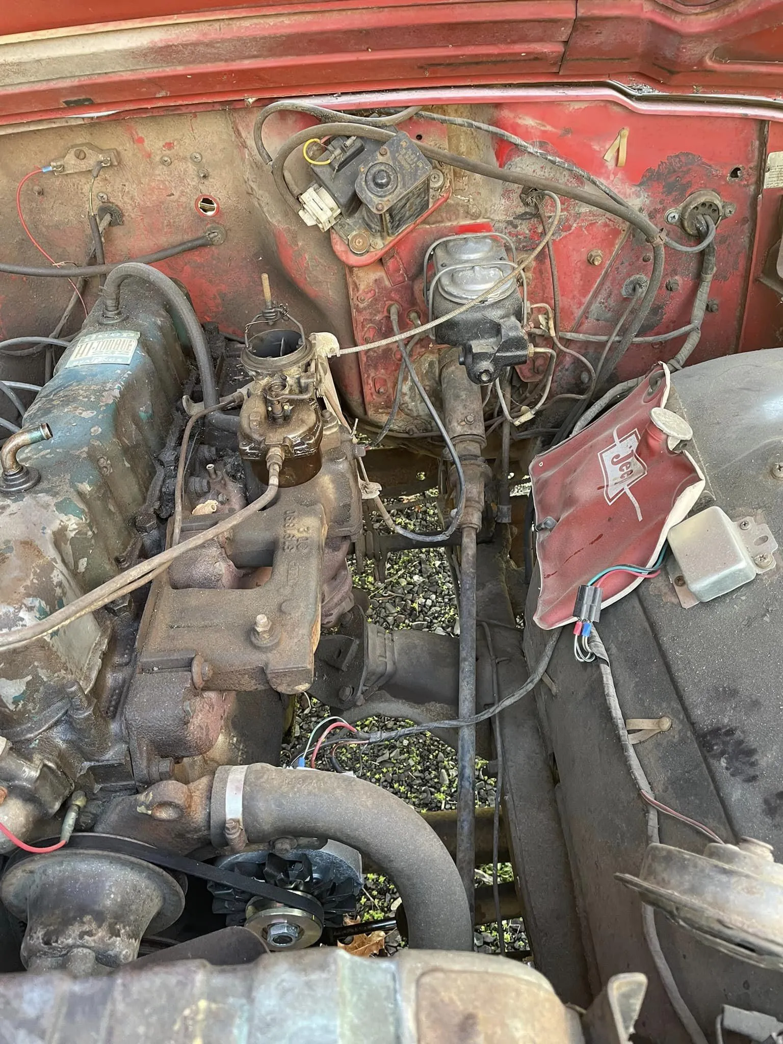

A friend of mine (really good kid) has purchased his first project vehicle: 1969 J2000 67,000 original 232
He wants to get it running again but doesn't know if rebuild kits are available for that carb.

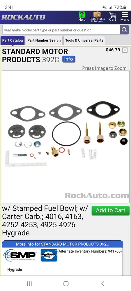

Rockauto shows a rebuild kit.
it may also be the case that the spring width is the same as chevy. May be able to dump some cheap 10 bolts in it.

If that 232 can accept the same adapter plate as the 258, a MC2100/2150 might be a better solution. You can buy new on Amazon all day for less than $100. Just have to make sure to get one with 1.08 venturis
Pretty sure he would have to swap to the '80 and newer intake manifold that was for a 2 bbl setup since the '70 and prior were singe bbl.

BUT call my friend Johnathon at Jeepsterman Rated #1 Source For Willys Jeep Restoration Parts | The Jeepster Man | Jeepster Man Inc and he can fix him up with parts that will work. Drum brakes can be rebuilt and used, he could go with a slightly taller skinny tire and it would be baddass. Rebuild carb as Jody said and drive the damned thing.

I would just rebuild the drum brakes, and rebuild the carb to get it running, driving, and safe.
