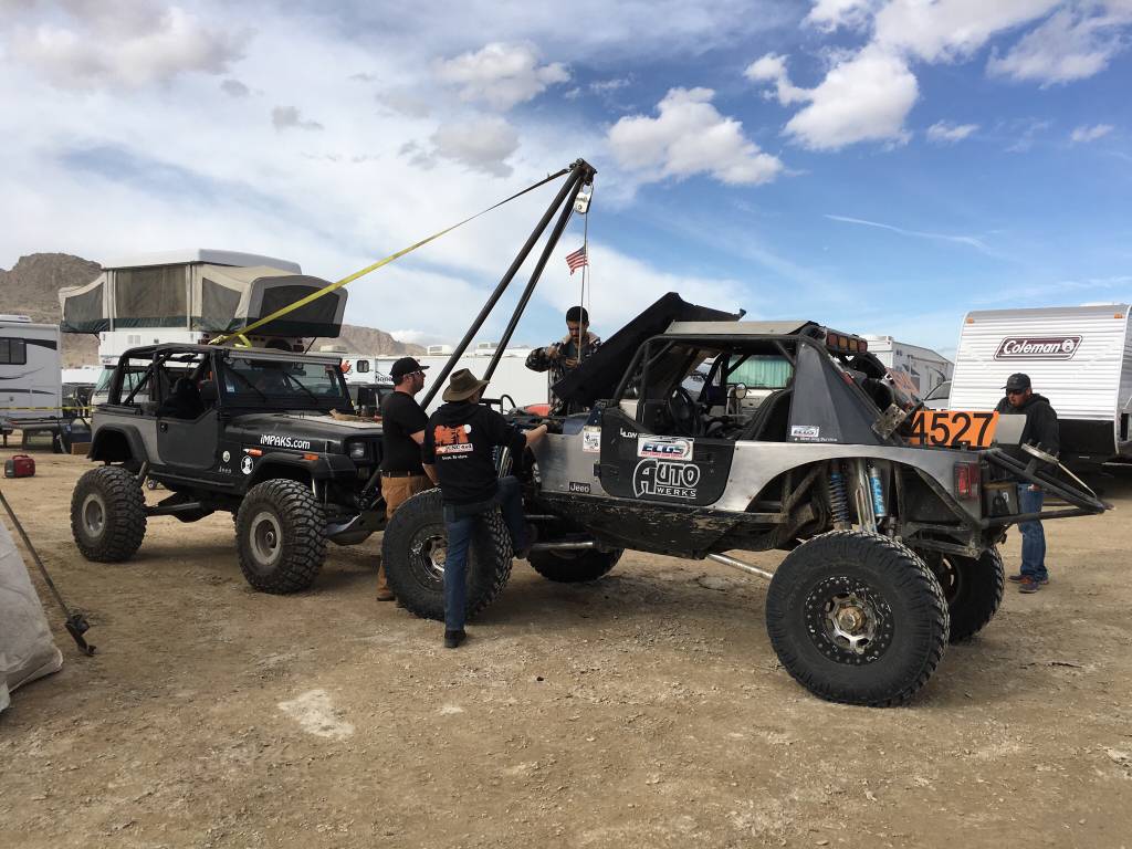

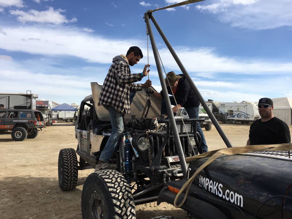

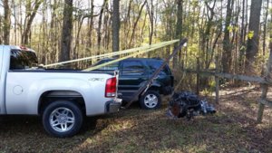

Anybody done this? I've got a few heavy items that I need moved around. The tractor with the front end loader is in NC. The biggest item is my air compressor. It's stupid heavy and took 5 moving guys to maneuver it out of the truck. My initial thought was something like this:

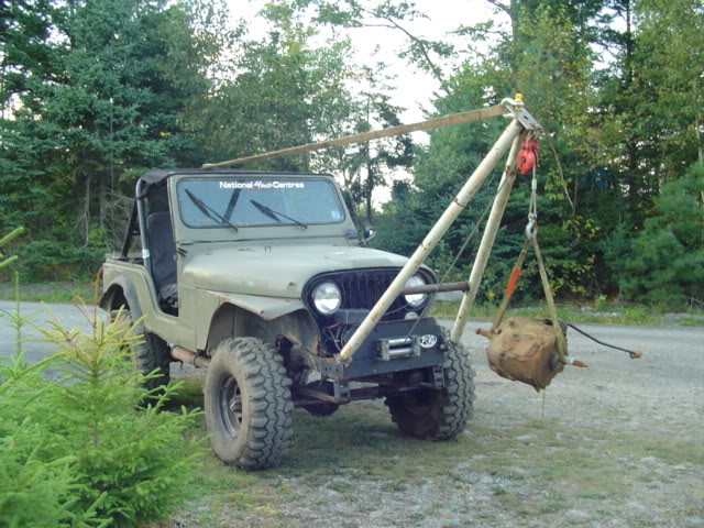

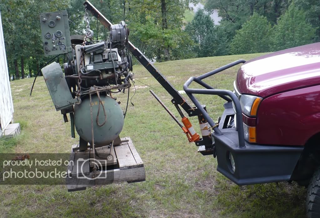

But then I saw this. It's like a cherry picker for the front bumper.
Worst case I break something I need. The upside is I have another tool to use around the house. Has anyone here tried something like this? Anything I need to watch for or avoid like the plague?

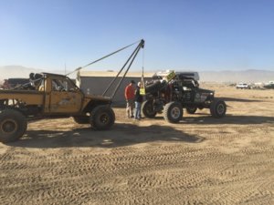

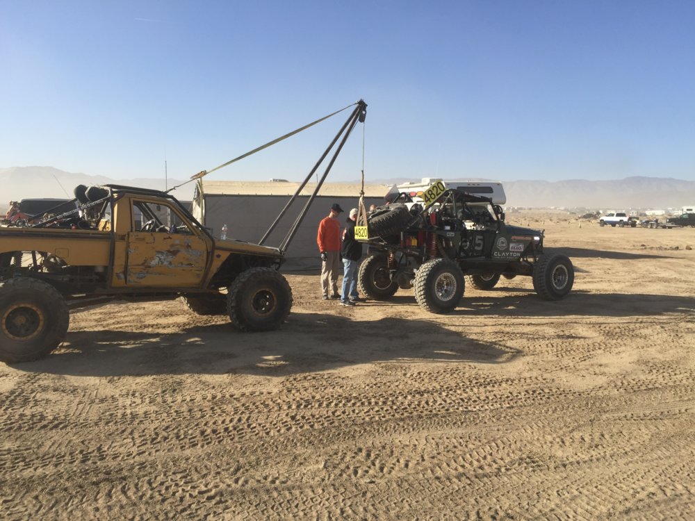

I built one like pictured on the jeep on my old cab truck for moving large rocks at my old house.
A friend on mine has one, it was a bed mounted crane, modified to use a 2" hitch. It didn't have very much capacity, may be 300lbs. Used it to skin pigs.
I'd be curious to see one that uses a winch.

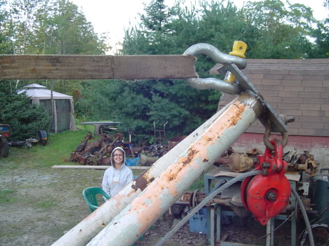

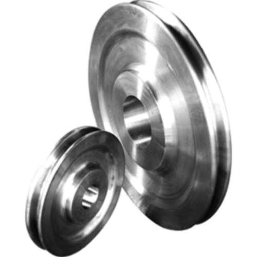

Mine does.....cable sheave/roller is built into the tip. Cable comes off winch, along top of main boom, over pulley sheave, and down to load.

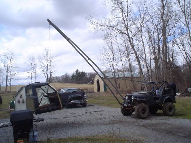

I have done it like the first pic. But, I used my winch running up to it with a snatch block. I moved an old Dodge crew cab body around with it.
