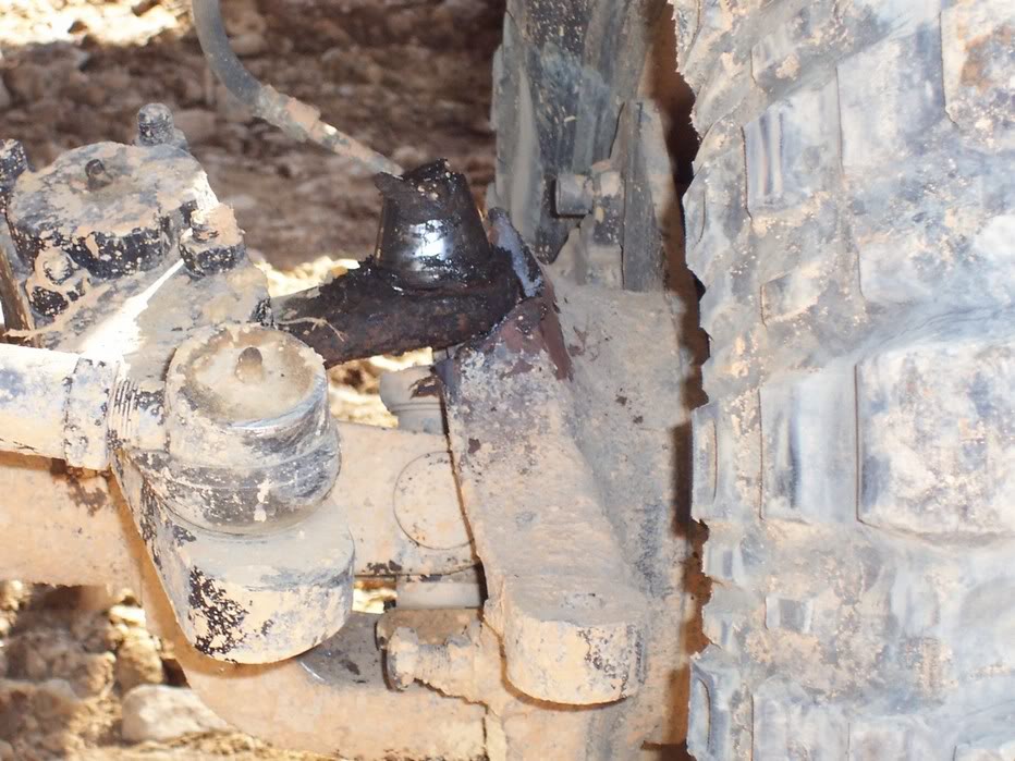

Question.. I see the DE ram, and what looks like a stock tie-rod.. I'm trying to picture the knuckles moving, seems as though they would be fighting each other, or no?

Tie rod will come off. Your right, you can't have both. We made the headers which had to go over the frame rails. The headers then determined placement of the front axle. The final results are in from the main office and the wheelbase is 155".
They do work against each other just havent got around to taking the factory one off.

i dont think the shafts would be my concern, but i would be worried about the knuckles, especially if they are stock (yes i have had a 60) other than that, i think you built a kick ass rig. it may hold, who knows, only one way to find out...wheel it.

I've owned d-60's. So have 8 or 9 others in the Muddevils. Do you have stock knuckles-those won't last long. Seen them break with 39's and 42's, yea even the chevy ones. Housing? those break/bend as well. Same with the r/p, don't care what kind of gears you have. Hope you at least got drive flanges. 52's and a sixty is right in line with 44's and a d-44 or 39's and a 30 "thats as strong as a d-60 cause I got alloy shafts." You seem to like to talk smack so there you go. I won't even start with the rockwell stuff.
