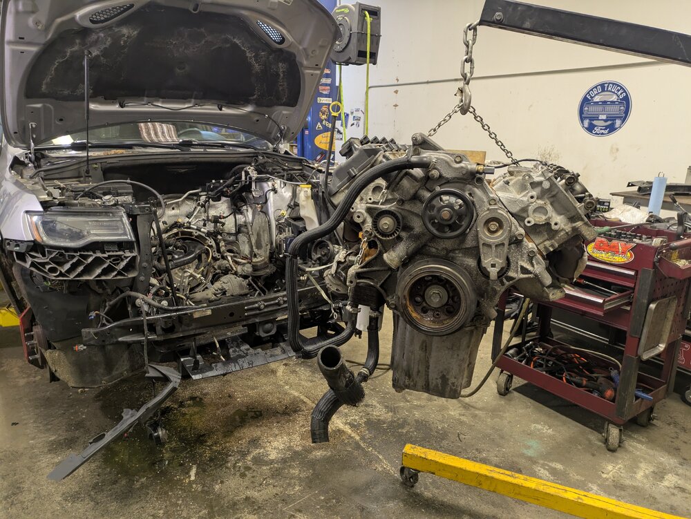

Jeep SRT revival
Bellhousing bolts and it's ready to pull
If the block is salvageable, I'm gonna rebuild it myself and add MDS delete with a better cam.

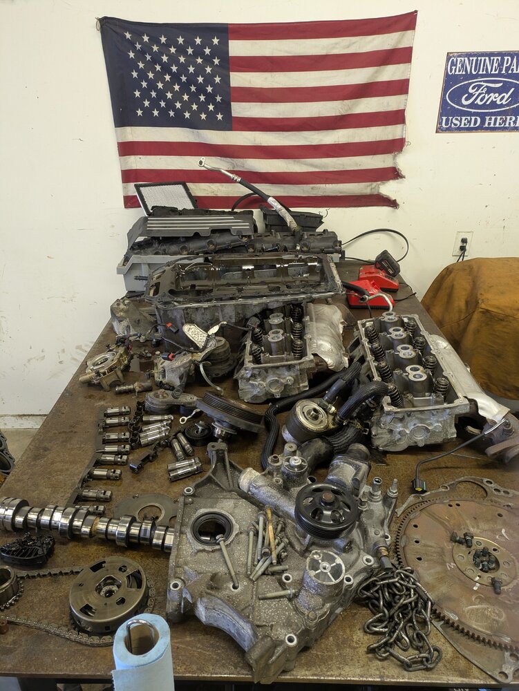

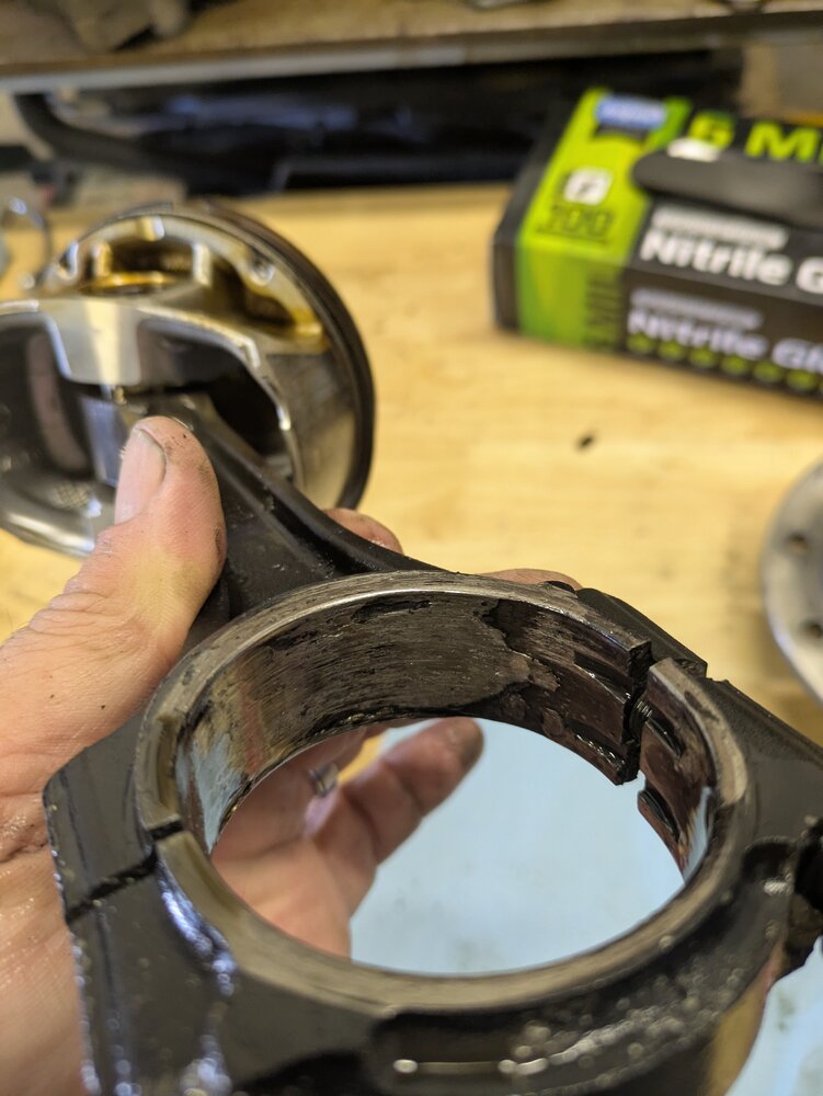

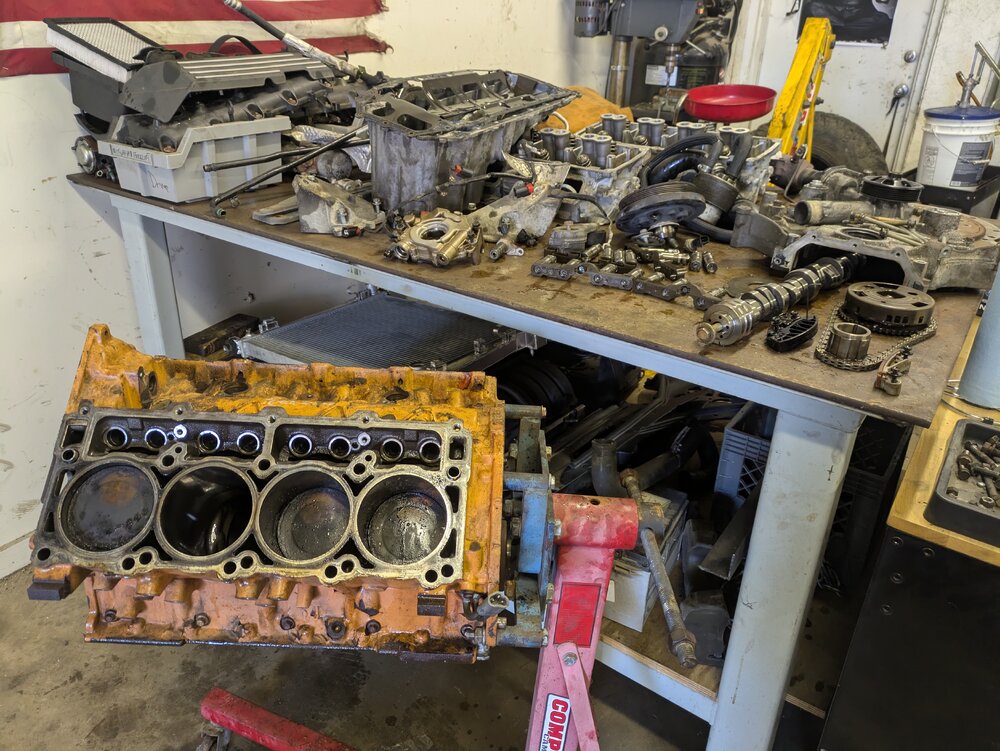

Spent a few hours in the shop and got the engine out and torn down. #3 rod bearing had spun and the piston was rocking in the cylinder. Walls look good with cross hatching still visible.
MDS solenoids are in the trash can for good.
Went ahead and disassembled to the rotating assembly and will drop off at the machine shop this week.
Gonna get a full rebuild with crank, rods and new pistons along with a better cam.
