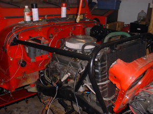

Over the weekend, my pops, was passing through to ny.. So he helped me out some. He bolted the winch to the plate then the whole thing to the jeep along with the tow hooks. Checked the fluids and helped hold the cage bars so i could tack them... thanks pop !!!

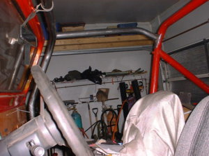

Cage will be a minimal cage, still have the overheads and the frame ties in... (2" .120)

frame/seat tie in - No. Its in progress, what you see is what is done.
Honestly I may not get to those before paragon, but the feet will be bolted to floor and plated top/bottom, just may not get em tied in...
Seats - I figured people have been wheeling with stock tubs and seats long before jungle gym cages were the craze so. The YJ tub has not been cut or weakend, so ill be ok for a trip or 2...

hobie, i didnt mean to be snotty. The fronts will be a simple box tub coming off the frame up the some plates under the tub bolted to the inside plates...
Main hoop.... i dono yet :)

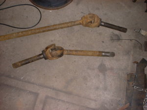

Some spare parts showed up yesterday.. Some magic 35 spline pixy parts to ward off the bad mojo :huggy: never hurt anyone... figured id be POd to go all the way to PAP and break somthing.

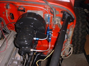

Houston ! WE HAVE BRAKES ! Harper stoped over so I tricked him into helping... 1.5qts later :) only had a few leaks to track down, found my bleeders on my rear calipers were pluged with dirt, once that was that was discovered things went fast...

hmmm brakes not good at all... I did reverse the ports from what is seen in pic above, (front/front rear/rear) It was a reman so im kinda wondering if thats just it. I bench bleed it and last night did it again and still produces very little pedle...

In the pic, it looks correct.... rear port feeds the front brakes, & vice versa...
not on the vette masters (so ive read), that makes sence as the front does hold more juice, hell if i know really...

Huh.. I was stumped on my 'vette one since the front and rear are equal in their capacity, but the rear port had a bigger thread on it... ah hell, I dunno.
well I bought a e350 master so ill slap that on there and see what it does. Ill just grind a notch between the front/back so some more fluid can float between the 2 sections...
