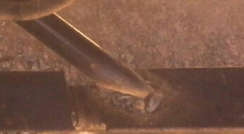

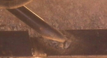

You're getting more surfaced covered when it is fitted around the barrel then just butting them up to each other and running a bead around it. And honestly your welds aren't that impressive either so it's another concern. And just looking at how little prep you did with the lowers is kinda creepy. I'm not a pro fabricator though so I might have no clue what I'm talk
Ing about but I also don't build hacked together stuff.

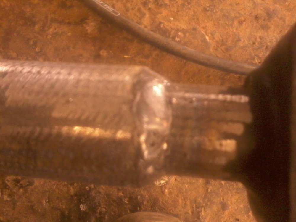

Don't forget that if a proper weld is not used, then it will fail before anything!!
That is a far cry from even a decent weld! Not trying to talk smack, just saying I wouldn't trust that to hold anything!
Tell the truth, you welded that pic above your post didn't you?
View attachment 190057 Don't forget that if a proper weld is not used, then it will fail before anything!!

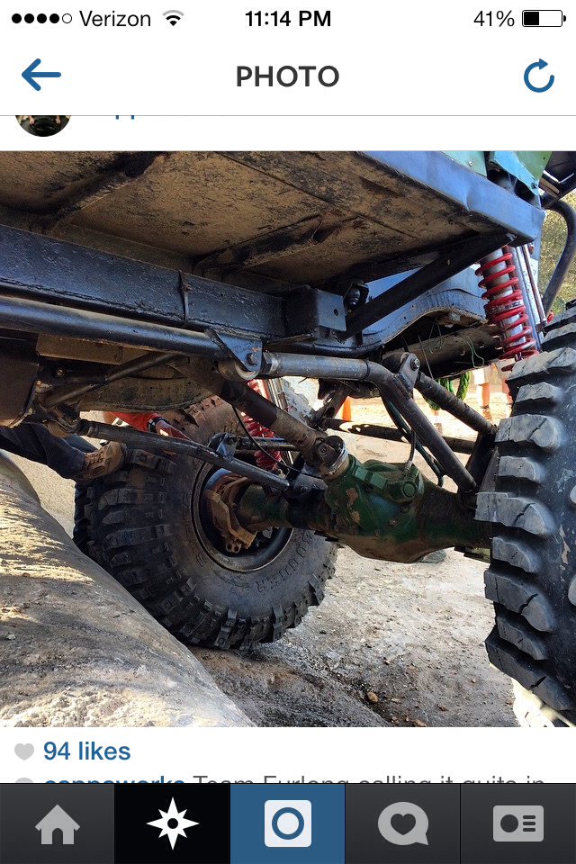

Then adding to this, you've got a want to be radius arm going on here, you're adding so much torsional force on your angle iron that doesn't fit up snug around the arm at all so there are some huge gaps there. Plus those stock JK bushings are probably screaming their ass off right now when you flex. They aren't adjustable so hopefully you nailed the pinion angle and caster split first time go. Wonder how much torsional load you're putting on those arms and the axle tubes when flexing. Wonder if the caster is set the same on both sides. That's just a death trap and I'd hate to see it on the highway. Sorry I'm pretty blunt about stuff sometimes but dude I've been fabing/welding for about 2 years and mine comes out so much damn better than that boogier turd. Granted I've got more mechanical skills than fab after working at a dealership doing heavy line work for 5 years, but what the hell dude. God that looks horrible.

and i keep telling yall I didn't use those arms...theywere something to get my pinion angles right and axle centered...drove it to my friend to more sets he had for me then came home and redone new ones that i've shown you.
