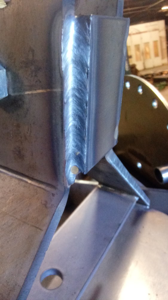

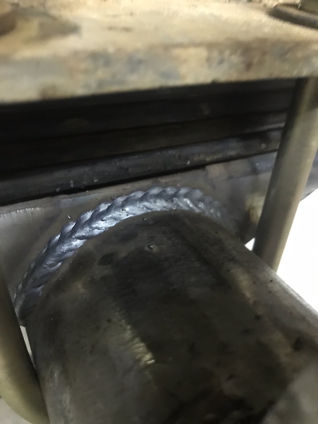

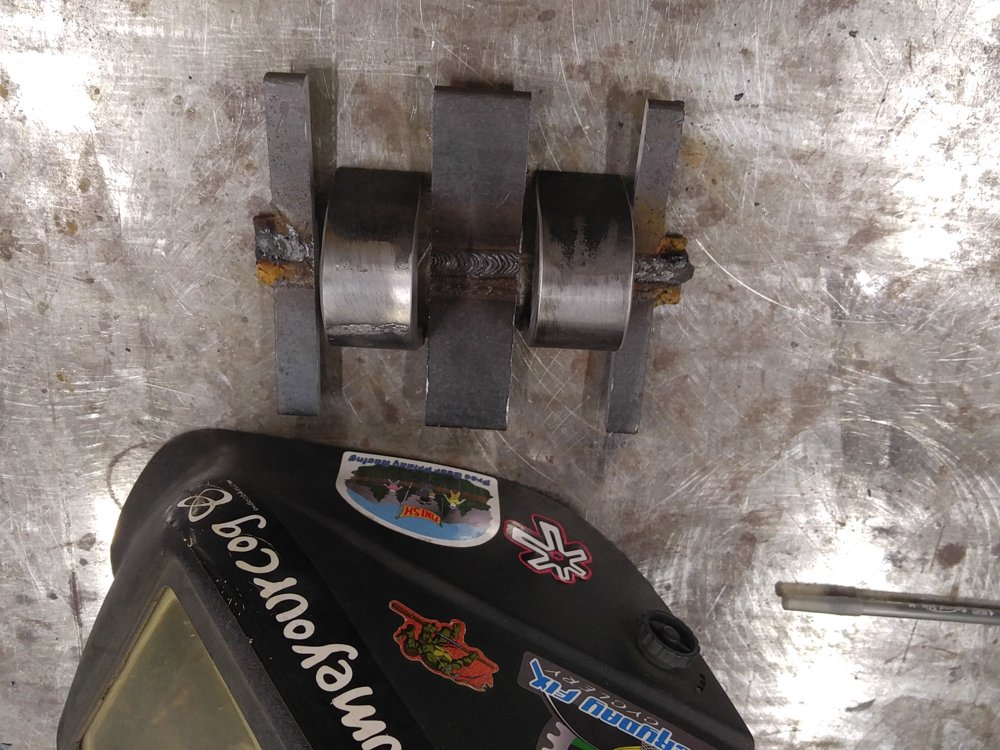

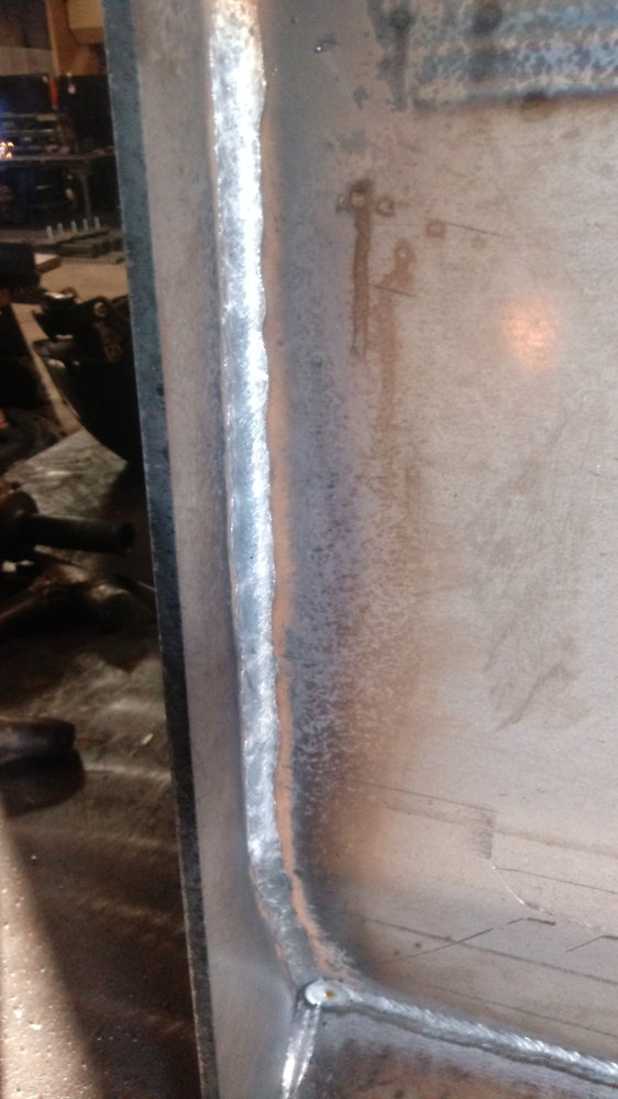

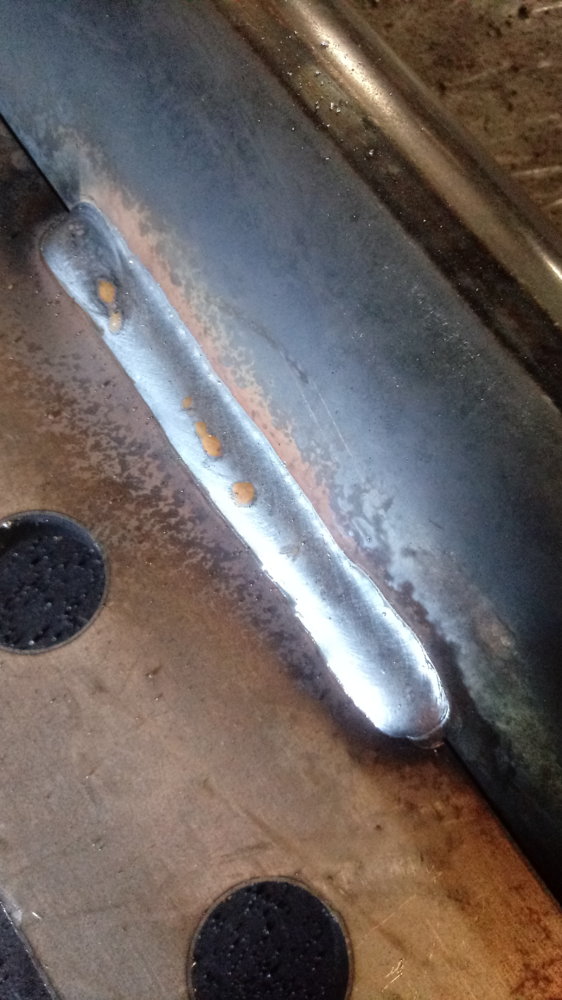

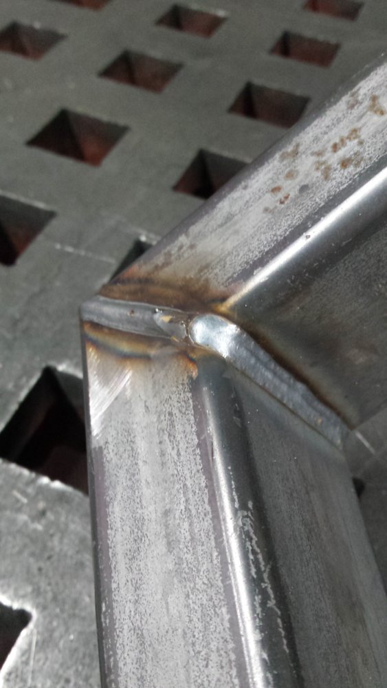

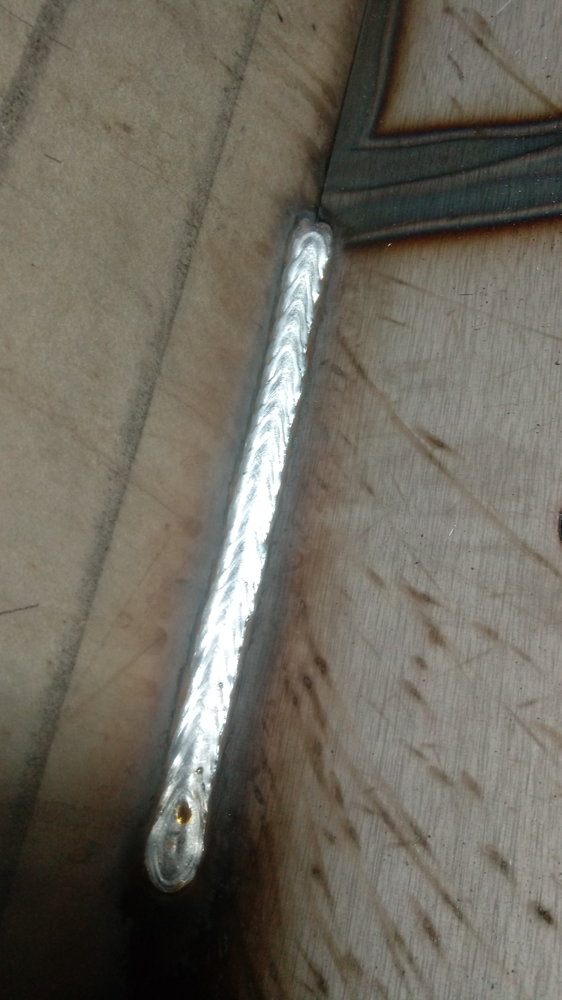

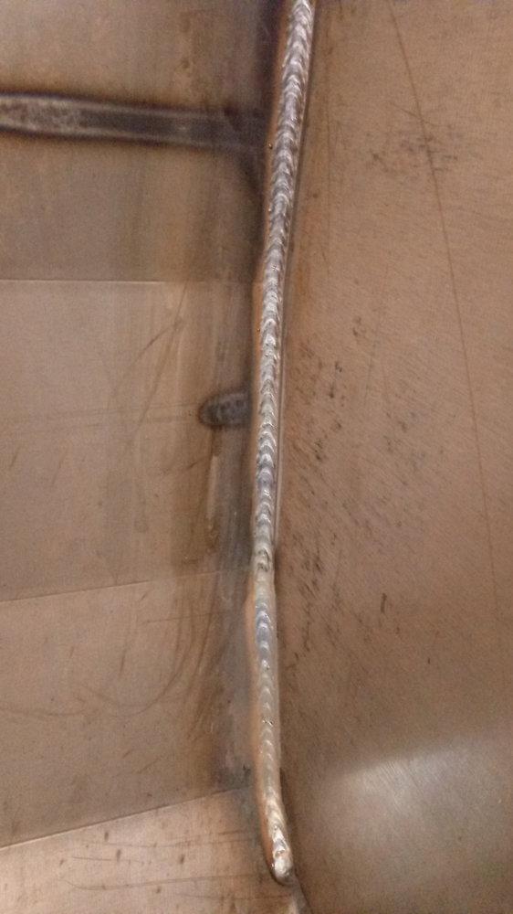

Squirt gun.......better. Pics 3 and 4...Keep your toe lengths equal on the fillets. Unless it's thick to thin. Shear loads and strength will be better when equally proportioned. Pic 2 on round to flat center screen.... Whatch were the puddle rolls out laying over the edge instead of penetrating. Excessive gun angle or to slow of travel causes this.

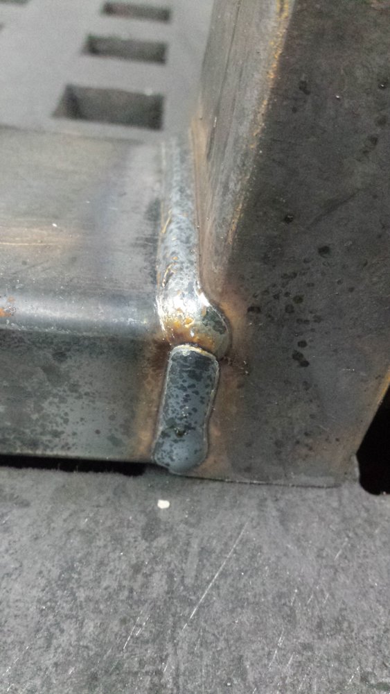

This was super long down weld...getting a lot better at those I think...
Stop going up and down with your vertical down. Start your puddle, let it grow the start pulling down keeping the edges of your puddle parallel. A weld with a smooth surface is stronger than a dime on dime weld. Also if welding tanks you will have less leaks.

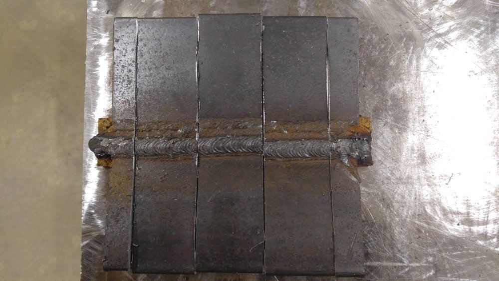

For the students.
Basic 6010 with backing. They ran some stuff, let's say sub par. I had to show them some real expectations. High Schoolers these days.....
