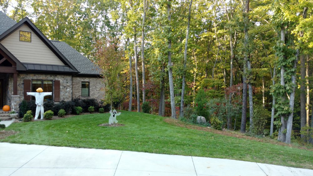

1 month and more than a few dollars later I have a lawn again.
Had my lawn aerated and I overseeded with fescue right after. Watered for 3.5 weeks, twice daily and my yard has finally came back. Since we haven't got much rain other than Matthew here in Charlotte, it started to thin but Ive got the sprinkler running once daily. I also decided to overseed again since its been pretty mild this far. Two questions, during a dry spell here in this area with clay being the soil around me, is it best to water first thing in am, like 6 am, or in the evening? Also, most fertilizers say wait 3 weeks from seeding, but which fertilizer is best for a new lawn going into winter?

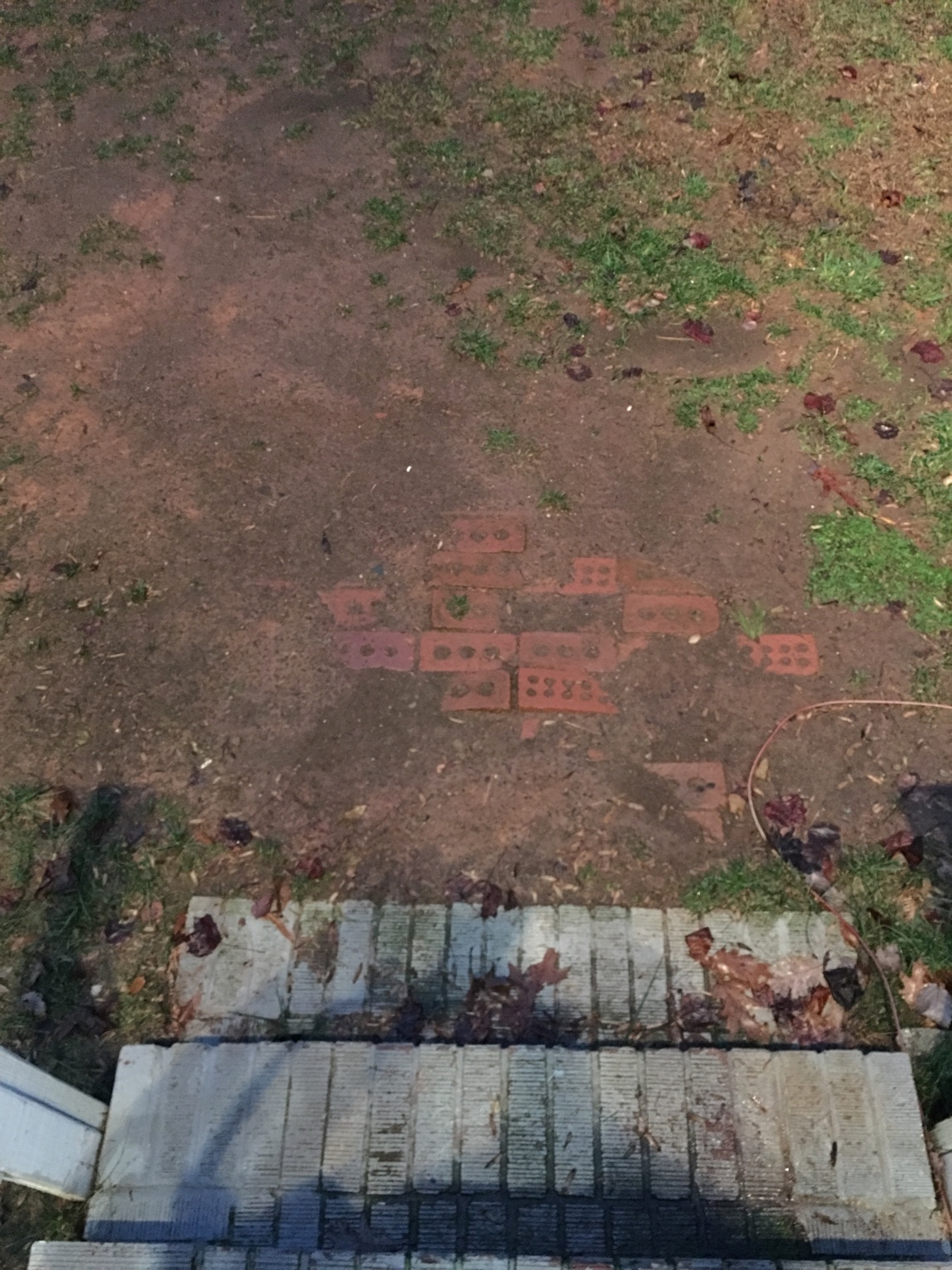

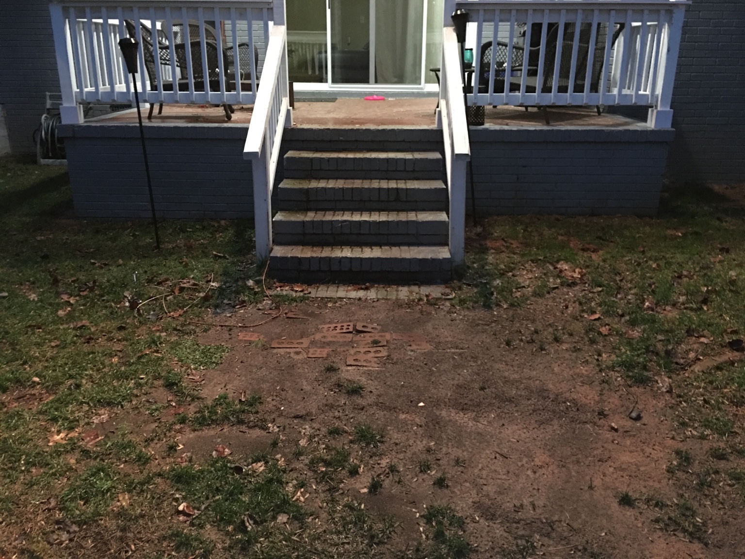

Another question for you experienced guys, I'll have put y'all on retainer... In my backyard where my steps come down from porch it's a high traffic area for myself and two dogs. Every time it rains we all track dirt and mud through the house. After awhile it's clear there were bricks under the soil which probably doesn't help grass grow but I'd like to put some stone there. I was thinking of using some treated wood and make a frame but I'm unsure if I'll need to dig a few inches out first then make frame and add stone or just dig a couple inches for the frame itself and add the stone? The part I'm insure of is if I dig out for the frame and stone will it puddle up when we have hard rain versus the other way mentioned? Here's a couple pictures of said area, excuse the dirtiness...
I originally wanted to build a small deck out a few feet and two the sides but the wife doesn't want to put money into a house we won't live in forever plus I'm building a garage soon cause I can't live without one obviously. Thoughts?

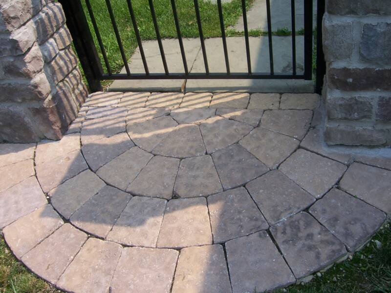

Well... I'm a glutton for labor intensive yard projects... but I'd be tempted to dig that whole area down about 4 inches, lay a stone dust bed with 1/8" slope, and put down concrete pavers in a 8 to 10 foot diameter circle. Maybe a fancy sunburst or something. You probably want to rent a plate tamper to get the pavers bedded down.
Similarly, you could buy some of the cheapo 12" square pavers from Lowe's and do the same thing, but for less money. If you go that route, I'd still do the stone bed and hand tamp it to get a solid base.

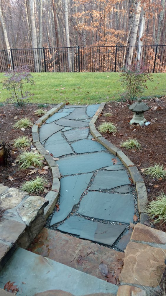

I built a small path last winter similar to what you are wanting to do. I think I dug down roughly 6", put down 2.5-3" of gravel, then maybe 1.5" of paver sand and some 2" thick stones with small pebble stones to fill the gaps. I used rectangular edging stones for the sides, but you could use treated wood. Sizing the stones to fit with each other was very labor intensive, but I am happy with how it turned out.

You would suggest any poly sand or should I leave the joints open for draining?
Your house is the one with the front drainage issues too, right? It looks like your landing area is a bit lower than the surrounding soil. Get yourself a 4' level (or a straight 2x4 with a smaller level) and lay it across that area to find how low it is and what it will take to make any landing you build to drain away from the existing steps and also not allow water to stand there. Your finished top grade of the pavers should be slightly higher than surrounding soil so it doesnt hold water.
Your options are unlimited from stamped concrete stencils from Lowes to [to grade materials from other suppliers. Lowes and HD also carry many paver options and designs. Decide what you're going to use, then figure out the finished grade of the top of the pavers and then excavate the depth of the paver plus about an inch for some sub base material. For something this small I will sometimes use dry MORTAR mix as my base, tamped down good and smooth with drainage away from the steps and lay pavers on it. Steel edging is an option here also as its thin and unnoticeable. even plastic edging will work since you will be burying it into the grade. Use the polymer sand if you have joints as it seals also.

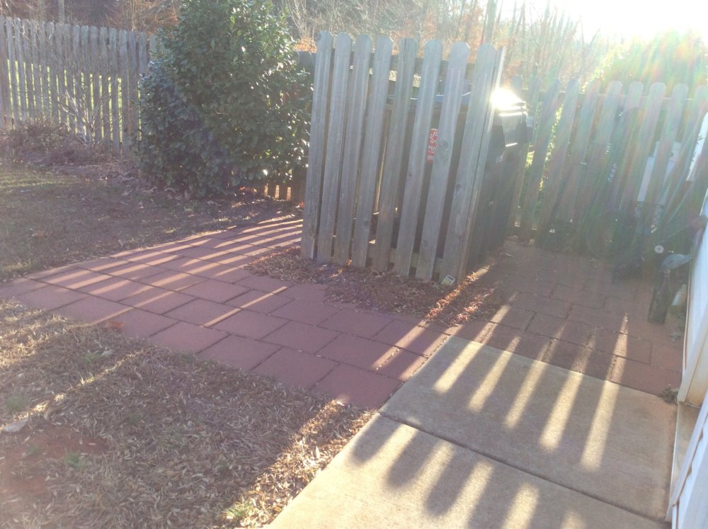

I did shawn's plan b option posted above, used 12" squares from lowes on top of a masons sand layer on top of a stone dust base. I hand compacted with water mist, a rubber mallet and section of 2x6. I know better, but laziness took over... instead of laying rails to drag a screeder board across, I just scrapped with the 2x6, checked the level as I laid the pavers. Swept sand in the cracks, then more 2x6 and rubber mallet to work the sand in. I went cheap on edging, just back filled dirt right to the edge of the pavers, used the 2x6 upright to compact dirt along the edge.
Phase one was a 8'x10'ish pad for trash cans. Phase two, a few years later (pavers are now 11-7/8" sq or so...grrr) was a little walkway to the backyard.
