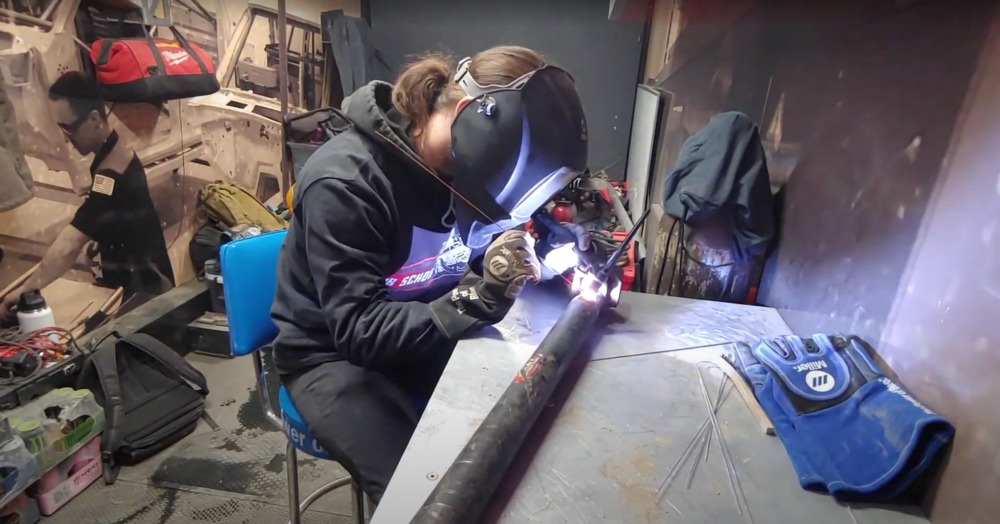

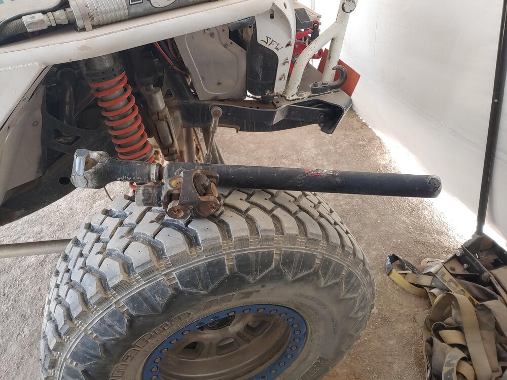

The driveshaft parts we scavenged with our original CV ready to weld
Fab school student welding it all together

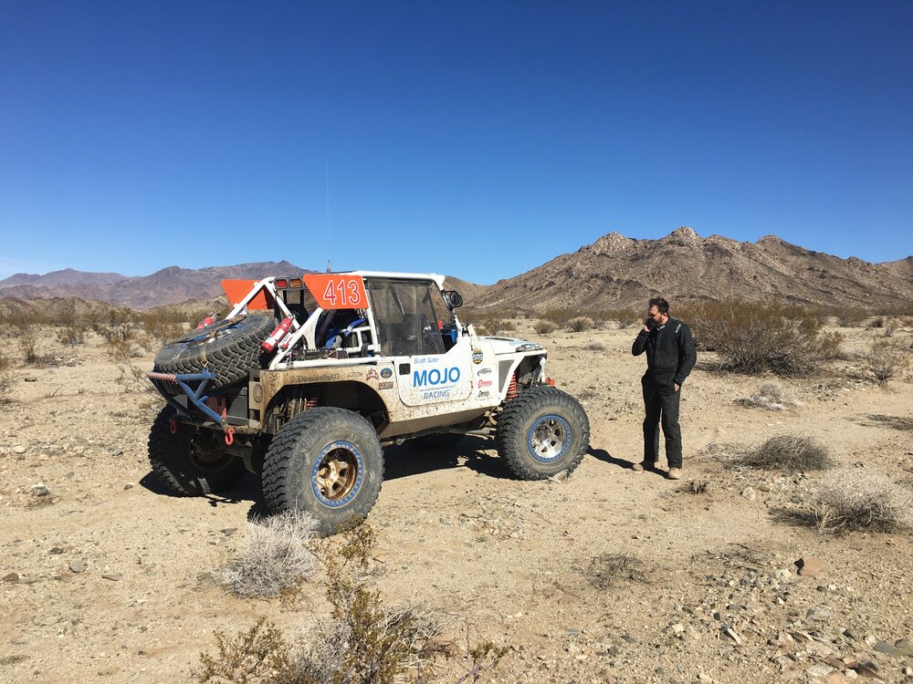

I pull off the qualifying loop and park the jeep. We climb out and can't believe we just ran through the same course that we just washed deny so many others. My wife runs up and I ask her how we did and she has no clue lol.

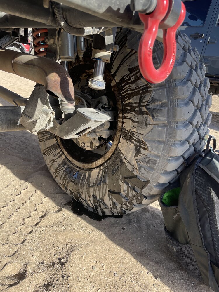

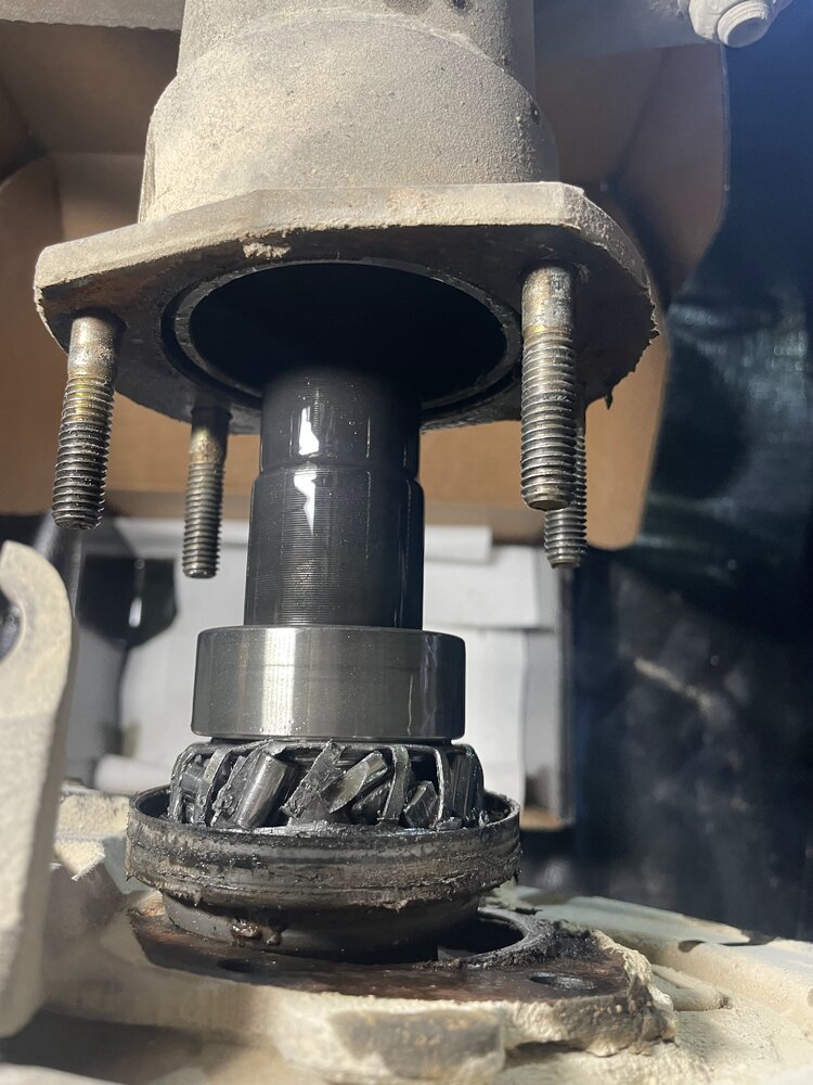

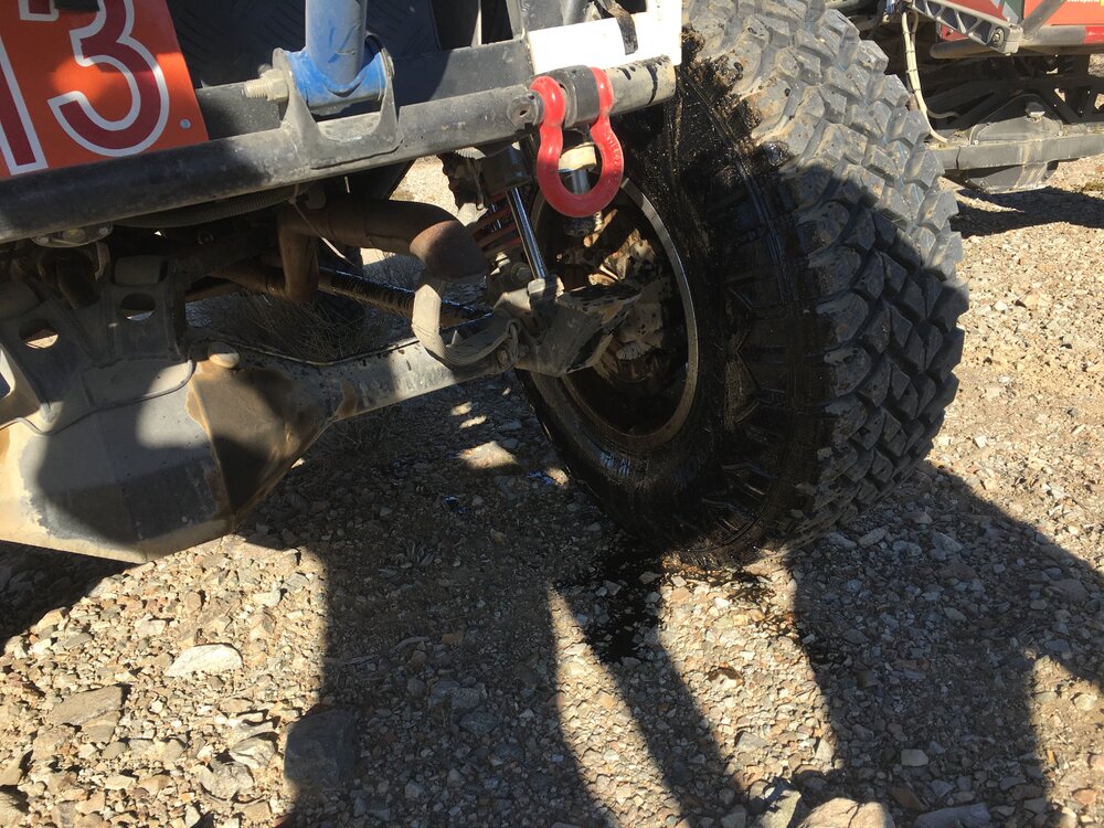

We take a moment to look at the jeep and immediately have a problem. The right rear axle seal is pouring gear oil. I thought I had broken or bent an axle shaft.

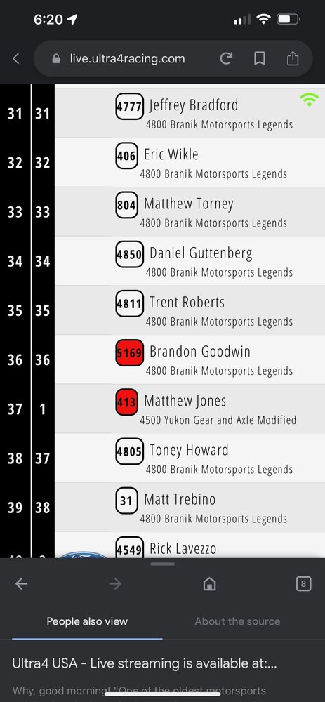

We stand around (and drink a much needed adult beverage) when Scott gets a text of a screenshot from his wife. We had qualified first in the 4500 class and 37th overall with only power hour to come. I was officially the fastest qualifying rookie in the 4500 class. I was in the process of trying to confirm this when I heard Ian Johnson announce it over the Jumbotron. I both couldn't believe we had done that well, an immediately realized we were going to get passed by so many cars in the desert.
After power hour we would fall to 6th in class and 44th overall. Still not bad if you ask me.
We limp the jeep back across the lake bed and pull the rear axle. It is bad. On top of that, the slip in our front driveshaft is rattling as well. We now have 2 problems to try and resolve. I talk to several vendors with no luck on either end. The Genright crew tells me of a driveshaft shop in Hesperia to try, but still no luck on the axle.

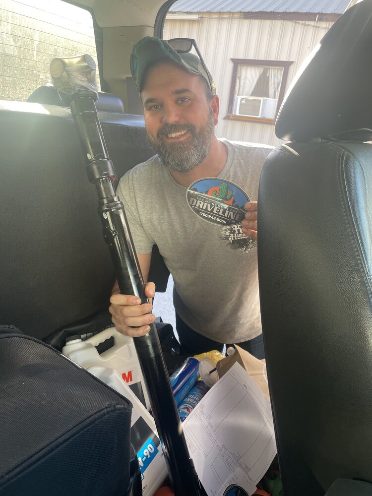

I get up Wednesday morning and call Currie Enterprises down in Corona. I tell them what I need and they said we will start cutting it now, do you want us to ship it to the lakebed or come pick it up. I say I am on the way and hit the road. We swing by Hi Desert driveline and drop off all the driveshaft parts I had accumulated and he said I will see what I can do, call me when you are heading back this way.
By the time I make it to Currie 2.5 hours after my call, the new shaft is already waiting for me in the lobby. I really can't say enough about how great my experience was with them and their service.
We head back up the mountain to Johnson Valley. I call the driveshaft shop when we are 15 minutes away and he says "I am balancing it now". Another win, and a monster upgrade to 2 inch .250 wall tubing.

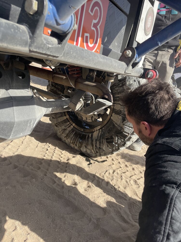

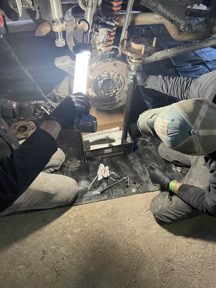

We get back to the lakebed and put the jeep back together, its dark, cold, and the rear axle Won't. Stop. Leaking.
We pull it apart and put it back together 4 times. We clean everything with brake clean, paper towels and q tips. We finally give in and RTV the crap out of all sides of everything, jack up that side and let it sit overnight.

We pull around to the contingency line after lunch, hop out and see a puddle of gear oil under the right rear from the 2 minutes we have been sitting still. It is at this point I begin to think I may have bent an axle housing, not an axle shaft.
We stuff a rag in the wheel to try and soak up what we can as we wind through Hammertown. We pop a bluetooth speaker on the hood and play my friend Troy's guilty pleasure playlist, a disturbing mix of 90's boy bands and obscure 80's one hit wonders follows us through the line while everyone around the jeep is signing and dancing along as we drink Tecate, eat pizza and tacos and continue to pass through the checkpoints with ease.

We pull the axle apart one more time to clean everything again and inspect the bearing and race. Everything still looks brand new with no sign or wear or damage. We put it back together (sans RTV this time), fill the diff, and it stays dry. We cross our fingers and go to bed.

- Rear axle leak (potentially bent housing or damaged cup)
