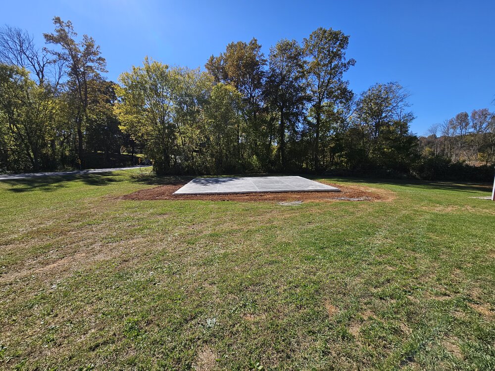

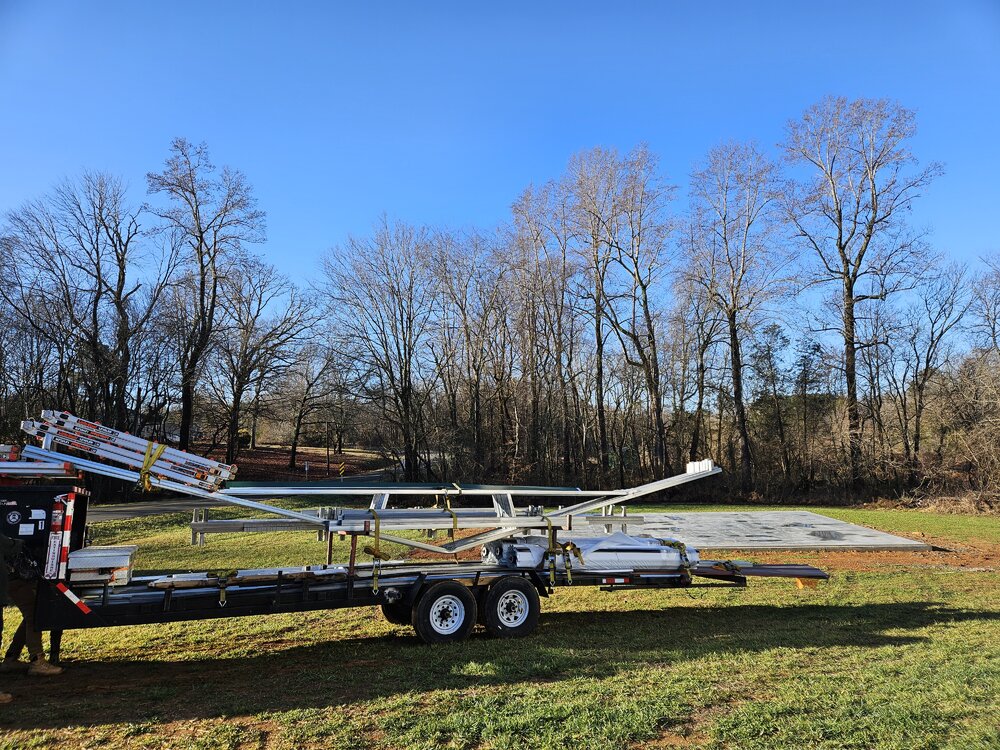

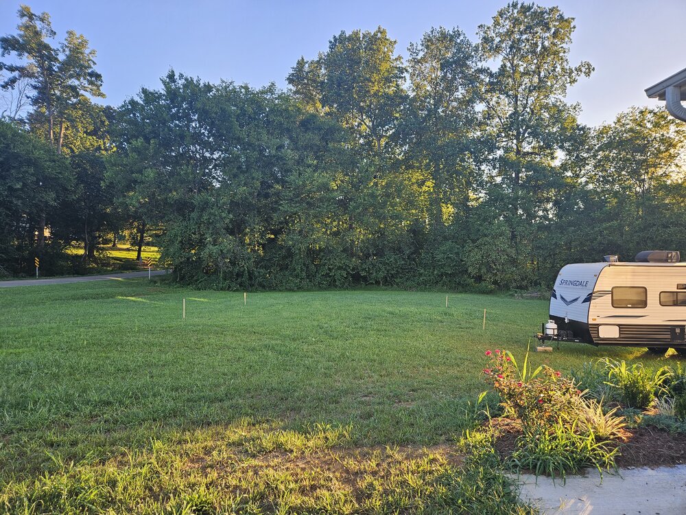

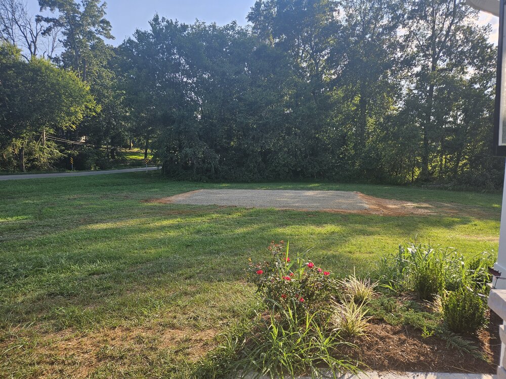

Last May I finally got everything lined up and permits pulled. Started with staking out and grading

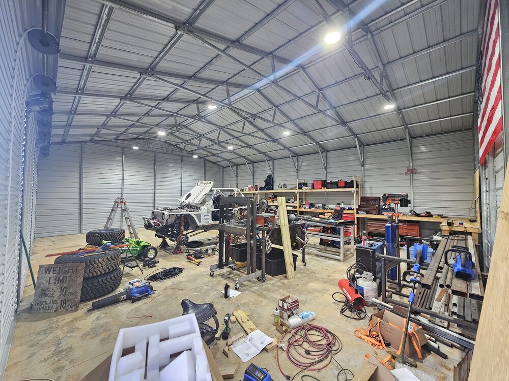

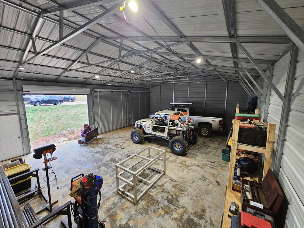

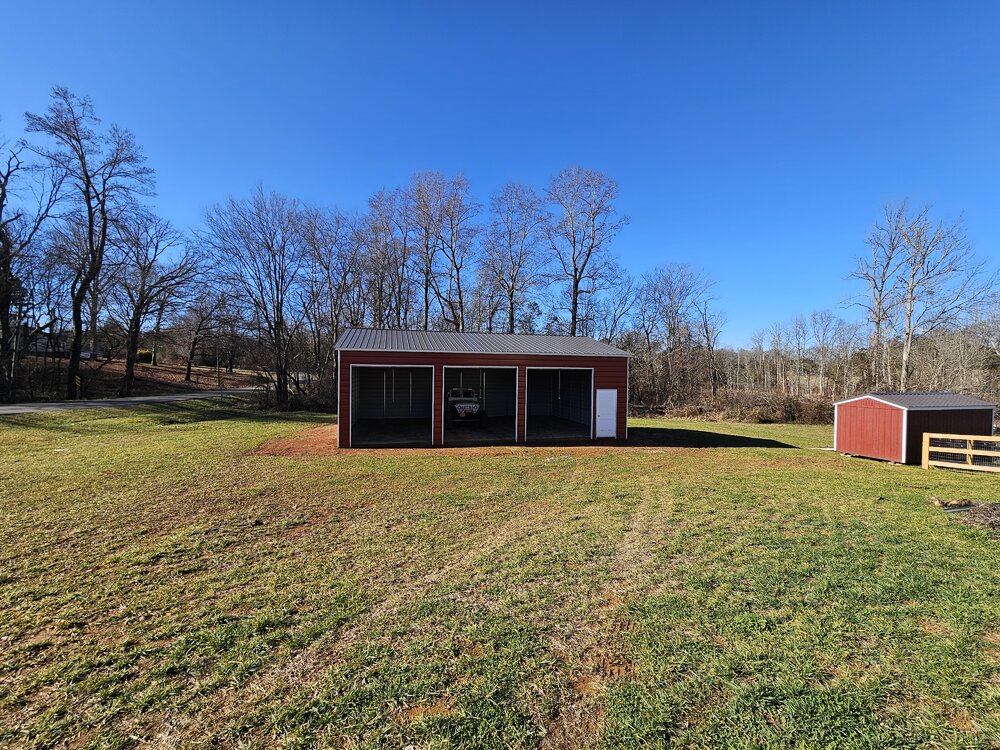

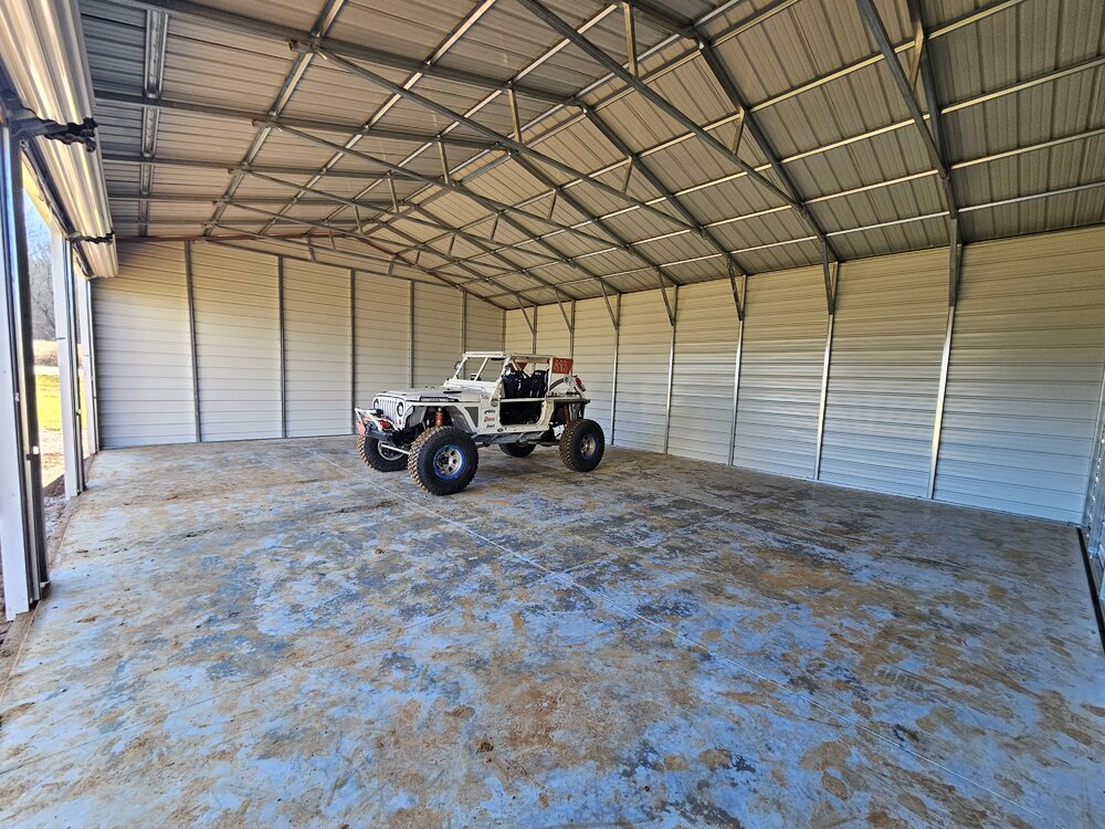

The building is 30X40 with 12 foot walls and I went 6 inches thick on the pad so I could put a lift in eventually. Still working on getting everything organized and setting up a designated fab area in one of the bays. Disassembly on the jeep has already started and the parts list is growing.

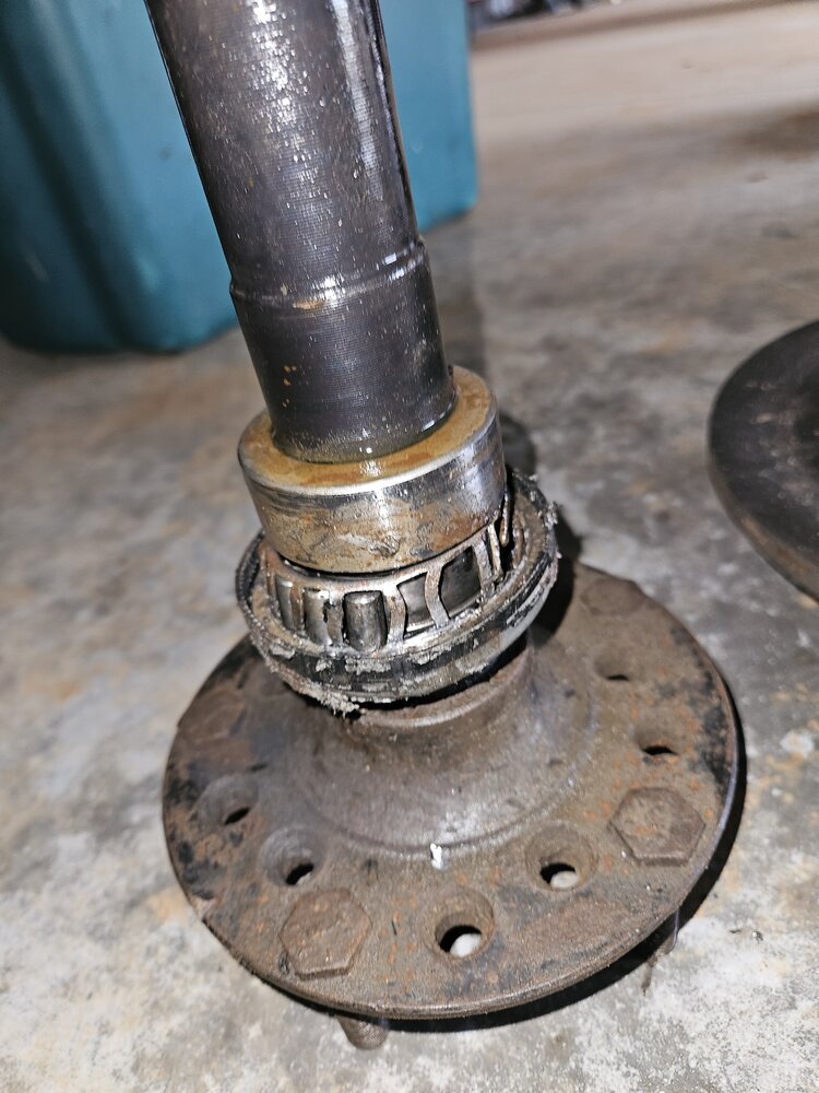

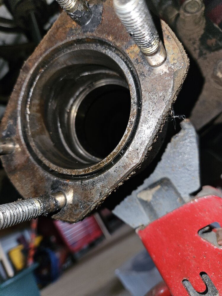

Out at hammers I ended up trashing a passenger side rear axle bearing in qualifying and ate through another on the first lap of the race before calling it. Upon closer inspection now it ate into the bearing cup pretty good. Right now the plan is to cut these off and go to a full float style using the same unit bearings as the front. I still need to try and check how straight the rear housing is, but without an alignment bar I am kind of limited at the moment. It doesn't seem to be bent so hopefully that stays true.

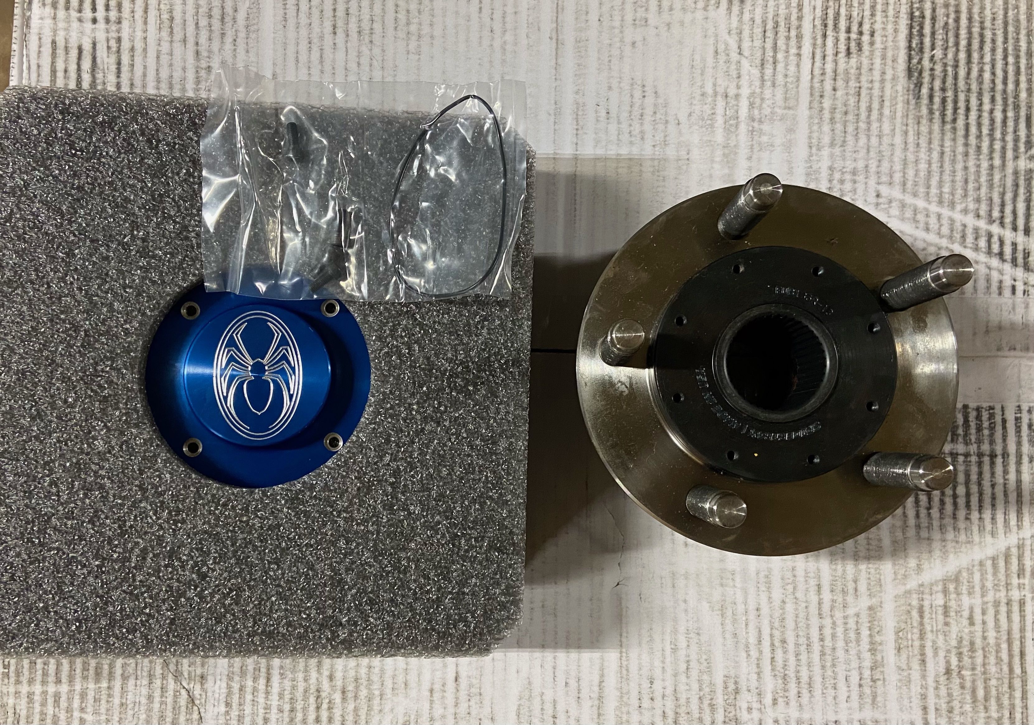

I have some Spidertrax unit bearings that would be perfect for you :
