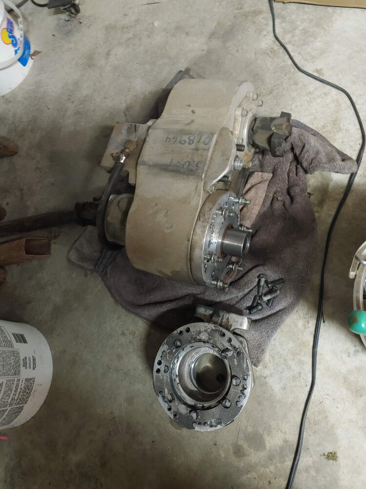

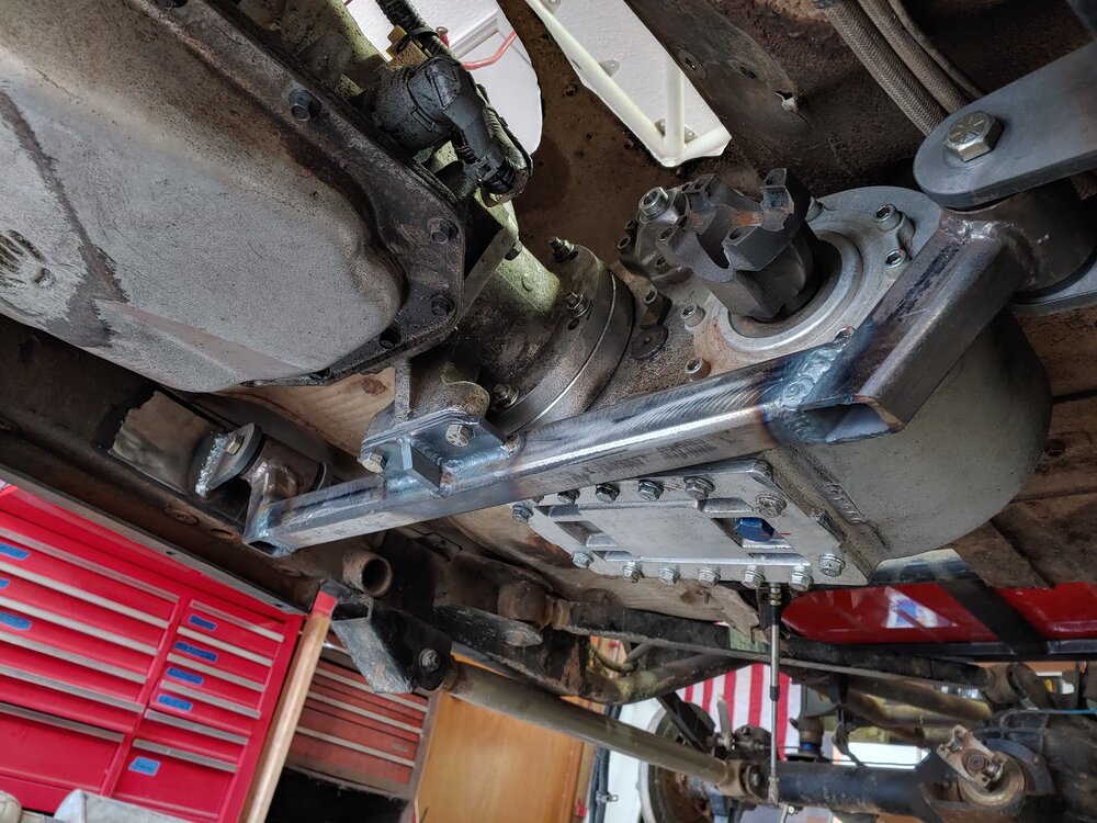

Got a new trans crossmember made so I can drop the skid plate separate from the trans. It had previously mounted directly to the belly skid. Then pulled Atlas and trans to send it out for a re-build
whos doing the rebuilds of atlas and tranny?
Atlas seems to be in great shape with no leaks so I'm going to leave it alone. Ended up going with monster transmission for a HD rebuild

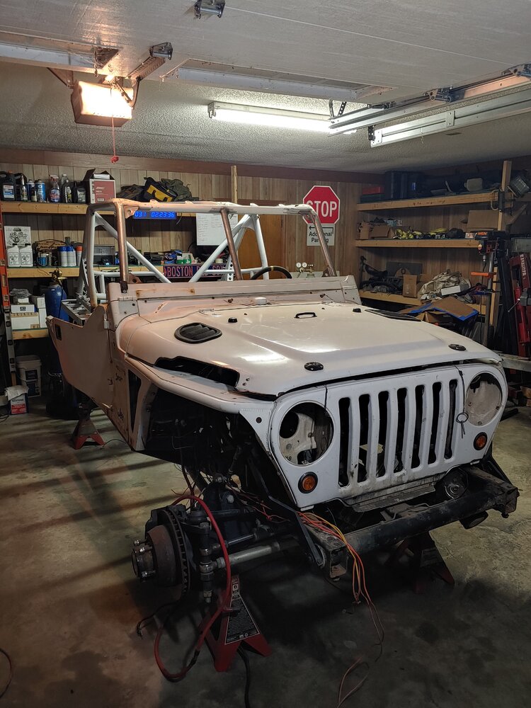

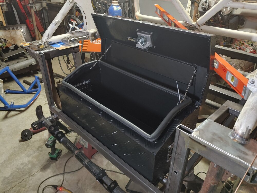

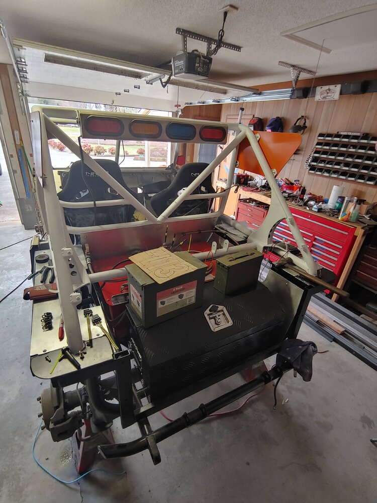

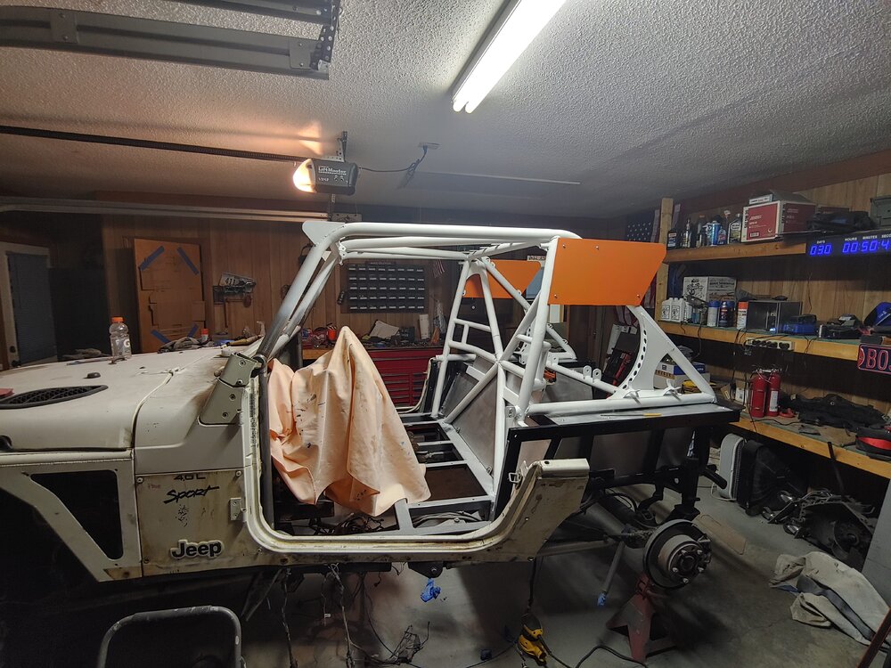

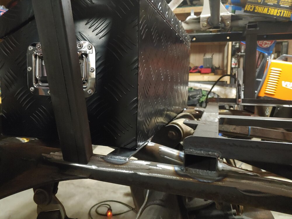

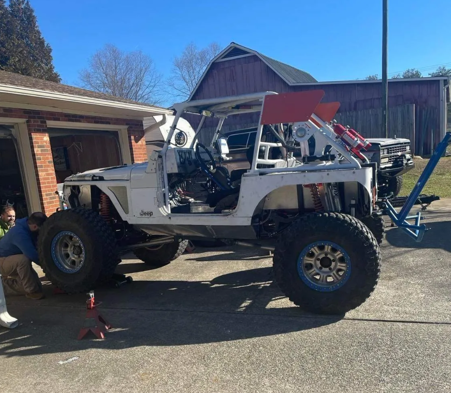

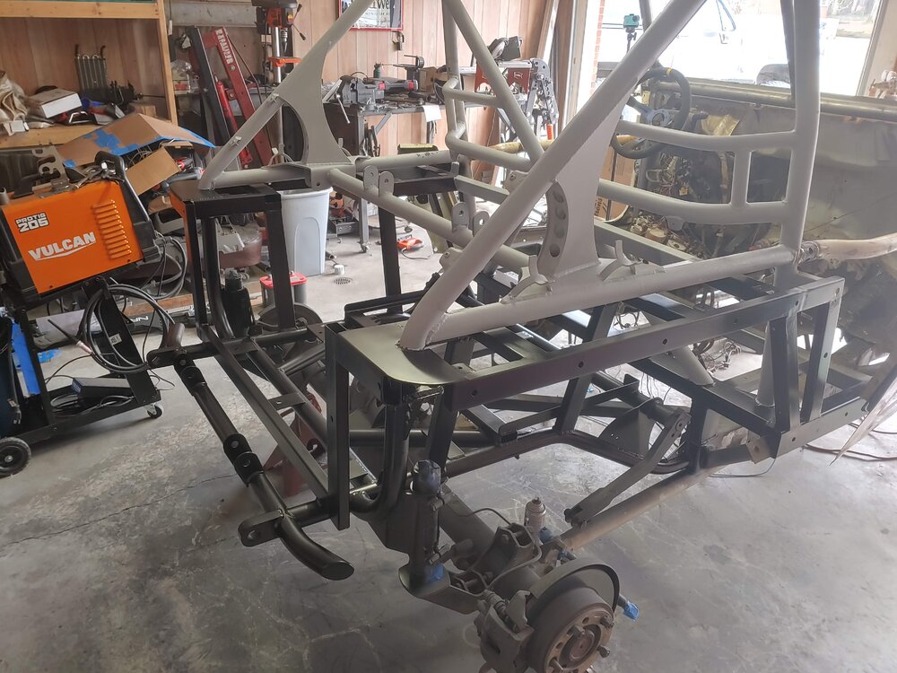

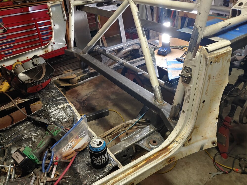

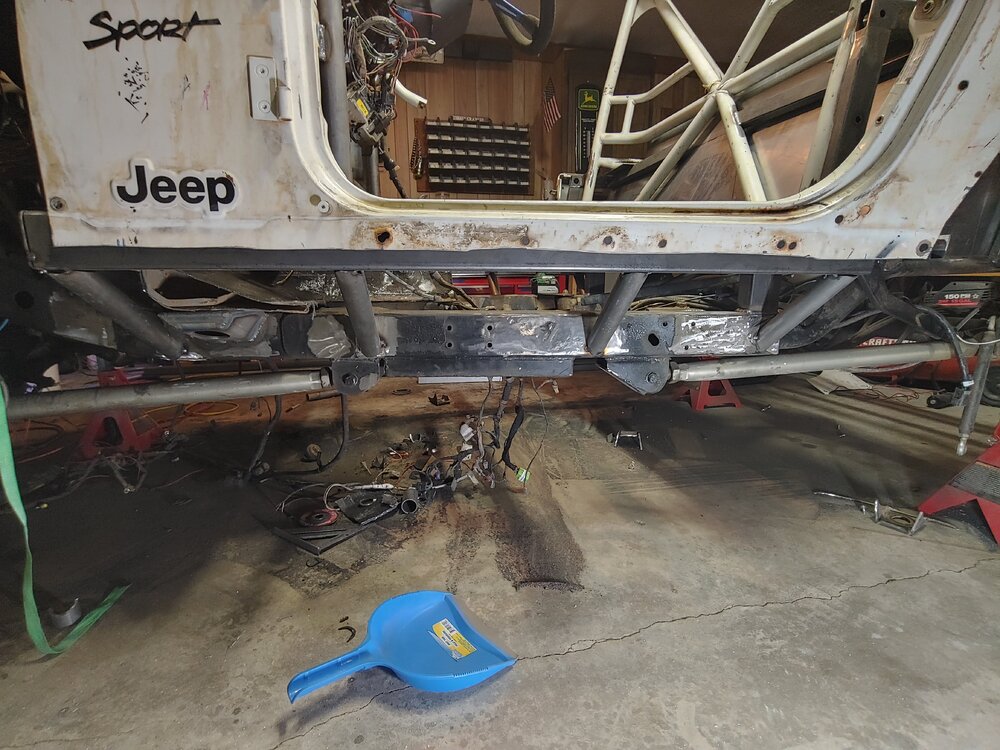

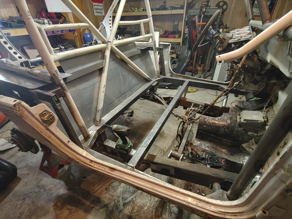

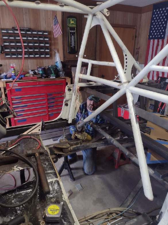

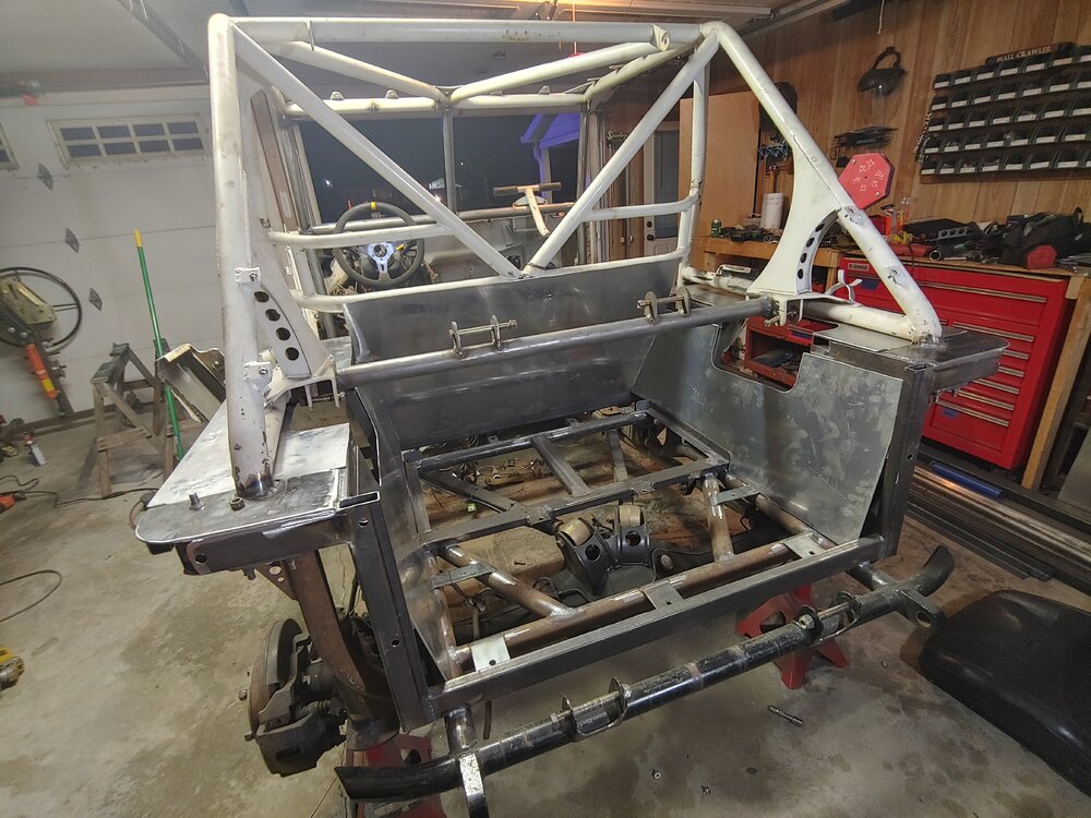

More progress appears to mean less jeep. A couple of friends came over and helped knock out some big items on the list this weekend. New cross member is in that ties the cage to the frame rails. Rear structure is all complete and now I have cardboard templates made for the panels that will close it all in. Last night I finished welding out the back end and got the storage box mounted. Will be getting the spare tire figured out next and then it is on to the boatsides.

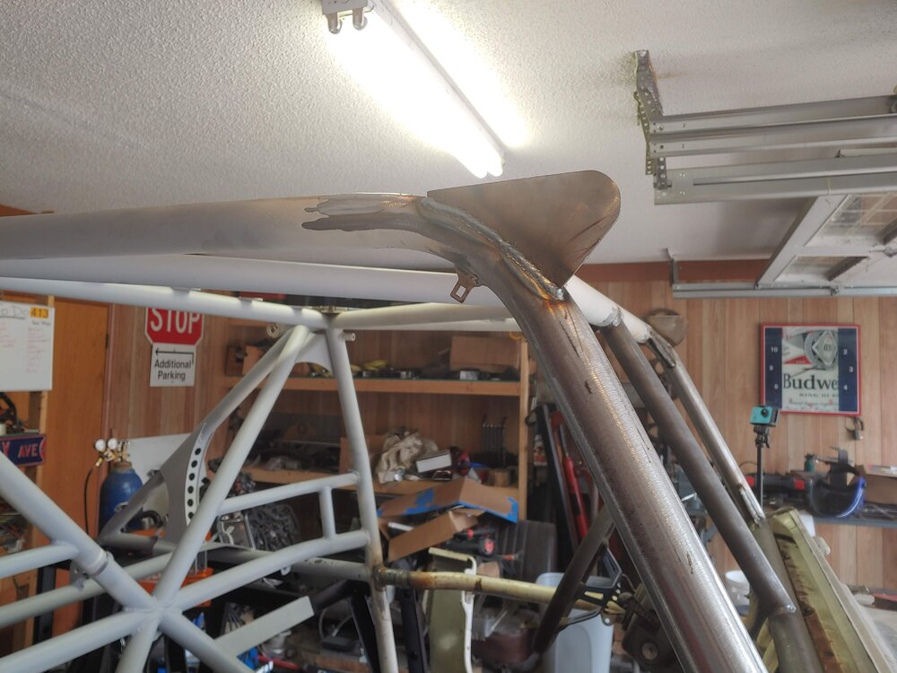

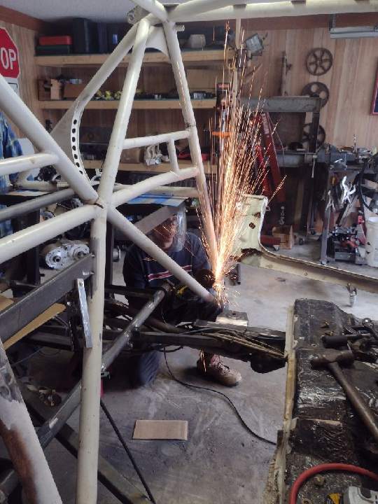

Should have cut this out sooner, made it way easier to get in there and work.
New crossmember in and welded to the cage
And storage for fluids, tools and spare parts. Just fits in there at full bump.

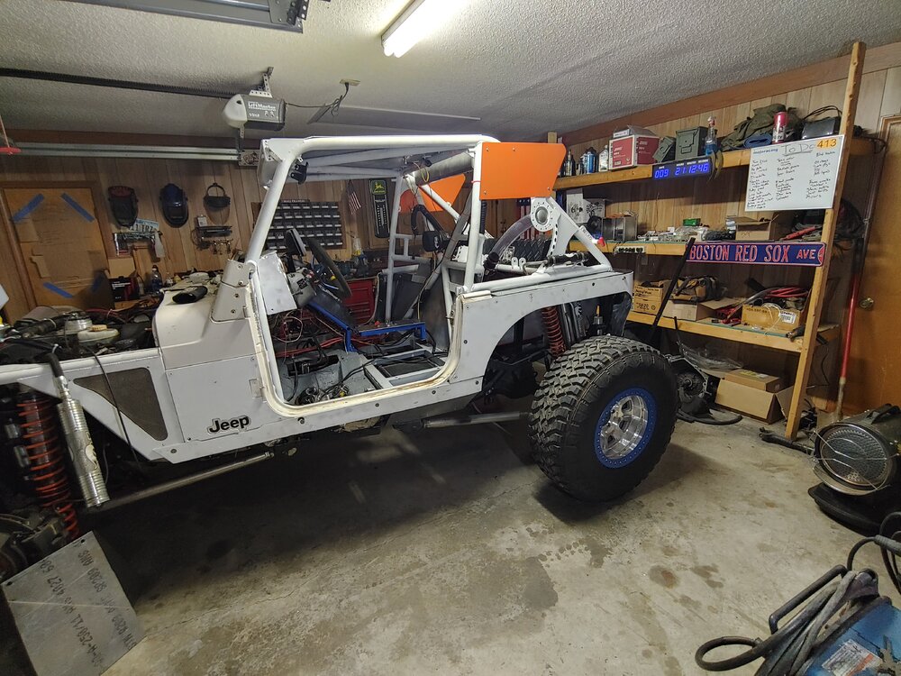

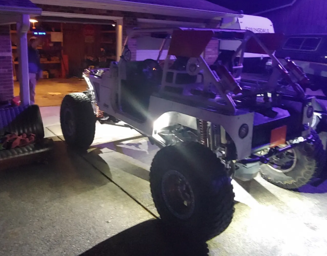

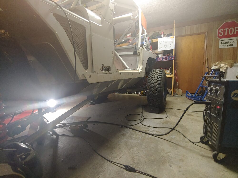

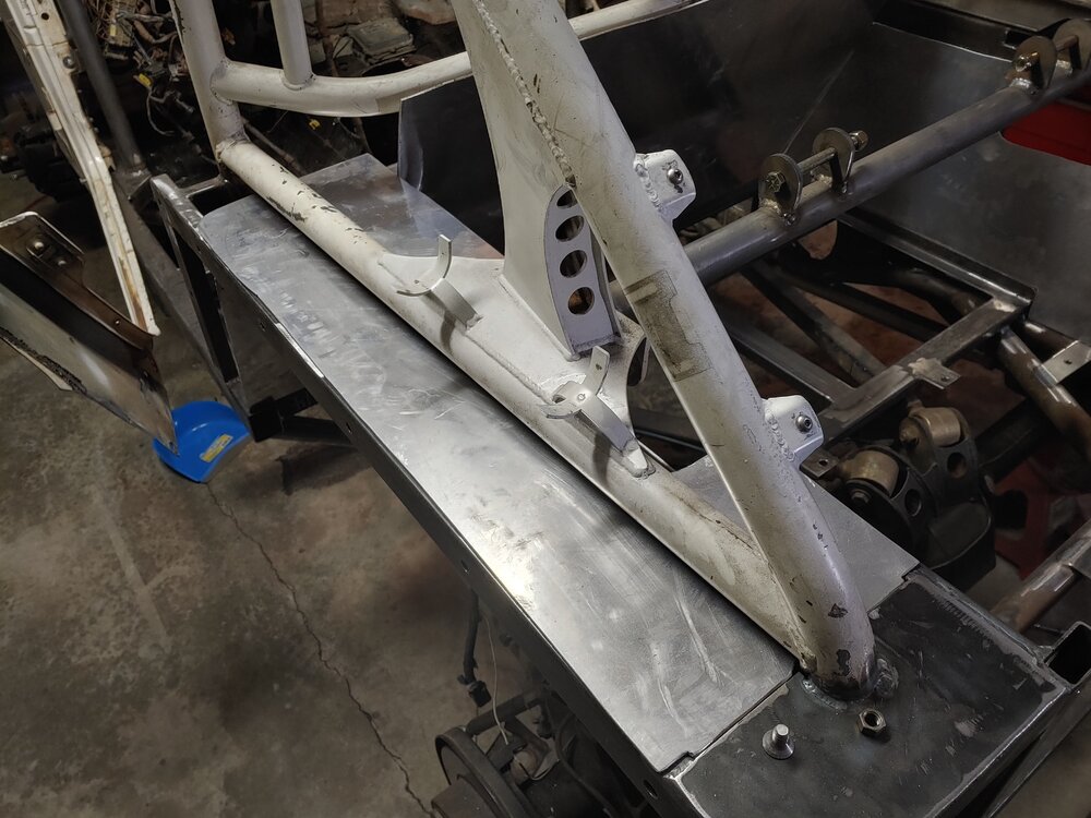

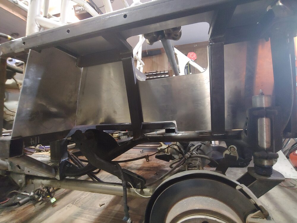

Got the rear panels and firewall all cut and fit, going to tab out the chassis tonight so it is ready for paint. Also got all of the boatside tubes cut and tacked in so the floor can get finished.

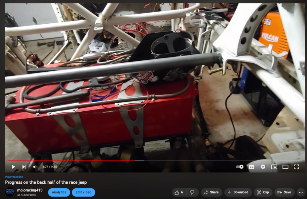

Just posted up a new video.

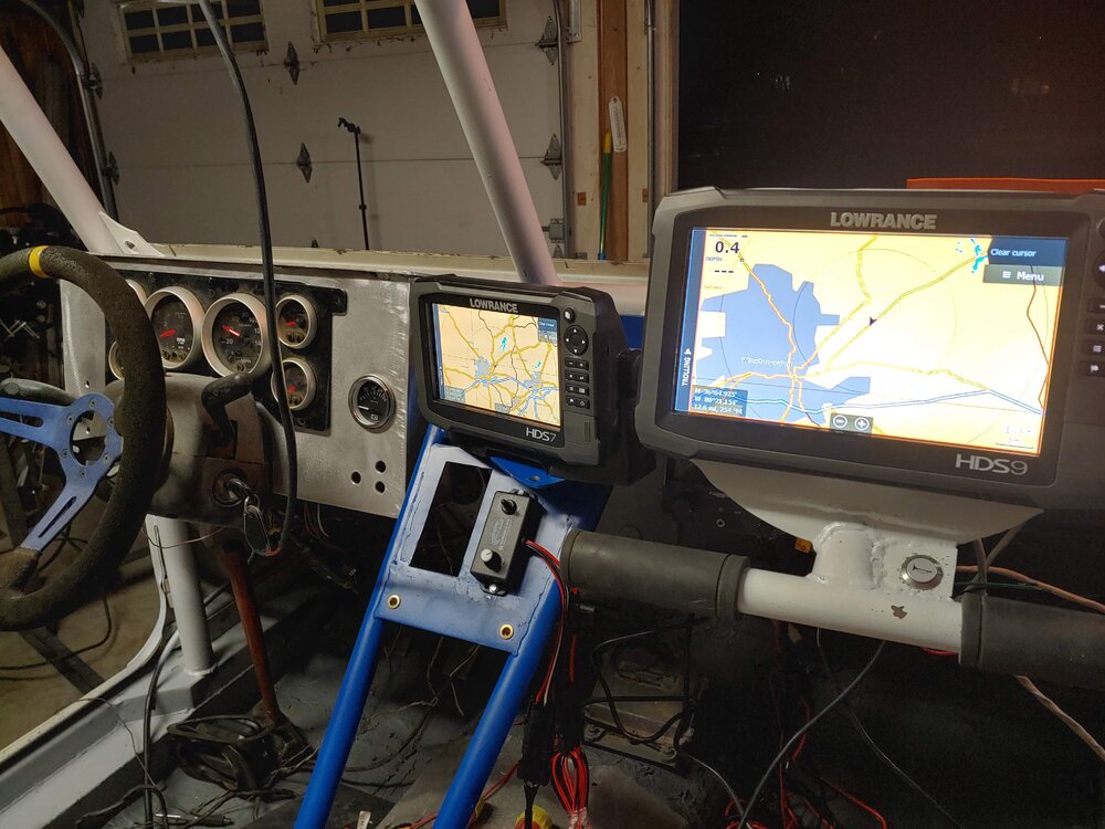

Got a good chunk of welding and panels finished up, and started sorting out the wiring.

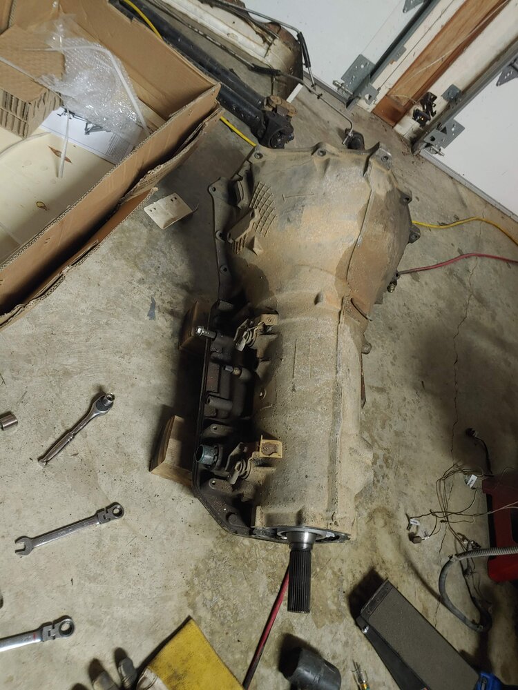

Ran into the first big problem though, the 4l80 was re-built with a 4wd output instead of the longer 2wd that was in my core. Anyone local to Winston/ Greensboro that has a 2wd 4l80 output shaft?

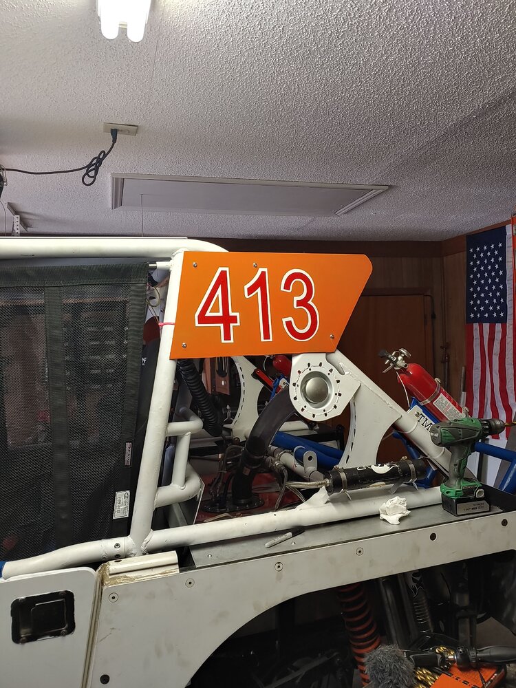

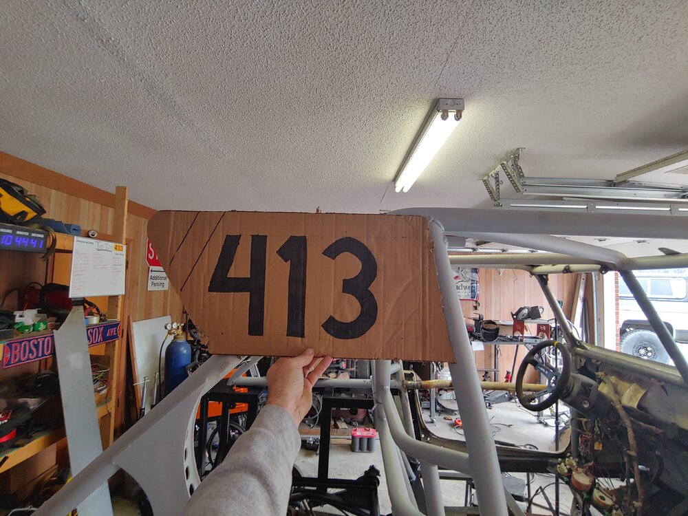

Still making good progress, got the rear all finished up over the weekend - primed, painted and almost re-assembled. Number plates are made. Also got the fuel cell and toolbox in the rear and started cleaning up and routing the wiring. Front clip is also back on (hopefully for good).
Issue with the trans output is somewhat resolved, it is going back out this week to get swapped with a 1-2 week turnaround.

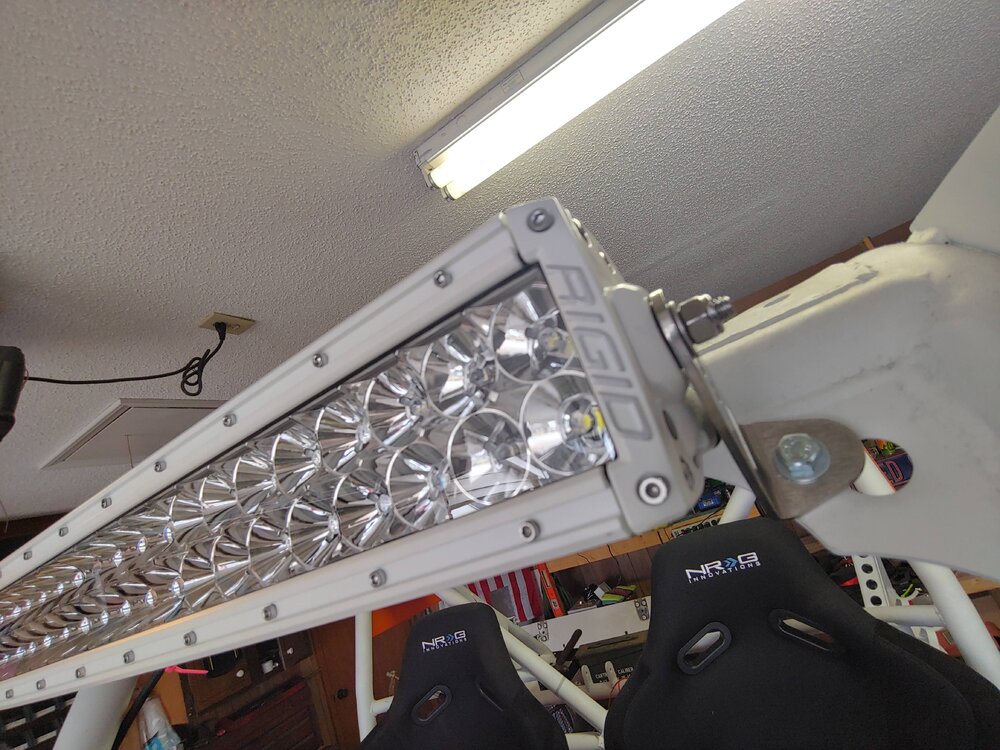

Light bar tabs

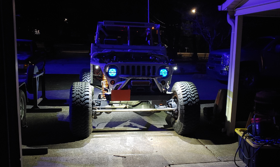

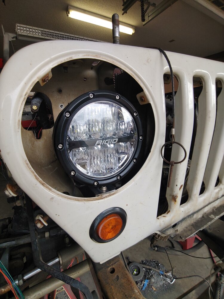

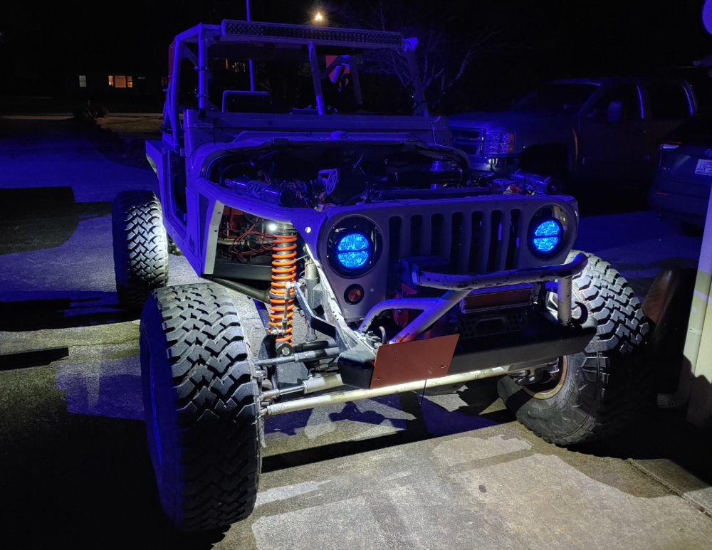

Rigid Lights came on board as a sponsor so I got a 40 in bar (the 50 was on backorder) and 2 driving lights (will get amber covers)

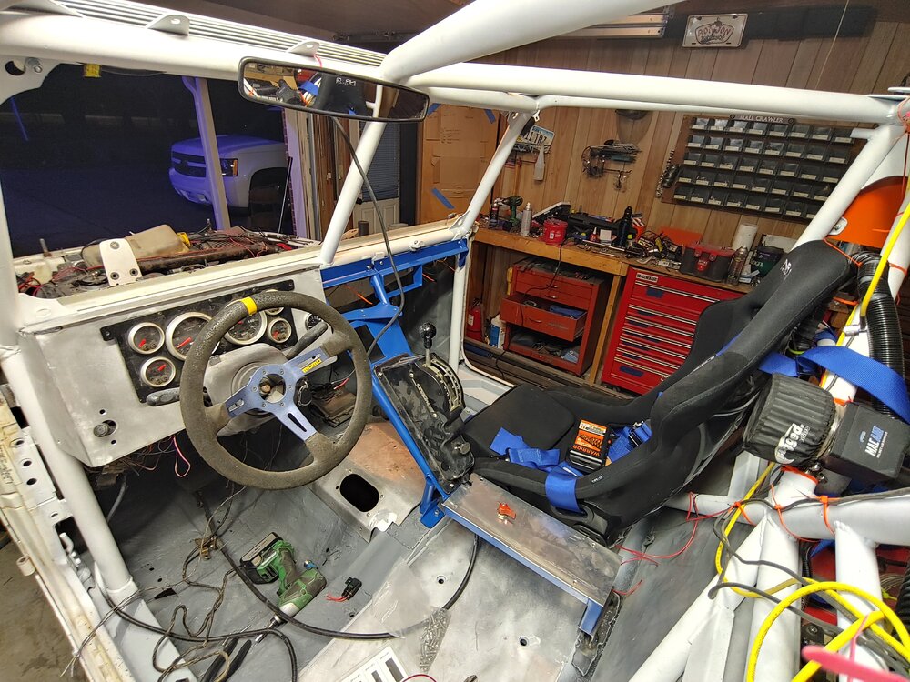

And as of last night, trans and tcase are in, all the wiring is in and working, engine cranks and trans goes through all gears, suspension is on, boatsides are skinned.

Clean up some wiring and grounds

So last night we finally had everything go smooth. Got the jeep fired up and running on the jackstands and up to temp to check for leaks
After it cooled down and we crawled all over it making sure nothing was rubbing or interfering, we put on the wheels and tires and drove it out of the shop for the first time in like 4 months

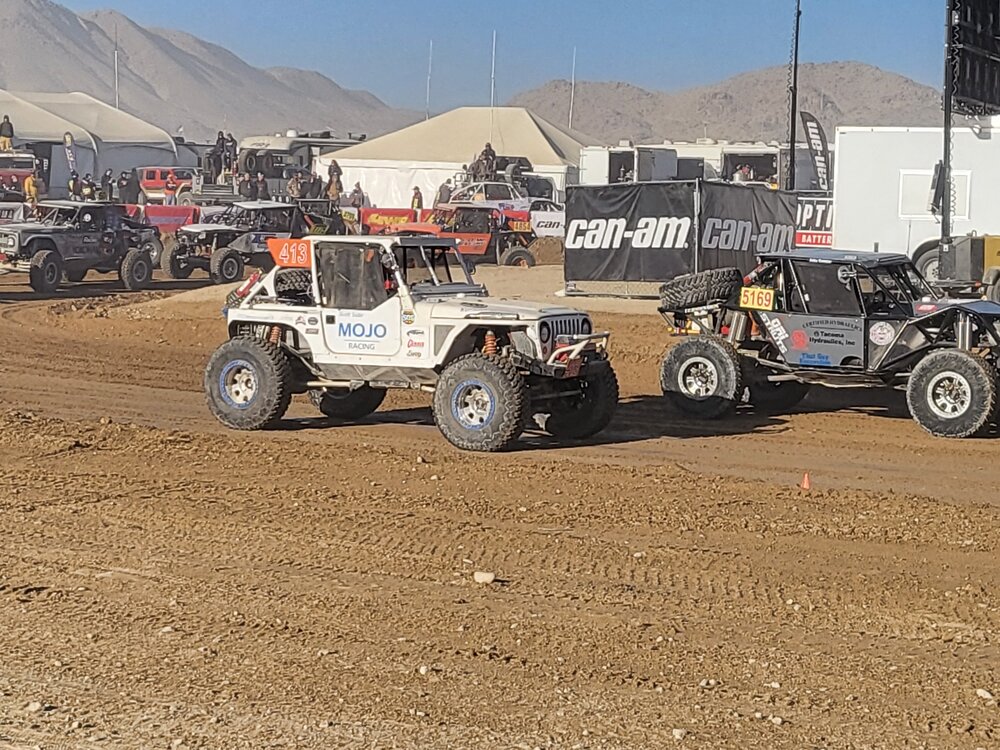

I was able to be onsite again this year for the race and was happy to see Matt cross the start line.

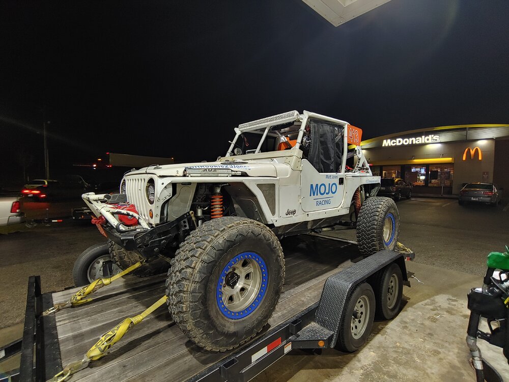

So it has been a crazy past 3 weeks for sure. The jeep missed its initial target to head out to KOH, so we had to adjust plans and drive it out ourselves. We took the extra week of time to try and focus on all the small things, as well as packing everything we thought we would need. We eventually hit the road about 8pm on Tuesday Jan 31st. The weather on 40 wasn't looking too good and Tennessee was getting hit hard with ice and snow, so we decided to take the southern route, cut down 85 to 20 and take it west.
All loaded up about to pull out of the driveway
First fuel stop
We made it all the way from NC to Dallas without any issues, and only stopping for fuel and driver swaps to take naps in the passenger seat.

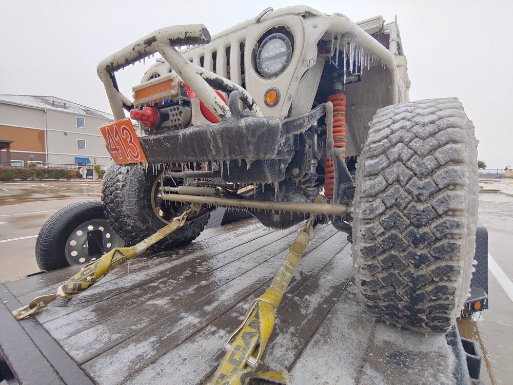

Once we hit Dallas the weather finally caught up with us. Everything was covered in ice and after the trailer tried to pass us on the highway for a second time, we decided to stop for the night and get some decent rest and food that wasn't beef jerky
Jeep once we finally got off the road. The whole thing was covered in between 1/4 and 1/2 inch of ice. Seats were frozen solid and I was worried I would have a cold, wet seat to deal with once we made it to Johnson Valley. Luckily it all thawed out and dried coming across New Mexico and Arizona
We hit the road the next morning and within 15 minutes the roads were clear again. We bombed straight through again from Dallas to Boone Road

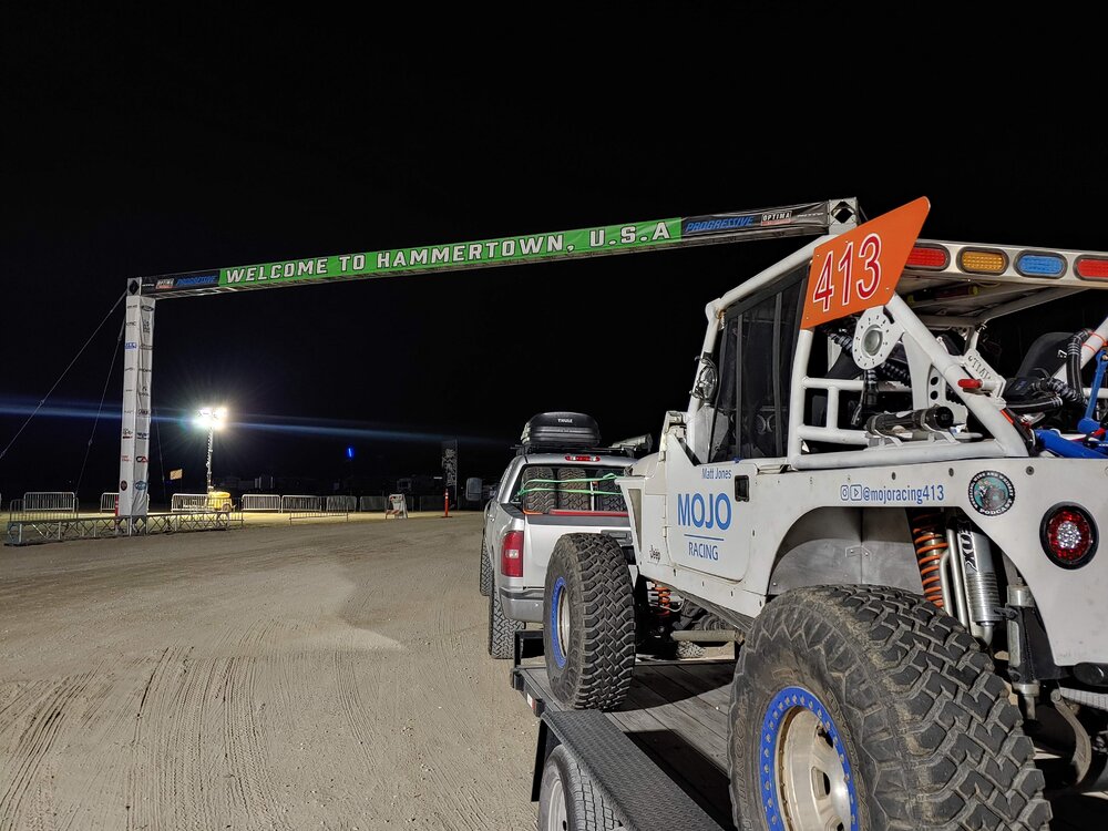

Eventually we landed on the lakebed about 4:30 in the morning on Friday February 3rd. It ended up being just over 40 hours of driving time, with no issues at all from the truck or trailer
Friday morning we unloaded everything in our spot in Hammertown, went to pick up the RV and groceries, and were back in the afternoon to start looking over the jeep ahead of our Saturday morning tech appointment

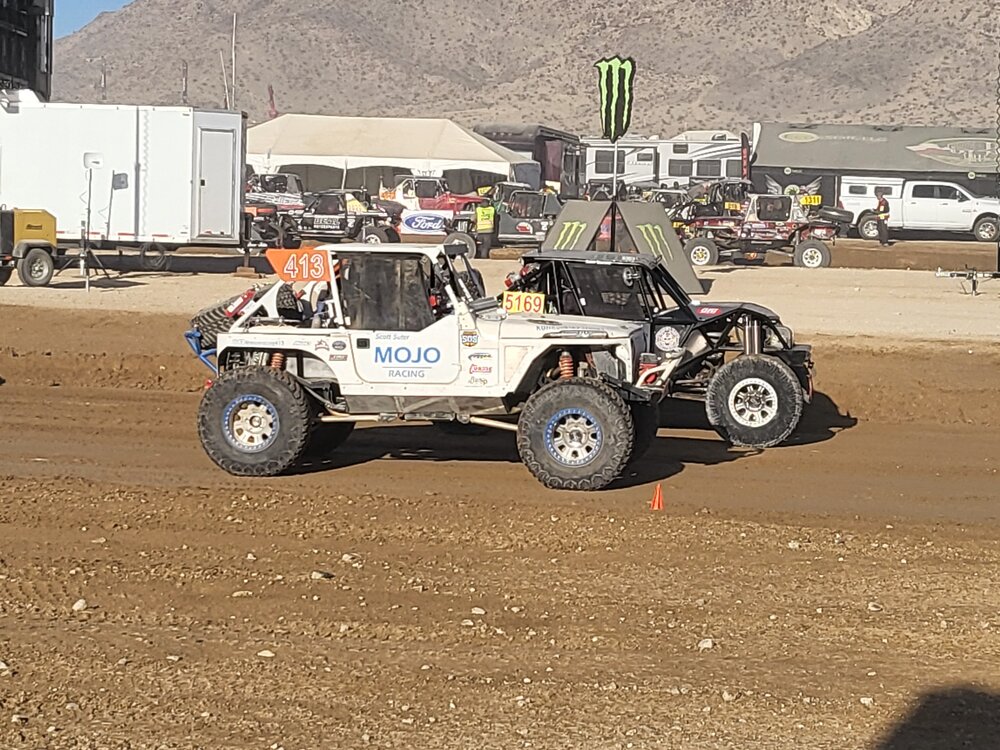

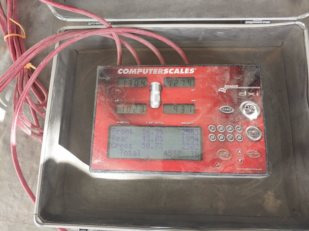

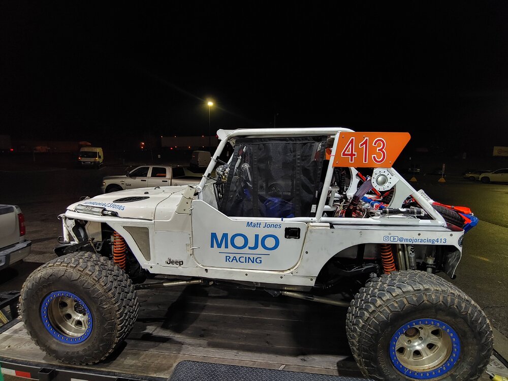

Once in tech, the car weighed in at 4537 with a full tank and no spares or tools on it. It had a pretty good front/ back and left/right balance

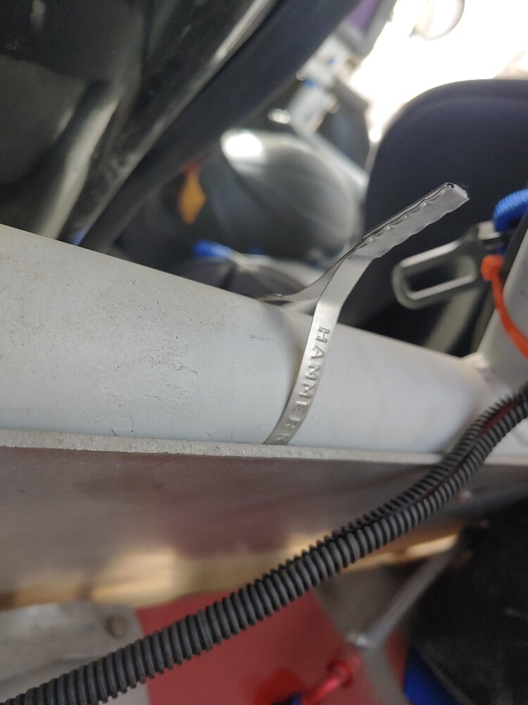

They made us change our chase bar wiring to be ignition instead of switch triggered, and zip tie the engine oil dipstick since it didn't lock. But we passed tech and got a new band on the car. We were through one more goal line for the race jeep and ready to start pre-running.
