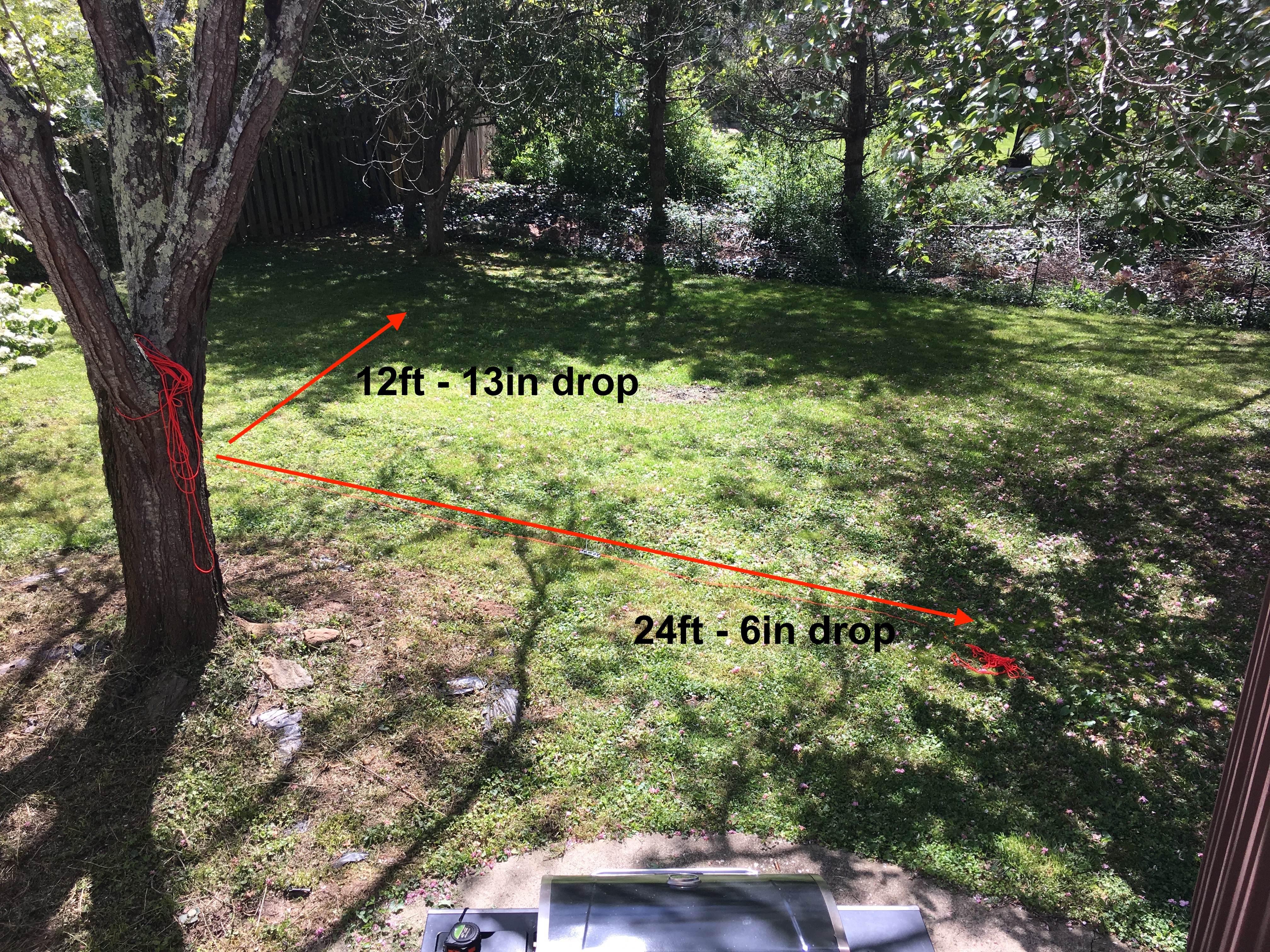

Just purchased an above ground pool for the kid this summer. Need to level this ground here. Do you recommend digging down to the level (notice tree proximity, roots) or should I build up with 4x4s as retaining walls and dirt?
9k gals of water to consider for building up

Normally I would say dig out, and use the spoils to transition around the pool. But with the tree there, the roots will be a problem. Since its just a pool, if you fill dirt and then it settles, it doesn't really hurt anything. Get a dumptruck load of sand brought in and level it out by hand in a weekend.
Did something similar where ours is.. used a tiller and dug it down 6" and filled the other side 6" and then packed it in with Jeep and then spread sand.
If I were you, I would look for a different location. The trees and stuff will make keeping a clean/nice pool a pain.
That's the location you want and have available though, the quick and easy way with no trouble would be to build up. Get some 2x6 or something similar and bury them a little bit and make a box (use land scape timbers if you want just secure them to the ground, neither is truly necessary but helps). Make sure they're level and line up square. Make square box. Fill with sand, level out. Setup pool, make sure the bottom is stretched out and how you want before you fill with water. When satisfied, fill with water/enjoy.
Edit: 4x4s will work. Drill a hole, drive stake/rebar/whatever you want, through them into the ground.

9k# mini-ex? hey it may take a little while to bust thru all those roots, but with the blade, you can cut/fill to a net zero. (may kill the trees, may not)
Access to a José or hose B? Still gonna have root problems.
I vote build up the backside with 4x4's and a load of sand

Since it wasn't mentioned, You dig those roots & you Kill the tree. Maybe even the pool sitting On the roots will kill it.[root compression]. And it's So much easier to fill the low area, than to dig out!
