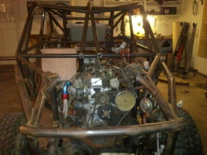

Lil Digger Truck - ECORS Stock Racer Build

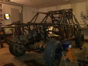

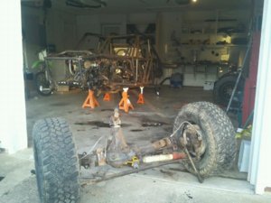

U-Bolt Flip Kit, Good Springs, Upgraded Shackles, and Big greasable shackle Bolts.... Lets hope these don't bend:lol:

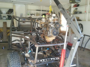

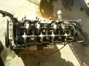

It turns over and the valves are in place....:rolleyes:
Off to the motor builder:flipoff2:

Just bought some Eagle Chromoly H-Beam connecting rods for Digger's 22R. Got a new Crank Shaft on the way, and when it gets to the race shop, their going to balance it to 11,000 RPMS.... I'm having trouble finding a good Forged Piston and Ring Kit for an 85 motor, Any Help?
