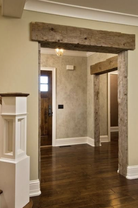

I’m buying the structural lumber from them (load bearing walls, floor joists, etc). But I’ll mill all the interior wall 2x4 and 2x6 lumber. Should save me quite a bit of $. I’m also going to mill the headers for interior walls to be oversized and out of white oak beams and also use them as an architectural detail above the door openings. :D
Kind of like this but real, not faux. And colors that are more in style today.
