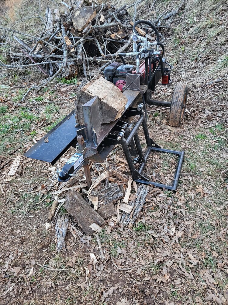

Did you just use the existing pump and hydraulics and add a cylinder and valve for the lift? I’ve been thinking about doing that for mine. And adding a big table that lets the wood just slide down and either into a pile, the tractor bucket, trailer, etc.I know some of you folks were talking about adding a table to your splitter. This is what I did on mine when I added the log lift. It makes it much more user friendly. View attachment 406543

I kept everything but the valve. I replaced the valve with a 2 spool valve. I went with a cheap China valve, so I lost the return detent. Prince makes a valve that has a detent on one spool but not the other, that would be perfect for this application, but the china valve was 80 bucks, the prince valve is about 350 and I'm a cheapskate.Did you just use the existing pump and hydraulics and add a cylinder and valve for the lift? I’ve been thinking about doing that for mine. And adding a big table that lets the wood just slide down and either into a pile, the tractor bucket, trailer, etc.
