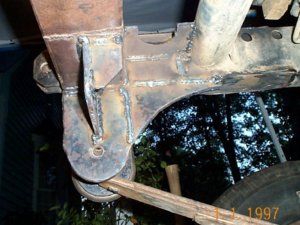

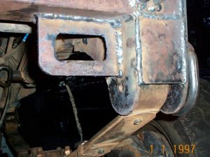

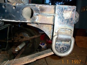

i would plate up those front spring hangars, they are going to get bent all to hell if you dont

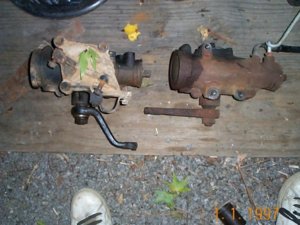

Jeep Box on Left, Astro Van Box on Right

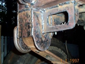

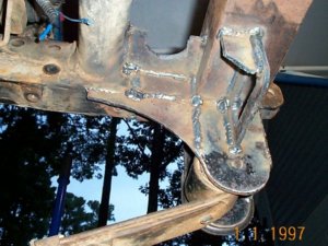

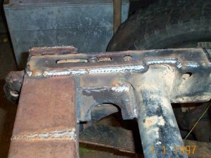

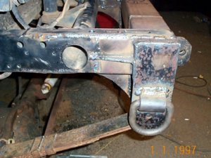

What part of the front spring hangers are you referring to...?
the tabs that hang down that the springs are bolted to. a plate across the front to tie them together will help, but i have seen/had mine bend running them the way yours are. its an easy fix that will keep them from getting bent into the spring later on when you run into rocks and stuff
sweet i have an astro box as well...
