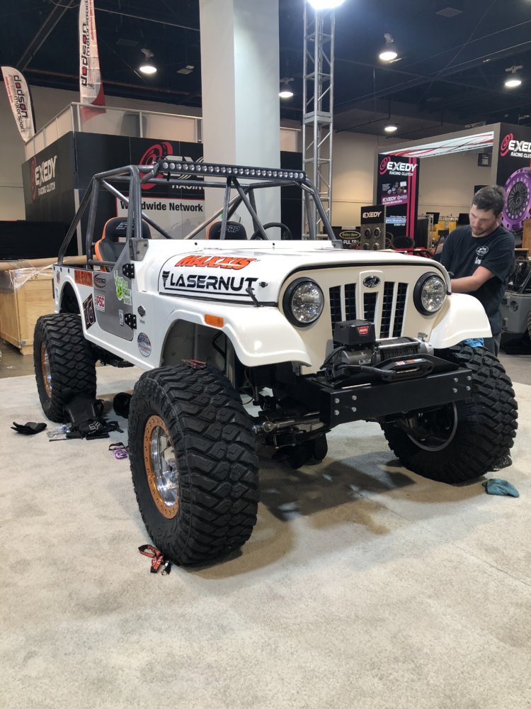

JH built one for the 4600 race at KOH.
These should be a decent platform for some rec wheelin
I will be racing against Jesse at KOH. He sure did put some nice parts on it
Jesse was actually sleeping under this thing when I took the photo. At first I thought someone was working on it :lol:
Portals with 4.10 geared Toyota 8” centers. Stock leaf springs and some high dollar resi shocks. It should be plenty capable in the rocks. I’ll just be surprised to see if the drivetrain holds up.
I think his crutch (and an advantage, at times, as well) is the small diesel he has to run.
I read a post online that says you can get 150hp out of that motor with only a few mods. I think he will surprise a lot of people.
I love this build & I wish I could build portals :( Portals with SUA leaves and good shocks, a good cage, good rubber. Simplicity. Might only go 50mph flat out, but it will probably feel like 100.

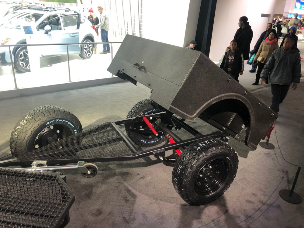

Check out this one off trailer too, they built it for the show from rear of their tub and custom frame, and hydra lift.
